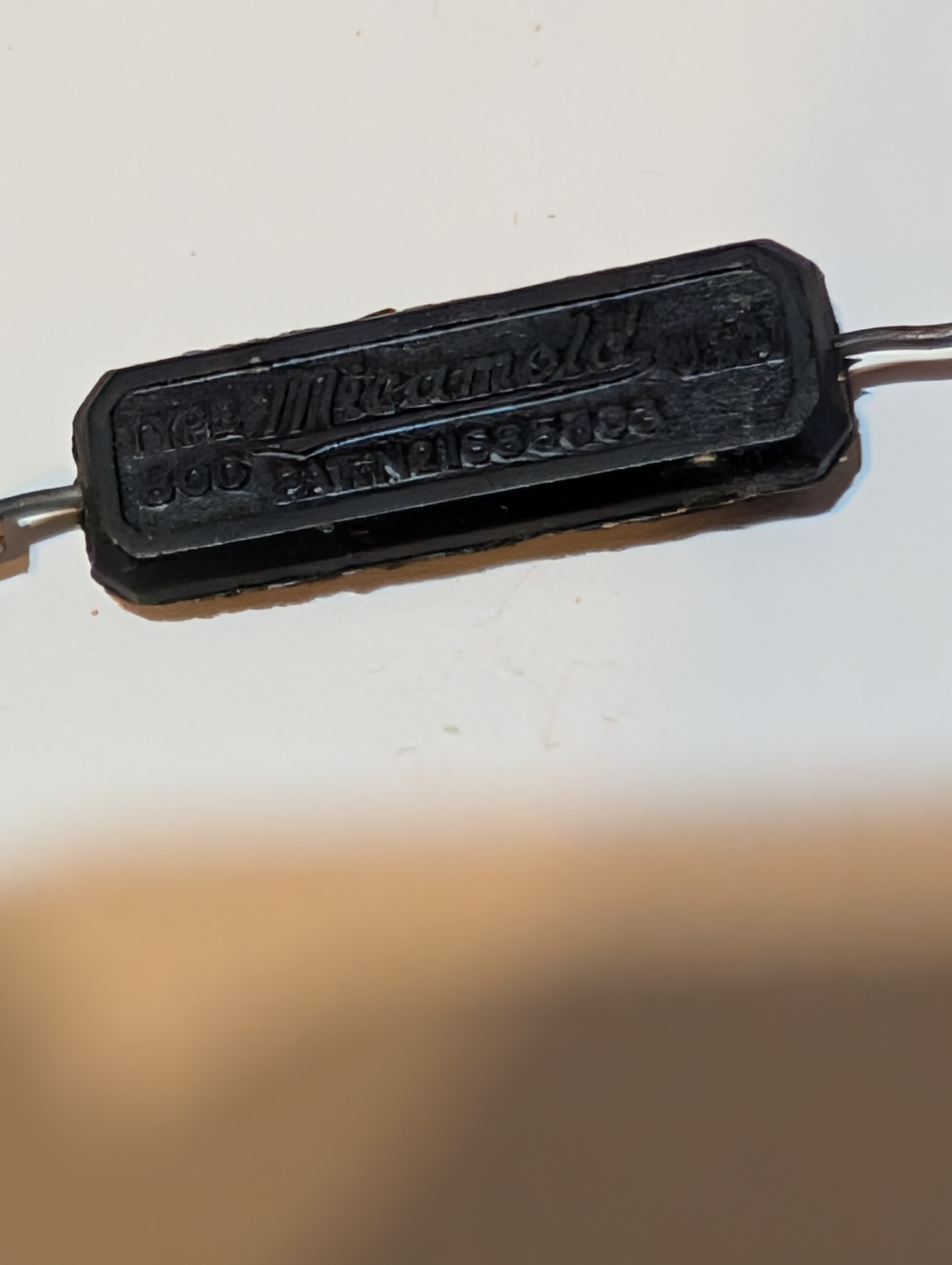

>>>Bear in mind that some molded capacitors are not mica capacitors. If they are labeled "Micamold" they are may be not mica, but might actually be paper dielectric caps...
or resistors

No, I mean Micamold resistors. Look like capacitors, but are resistors.

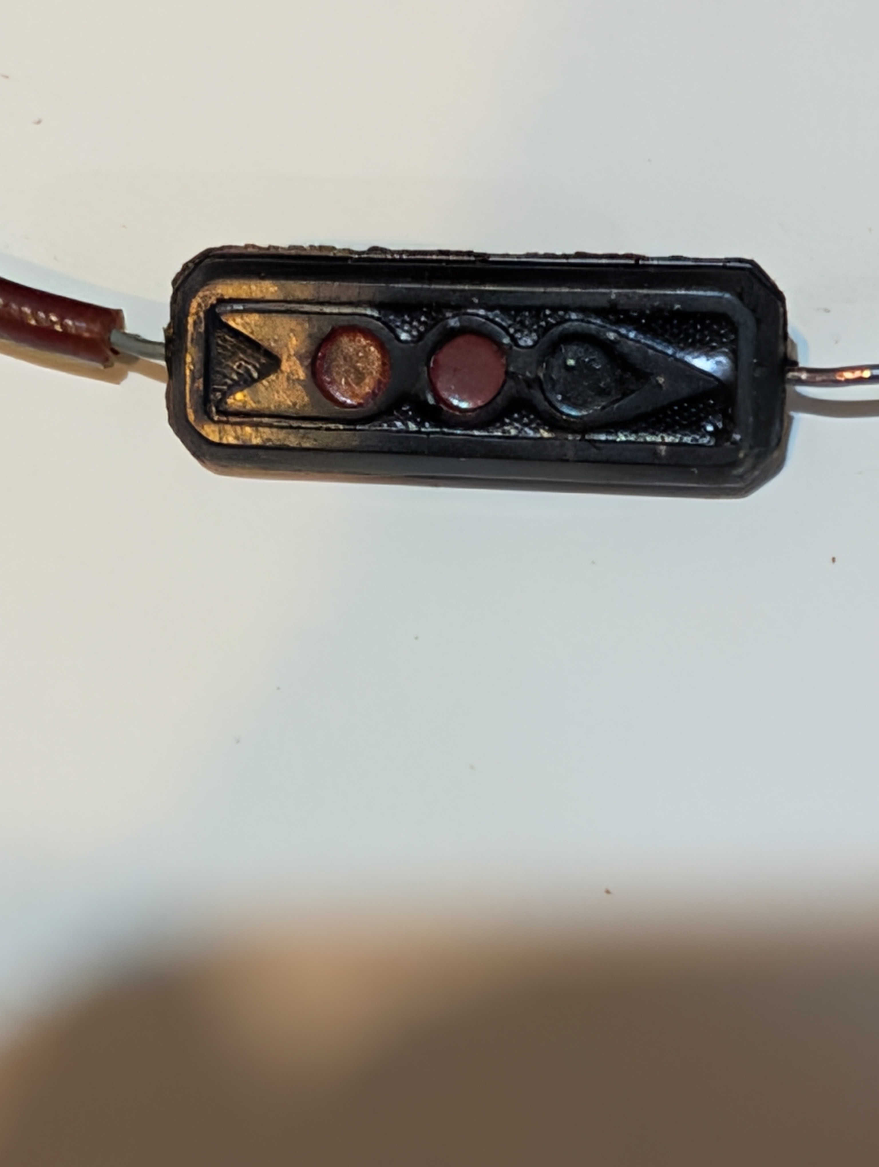

Feast yer eyes. I actually says "Micamold".
This is a wirewound 2W 22 Ohms resistor, the dropping one for the selenium rectifier in Zenith 7H920 I have recently finished.
