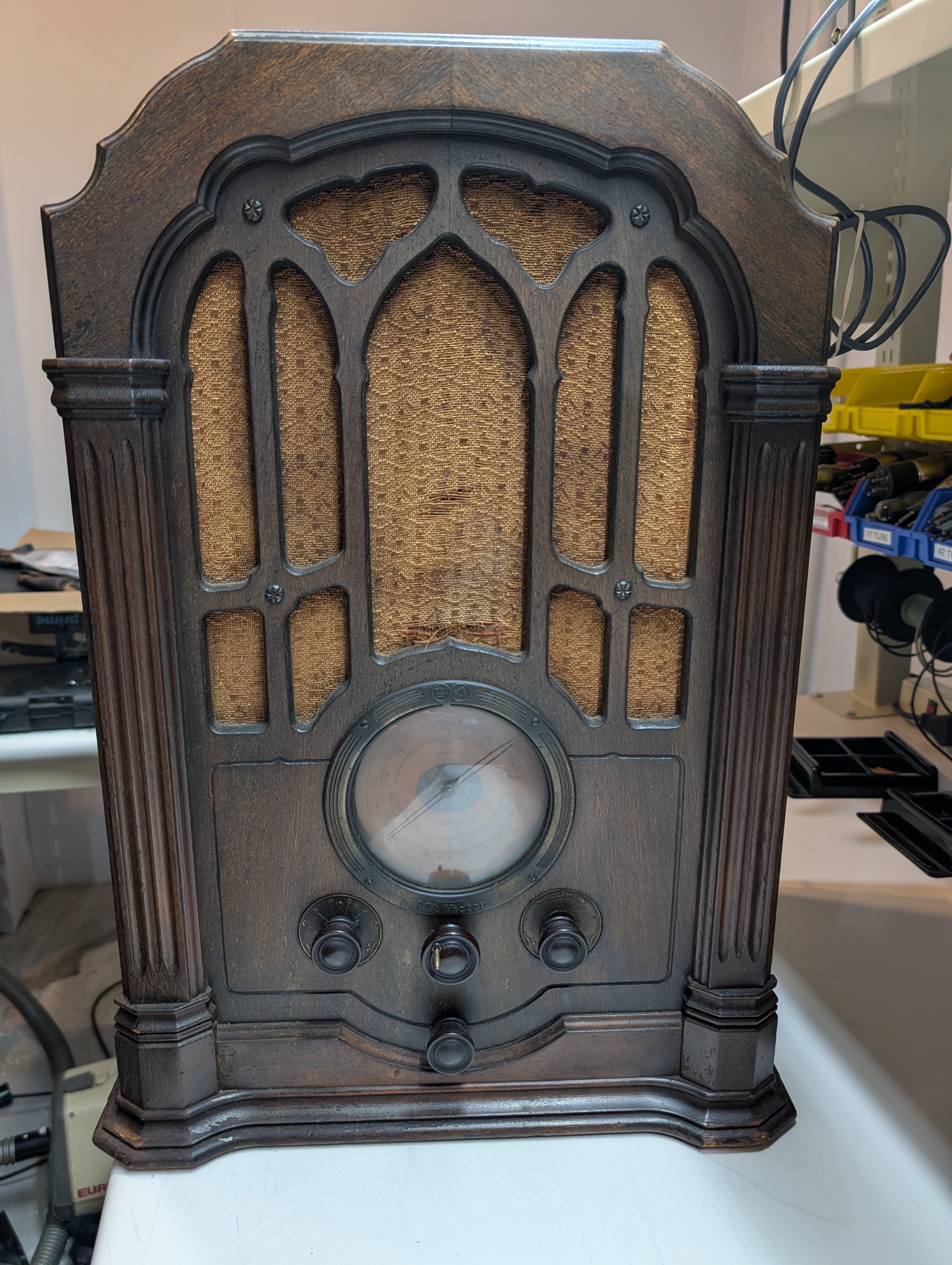

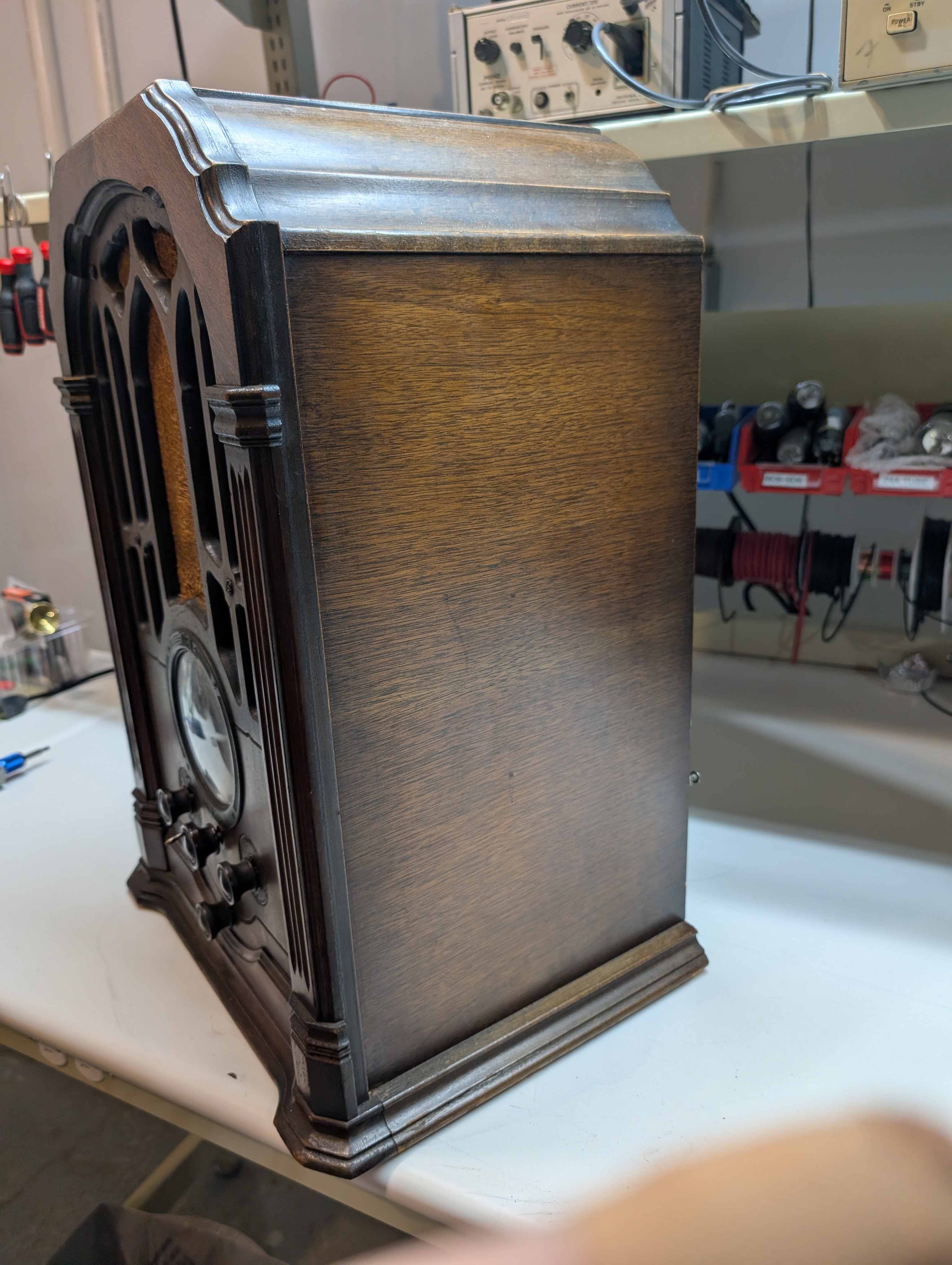

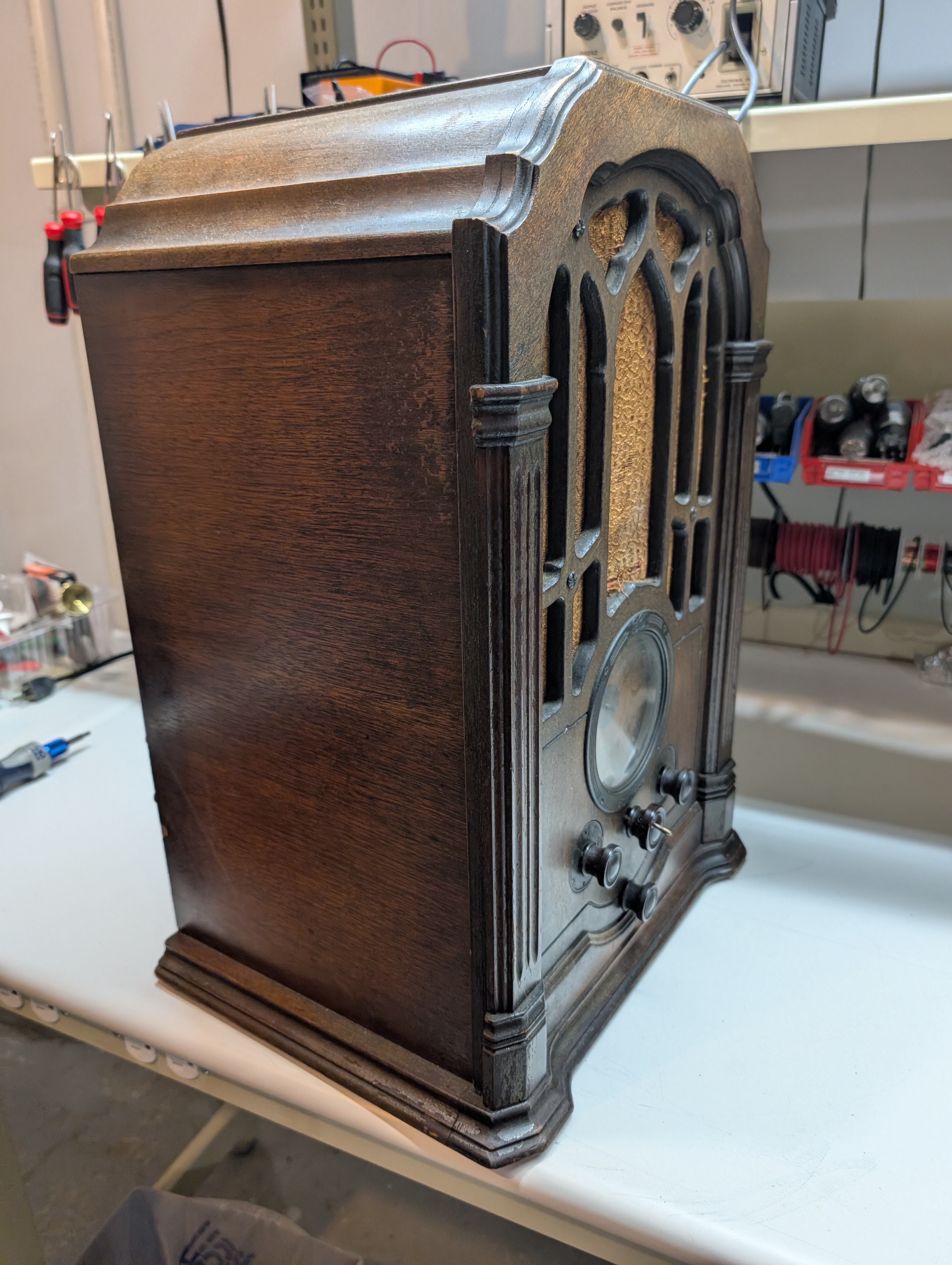

This one I bought Sep 2025 in Kutztown.
I have two of them, one bought a few years ago and the cabinet restored by Fred Taylor. It need some things, and this one is whole.
Even the knobs are original.

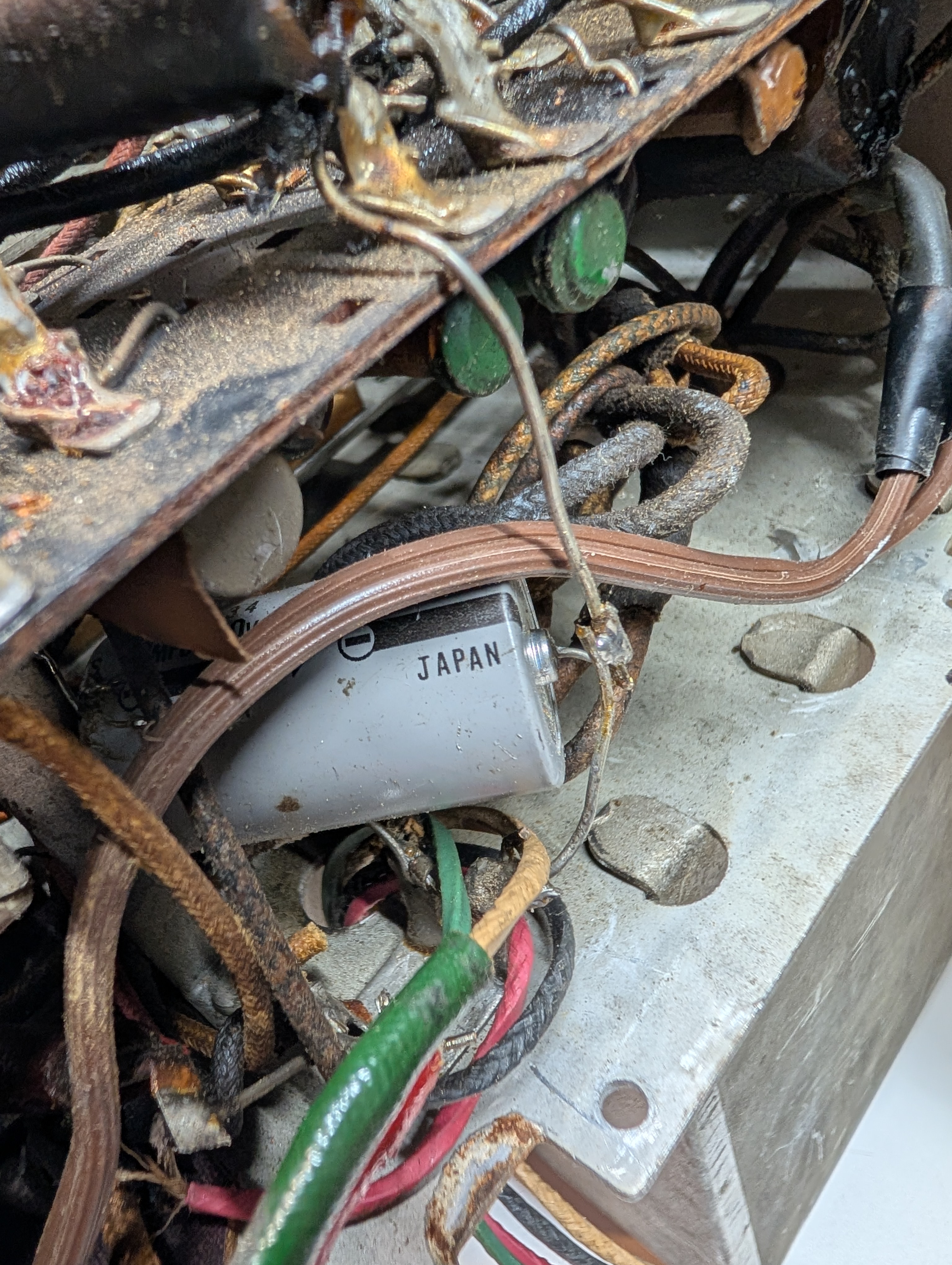

This radio was repaired, to which this and another Japanese cap are the evidence. Or the earlier repairs with some black beauties.

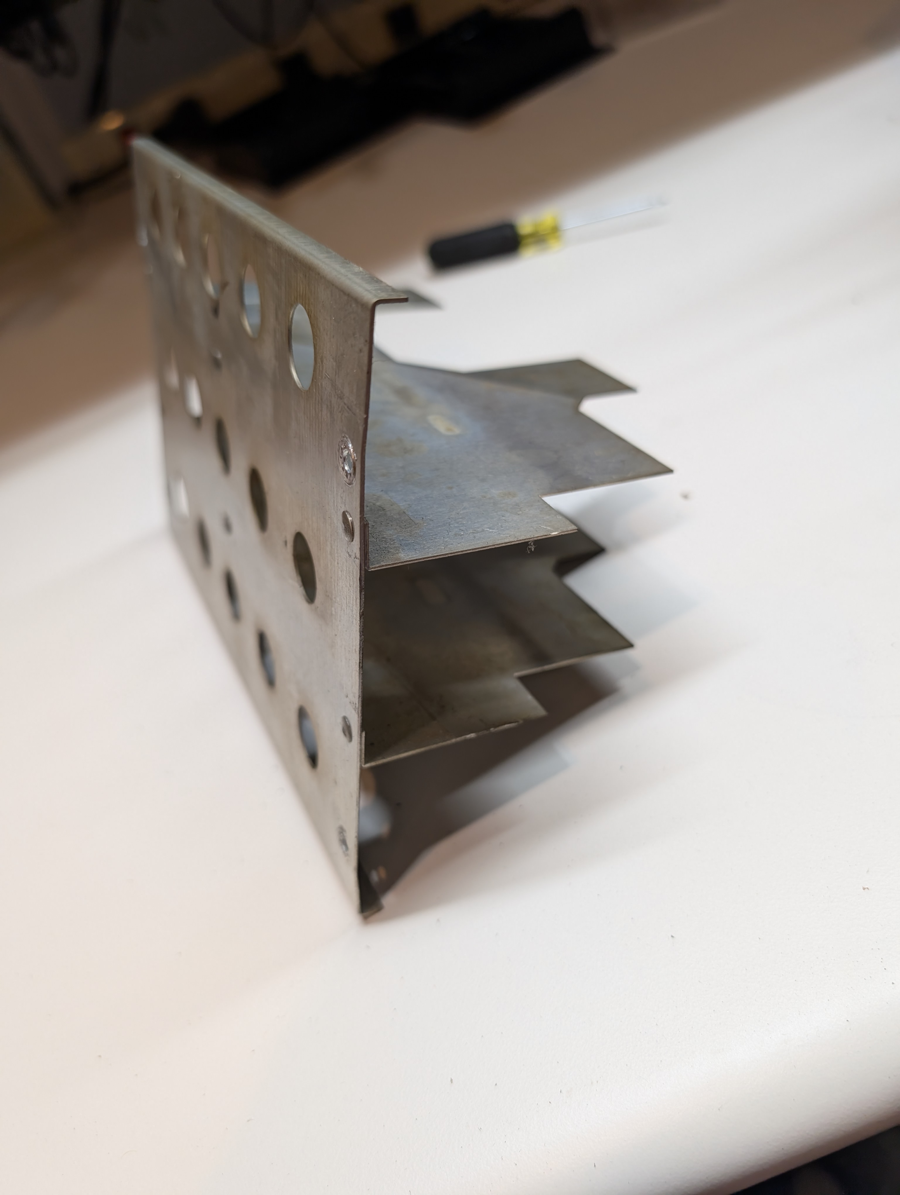

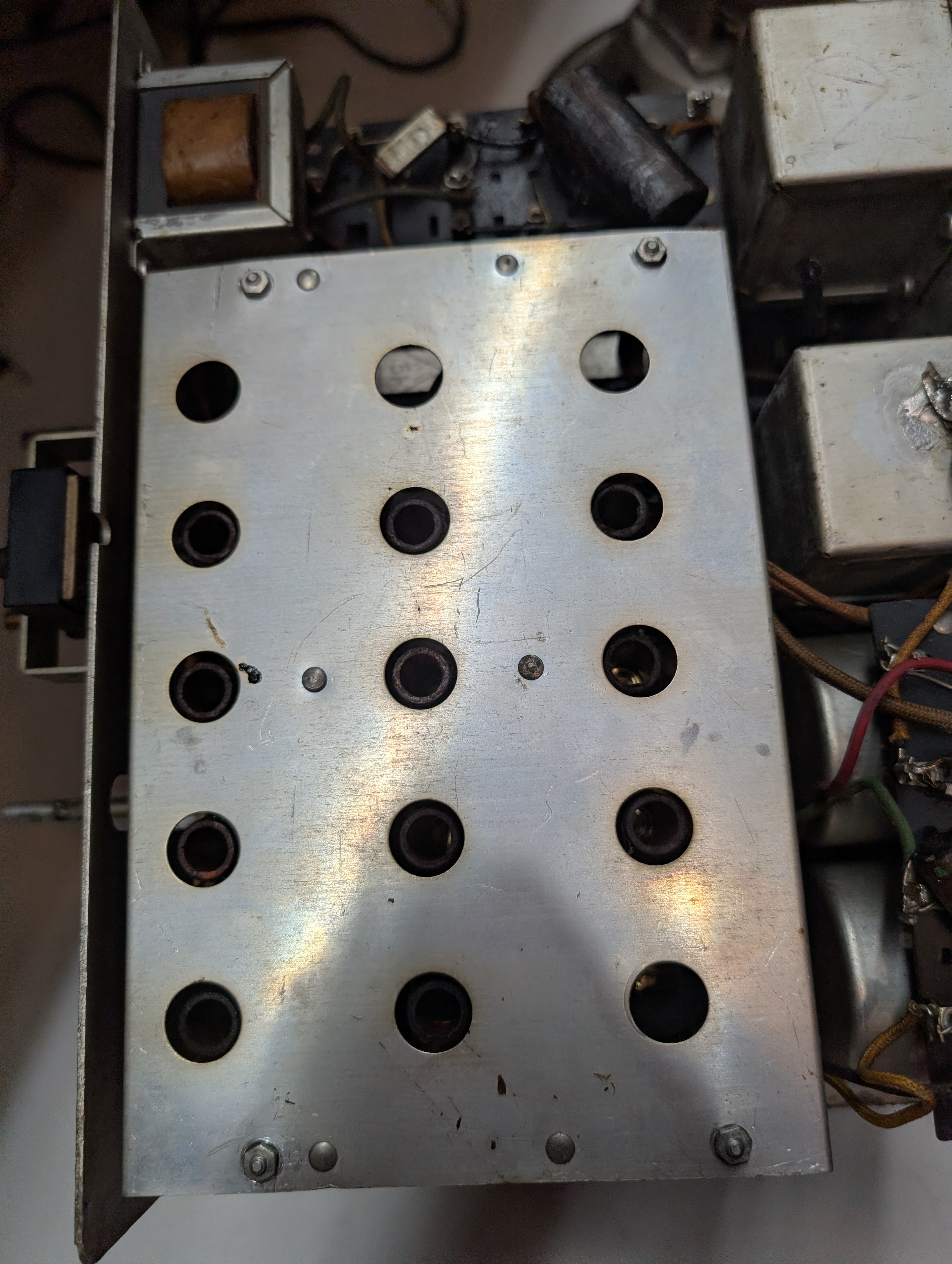

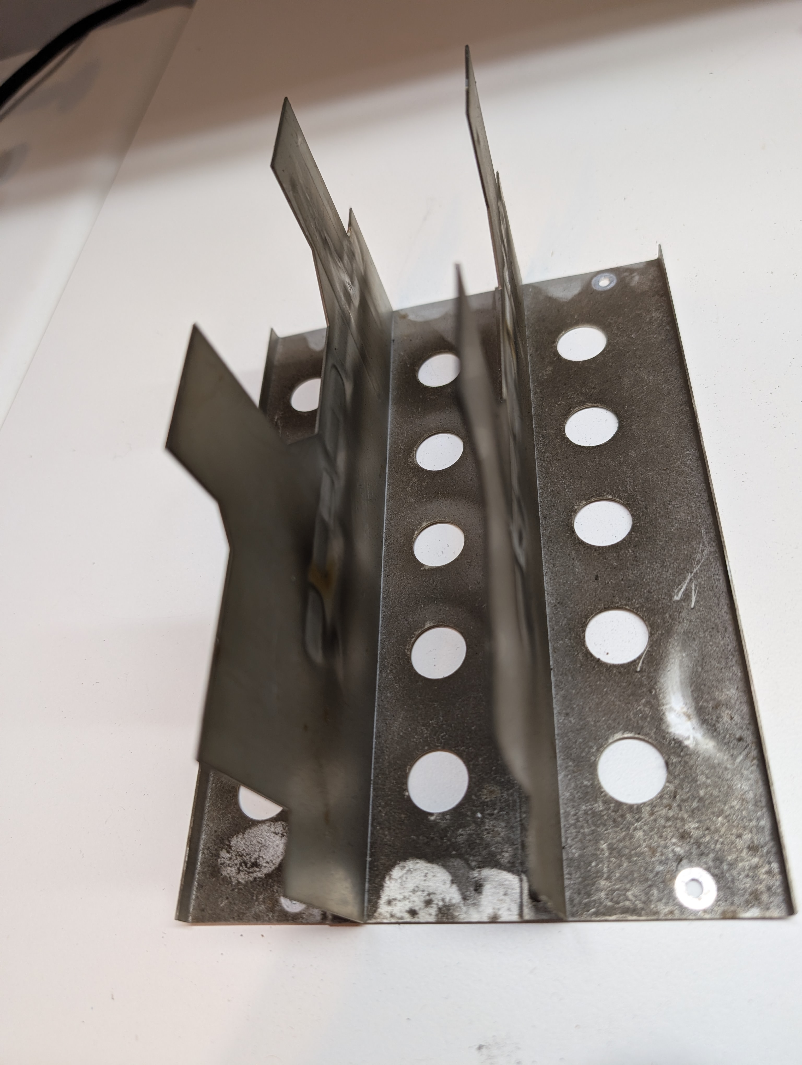

The other radio is missing the RF cover.
I thought of manufacturing one, but it is a little involved, as I had realized after removing it from this radio.

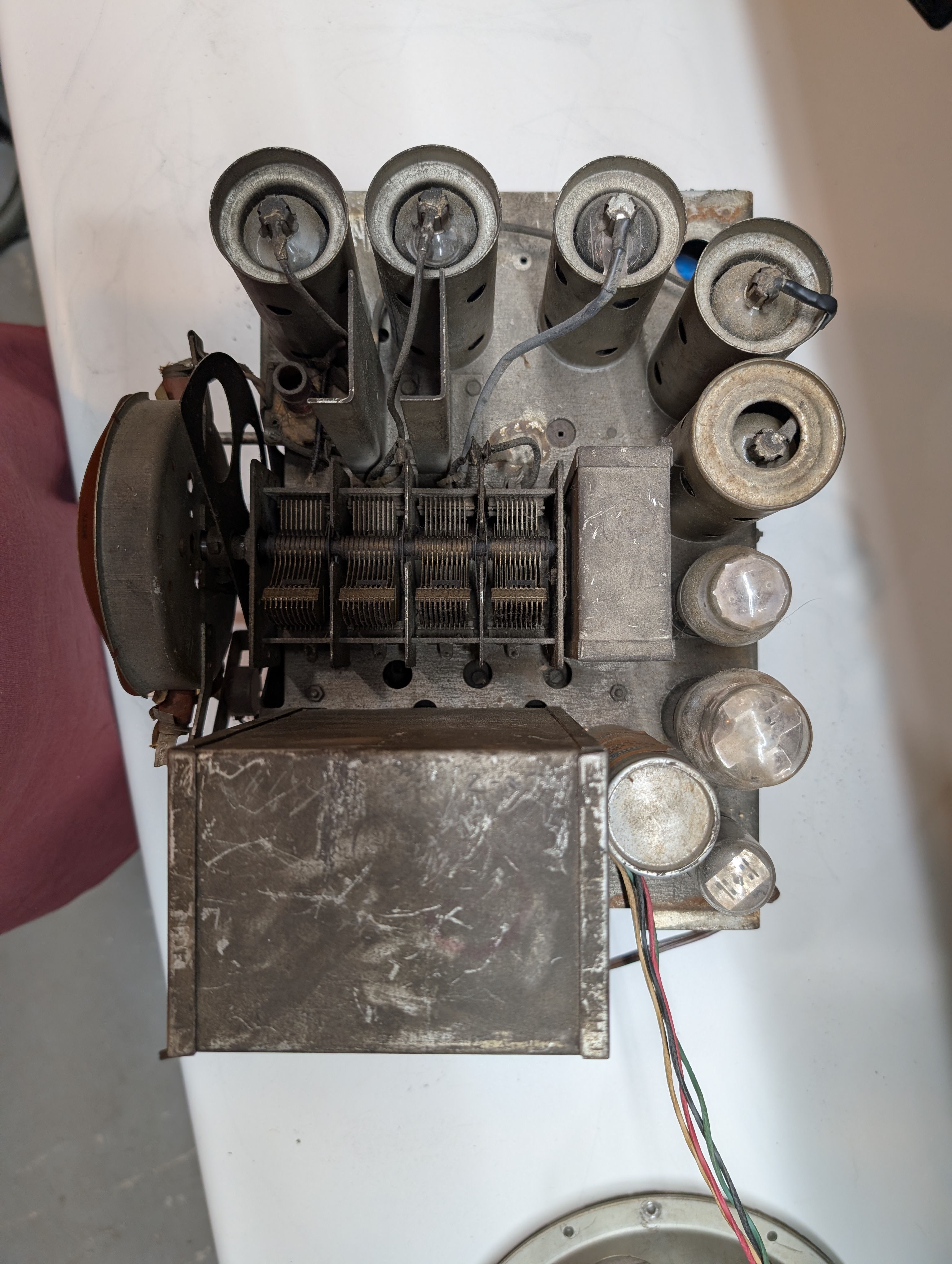

As usual, the huge cap block. I thhink it is steel, and, as the last time, I simply track the wires and replace the cap at the point of destination. Removing this block was nearly impossible in R73. Let alone opening it.
I suspect, this will be the case also.

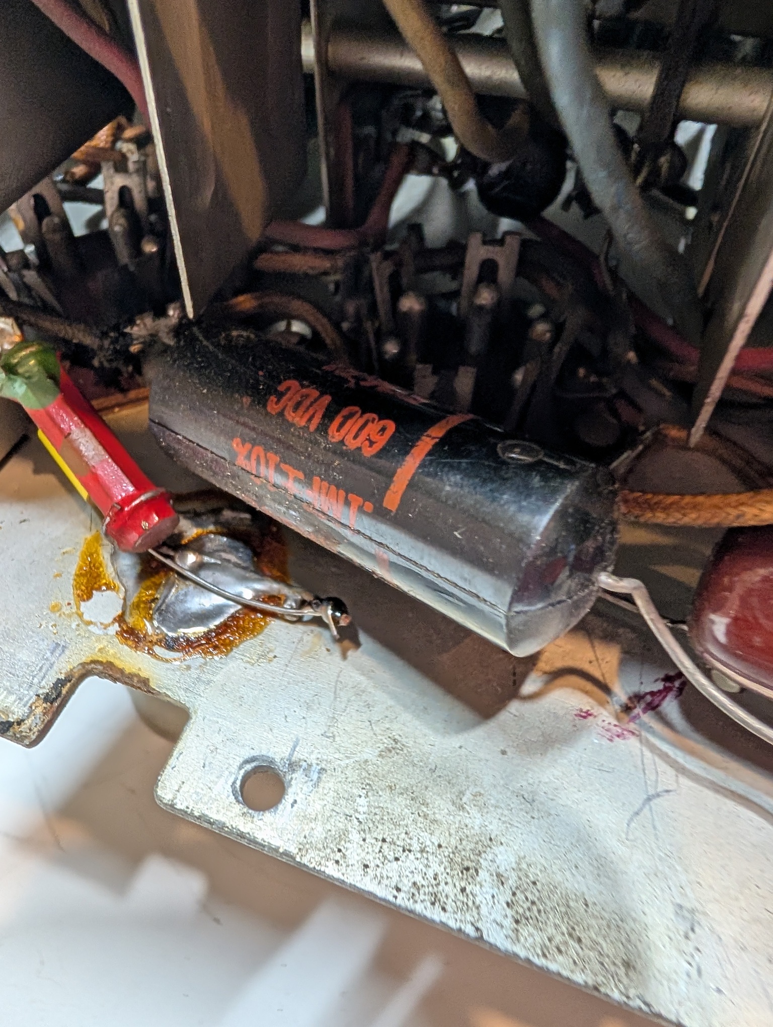

The tubular caps are ugly and have uncovered lumpy black tar at the sides.
Something oozed on the bottom cover, and I was not sure it was  not a speck of mouse poop, but then it was very tarry, and only was removed by min spirits, so it is tar.

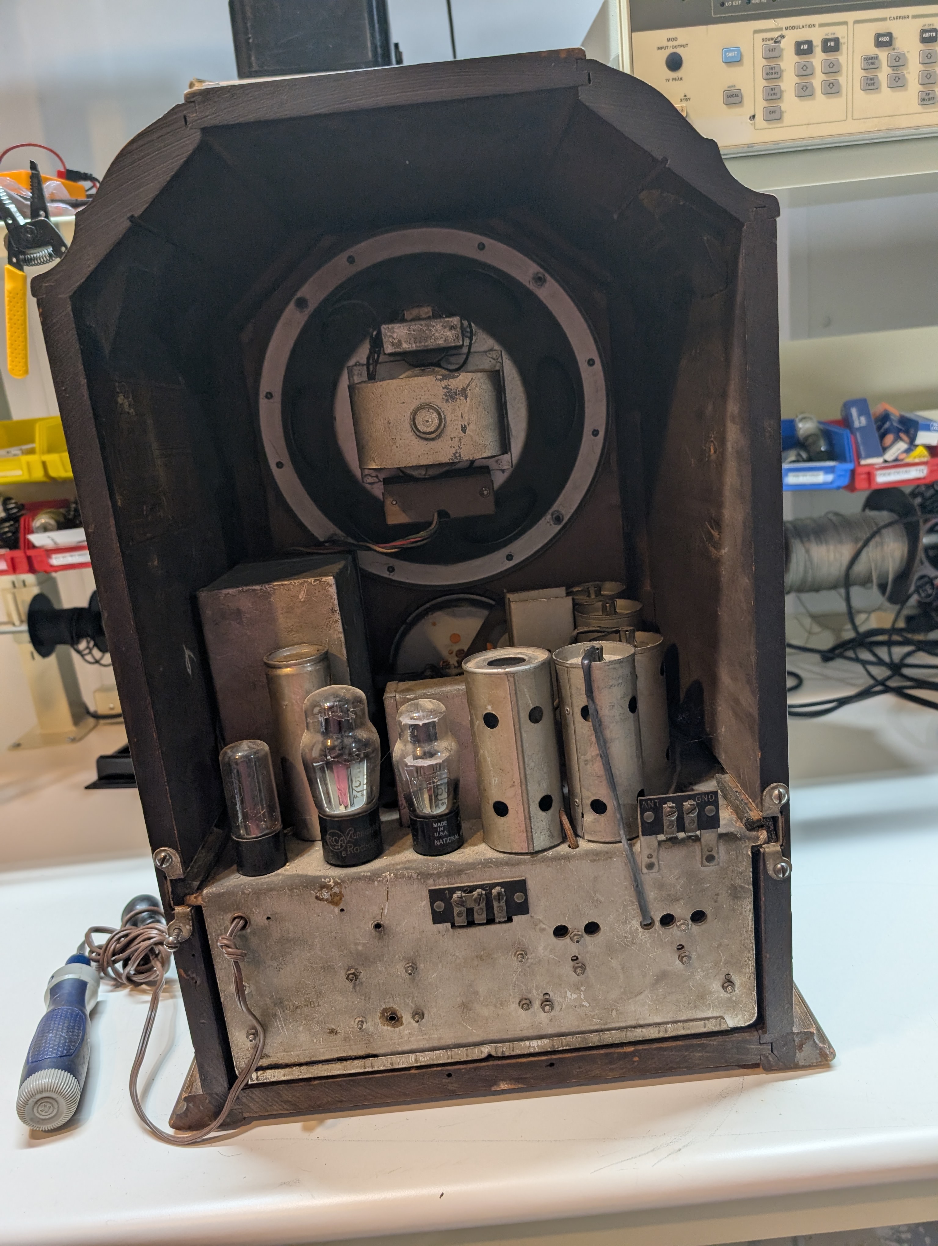

This is the chassis.

Assuming you can't find another RF shield assembly from a parts chassis (the same chassis was also used in consoles) I don't think it would be impossible to make as you at least have one or more originals to use as a pattern. I would try making patterns from cardboard, or stiff plastic first, but I think that what you mainly need is someone with a brake to bend up the partitions, though using a vice and angle iron will work. Is the RF shield steel or aluminum? In the pictures the bottom portion looks like aluminum. I think that the chassis rails may be as the R7 Nipperette/G.E S-22 chassis, though the length may be different, I picked up some steel channel somewhere to make some for my J-82, but never got any further then that, I have the ones from my G.E S-42A to use as a pattern, if I can find the channel again.
I don't have one of these sets but I have one of it's younger siblings, the M-81, it also has eight tubes, but doesn't have the extra RF amplifier stage, however I don't think it's much easier to work on, lots of rock hard rubber/gutta percha covered wire, and it has a dead audio interstage transformer too, but it's a more normal one. They are nice sets, but the parts quality suffered with age, almost all of the resistors like to drift.
All parts are steel.
Yes, I can possibly to it. It is 3 parts. And I do not think I have to bend the edges of the main part. The parts can be riveted together, which is what they are.
Of course, aluminum will develop the oxide and become less of a shield over time, but if riveted well, maybe it is not much of a problem. Or at least during what I have left of my lifetime.
I actually think, the vertical parts are more important as they separate the partitions from influencing each other, whereas the horizontal one is simply the carrier of them, as there is nothing that needs to be shielded from the underneath space.
And, yes, I possess the skills and can use our workshop to drill the holes (I do not have a good drill press at home), it's just I am not a big fan of this type of jobs. Oh well, first I will have to deal with that first radio. And maybe the GE. Then I will take on the last 140.
