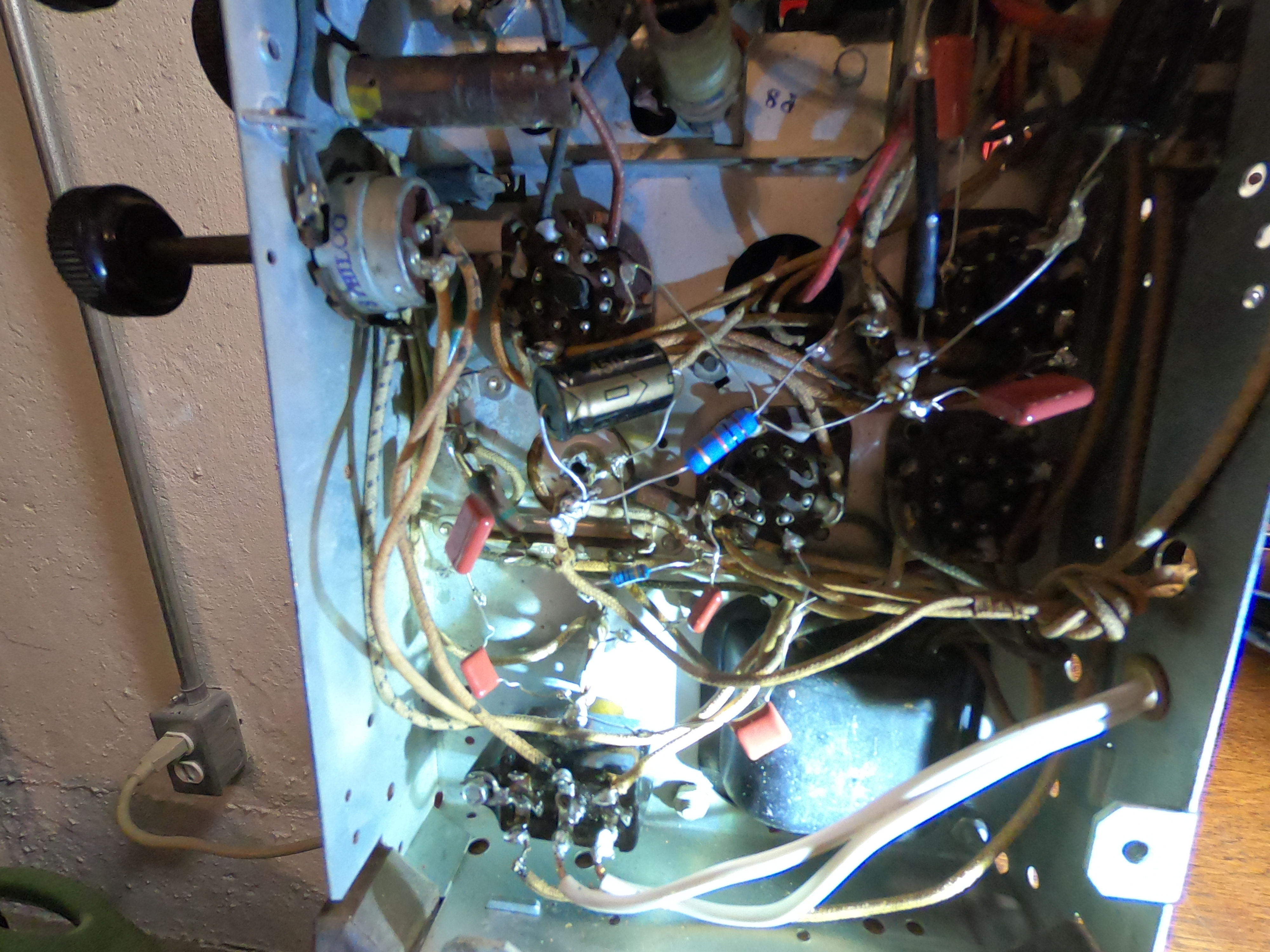

I flipped the chassis over and the 10K resistor that I replaced was really hot.
Quick question. Is the terminal supposed to be floating in space? As I mentioned earlier the terminal that was coming out of the electro cap I cut off to use as a terminal for the positive end of the electrolytic. Is it supposed to be touching the old metal cap still or no?
Sorry if the image is blurry.
Thanks
The speaker was having this issue before I had replaced the 25uf where if I left the chassis flat like normal the speaker would make the crackling noise it is now but if I were to put it up-right it would sound normal again. but after I replaced the 25uf it no longer went back to normal at any orientation.
Also I removed all the tubes and left the output in and there was crackling still. Icon_sad
As long as the new filter cap isn't connected across the old one, or the old one has been gutted, there should not be an issue. I'm not sure how it could be making crackling noises with the tubes removed, I take it that you mean the cracking is coming from somewhere other then out of the speaker? It could be arcing, or it could be a resistor breaking down.
