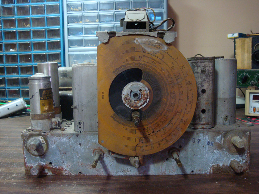

Anyway...here is how the chassis looked originally.
[Image: http://www.philcoradio.com/images/phorum/655B/002.jpg]

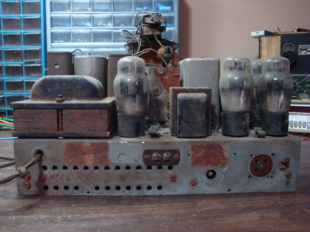

Back view:
[Image: http://www.philcoradio.com/images/phorum/655B/005.jpg]

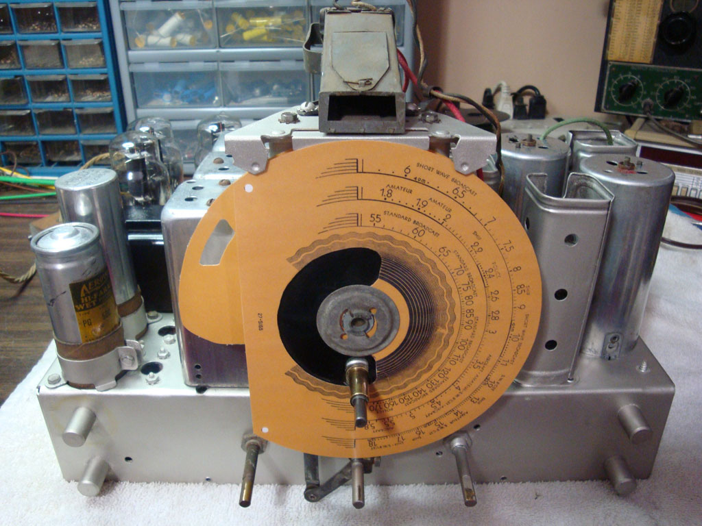

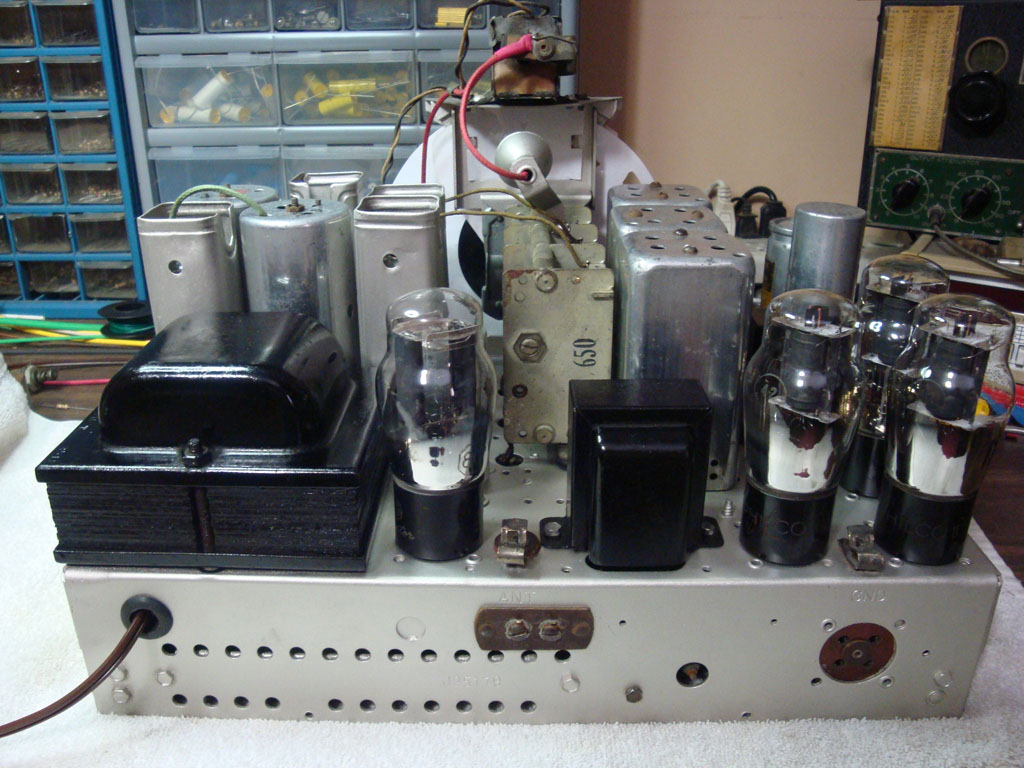

I started working on this chassis over a week ago, in between summer college classes. Today, I finished it up:
[Image: http://www.philcoradio.com/images/phorum/655B/060.jpg]
[Image: http://www.philcoradio.com/images/phorum/655B/062.jpg]
Yes, the tuning condenser was replaced with one from a junk 650. Both the 650 and 655 use the same tuning condenser (they even have the same part number). The original tuning condenser was badly rusted and had rubbing plates. It was easier to just replace it.

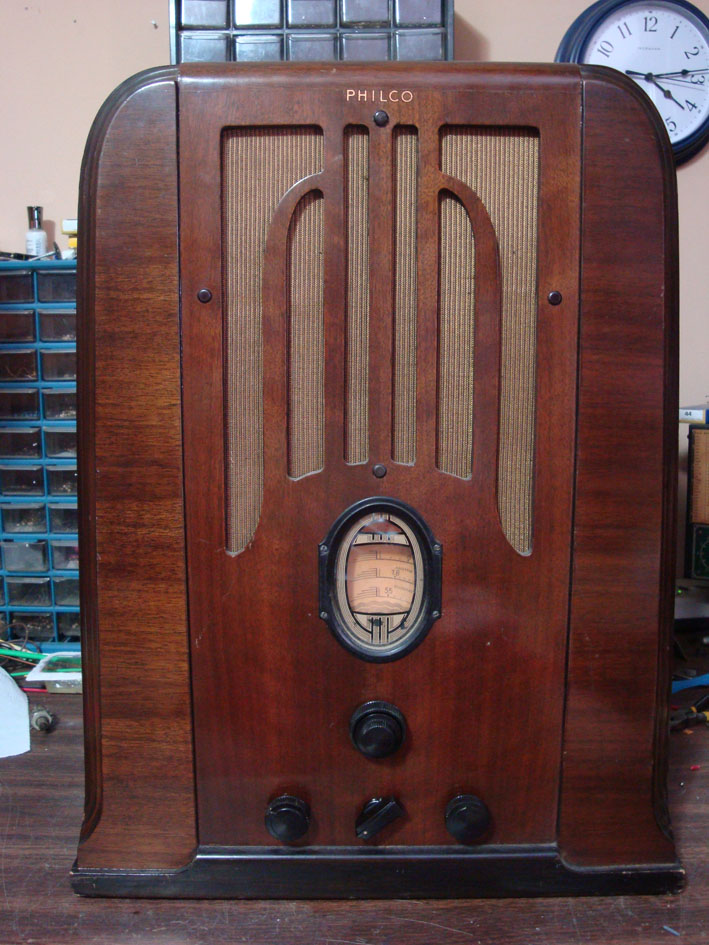

Once the chassis was done, it went into the 645B cabinet. In case you're wondering, the 645B and 655B cabinets are identical.
[Image: http://www.philcoradio.com/images/phorum/655B/076.jpg]

What sort of paint did you use on that chassis? It doesn't look like silver or aluminum paint.

Your Chassie look beautiful! are you painting them? They, I believe , where originally catium plated, I use a cheap chrome paint to replace the catium plating that was originally done on the auto radio cases I restore, is this what your using?
Thanks, everyone!
Arran and Bill: I use Krylon Satin Nickel spray paint. It looks more authentic than that gaudy aluminum paint some people use. And, an additional benefit: It is conductive, which is a good thing, especially for tube shields; it helps ensure that the tube shields will still function properly.
Posts: 160
Threads: 36
Joined: Jan 2006
I'm going to try this paint on my 37-610 I'm restoring , for the black you use on your power transformer, do you use a engine paint?
For power transformers, filter chokes, etc., most of the time I use Krylon Satin Black. For the 655, noticing the 655's interstage transformer had the remants of gloss black paint, I had some leftover Dupli-Color gloss black auto touch-up spray paint and used this for the power transformer, filter choke and interstage transformer.
I usually run any radio I am playing for hours at a time through a bucking transformer setup, dropping the line voltage to 110 so the power transformer only gets lukewarm. I would think that if you need high temperature engine paint designed to withstand several hundred degrees Fahrenheit, that your power transformer is running too hot!

Ron Ramirez Wrote:Thanks, everyone!
I'm guilty of that, I used to use it because there wasn't anything else, just silver which is even more gaudy then aluminum. I think that when they were new the plating on some chassis was almost like aluminum paint in terms of brightness, but 60-70 years on it doesn't look quite right to be original. If you really want to go to town, and dismantle the whole chassis, you can get a chassis replated in cadmium, it isn't nearly as expensive as chrome since there is little to no polishing involved. On most sets it isn't worth the effort, but if you had something rare or high end that you wanted to bring back it could be worth it.
