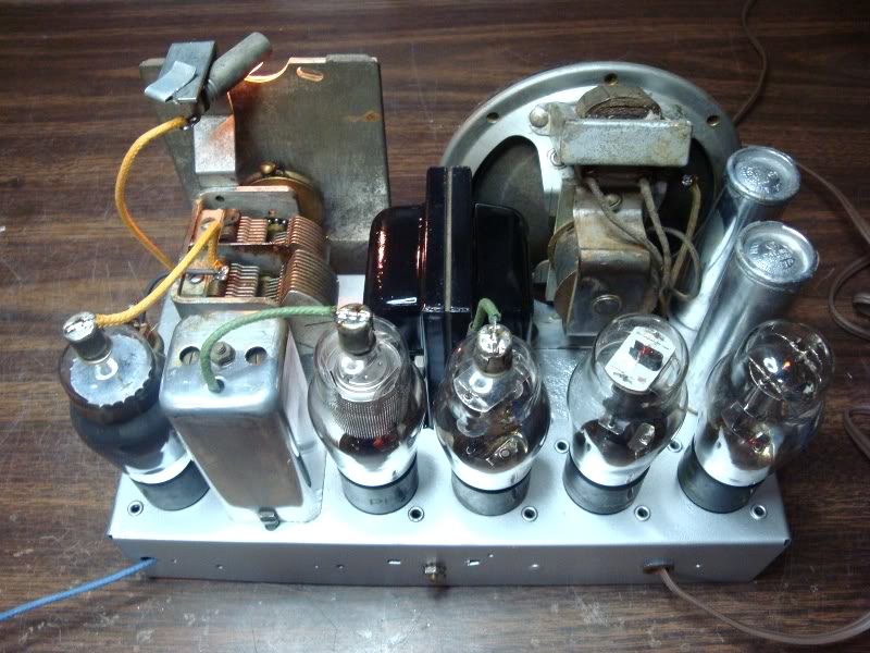

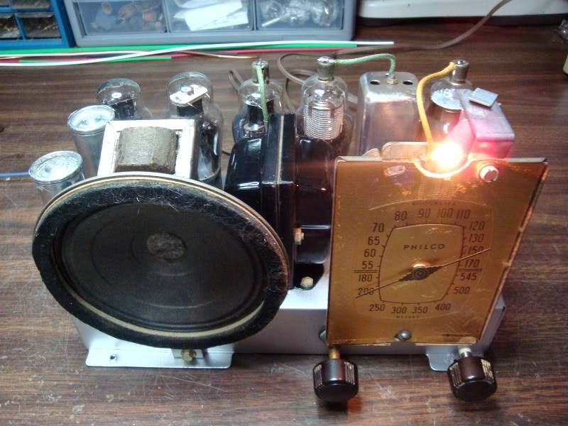

The chassis was another story. Ugh! The thing was advertised as "working," and indeed it did work. However...the original power transformer (as with all 1939 USA Philcos which used power transformers) had rubber-covered wiring, and the rubber was dried out. If the wires had been slightly disturbed, the insulation would have started flaking off and the transformer could have easily shorted out. Icon_eek
The chassis itself was a mess of yellow cadmium powder and severe rust spots on top. All of this was carefully cleaned off, and the chassis was then primed, and later painted. I am currently finishing up work to the chassis - none of the capacitors had been replaced except for one electrolytic, which was replaced decades ago. Yes, one of the original wet electrolytics was still functioning!

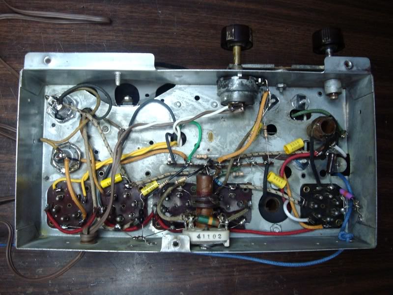

I have replaced all of the paper caps. I have carefully removed the crumbling rubber from the power transformer leads, and replaced the insulation with color-coded heat shrink tubing to match the original colors. I still have to rebuild the electrolytic cans, reassemble the power transformer (the bells are out in the garage, having also been primed and painted, and I'm waiting for them to dry) and install these parts.
I did not take any photos during the restoration process, but now I'm thinking I probably should have. However, I will post a couple photos when it's all done.
The chassis is finished!
[Image: http://www.philcoradio.com/images/phorum/ARF/016-1.jpg]
[Image: http://www.philcoradio.com/images/phorum/ARF/020.jpg]
[Image: http://www.philcoradio.com/images/phorum/ARF/025.jpg]
I won't get to the cabinet until later this week; I'll post a photo once I have applied the final coats of lacquer to it.

I forgot to mention that, unlike most USA-made 1939 Philco sets, this 39-6 had cloth covered wiring under the chassis instead of the usual rubber insulated wires. (The power transformer did have rubber-covered leads, as I mentioned in a previous post.) I only replaced a few of the cloth-covered wires; chiefly those visible above the chassis. However, the majority of the wiring remains original.
