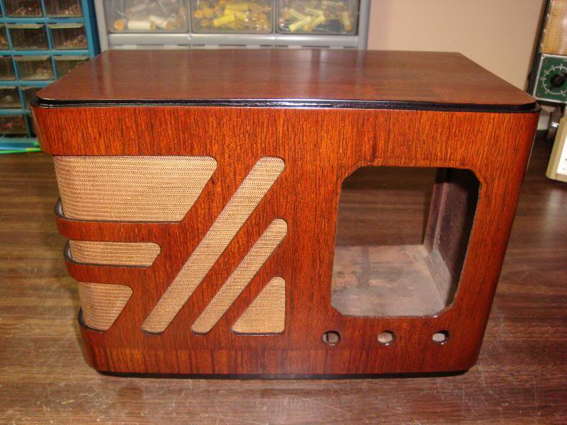

Here's the results so far. First, the 38-14:
[Image: http://www.philcoradio.com/images/phorum/ARF/063.jpg]
I don't know why the black lacquer in the edges of the grille cutouts looks uneven in this photo. It doesn't look that way in person.
Anyway, here's the 39-7:
[Image: http://www.philcoradio.com/images/phorum/ARF/068-1.jpg]
This one has brown lacquer in the edges of the grille cutouts.
The 38-14 cabinet had black trim on the top and bottom edges; the 39-7 had Extra Dark Walnut toner. If all goes well, both will receive the dark toners to their respective top and bottom edges tomorrow, and then clear coats of Deft.
Neither cabinet is going to be 100% perfect, but they are looking much better than if I had used no grain filler at all.

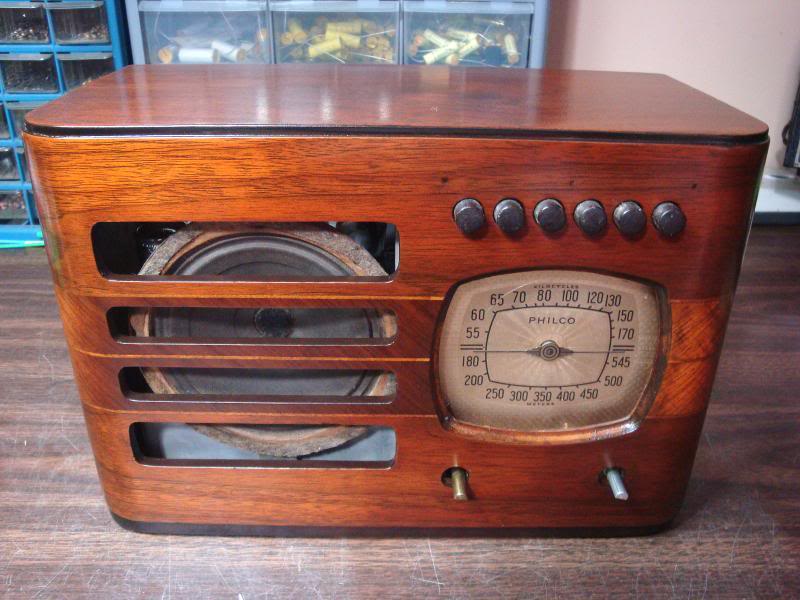

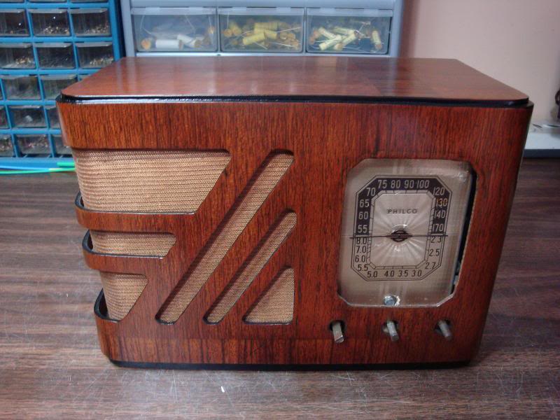

Here's the results. First, a photo, with flash, of the 38-14 cabinet:
[Image: http://www.philcoradio.com/images/phorum/ARF/001.jpg]
The grille cloth and backing board is not attached to the cabinet. I just stuck it in here for the photo, to see how it would look. This is the original cloth, and since it is still in very good condition, I am going to reuse it.
Now, a photo (without flash) of the 38-14, with the chassis inside:
[Image: http://www.philcoradio.com/images/phorum/ARF/006.jpg]
And finally, a photo (again, without flash) of the 39-7, with the chassis stuck inside just for fun:
[Image: http://www.philcoradio.com/images/phorum/ARF/008.jpg]
