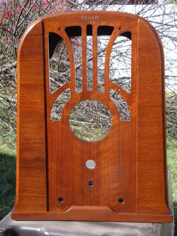

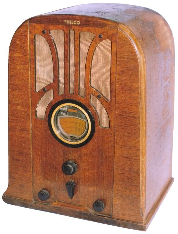

This cabinet originally left the factory as a 38-643B battery set.
[Image: http://www.philcoradio.com/images/phorum...e00000.jpg]
Yes, it is a 1937 Philco cabinet, and they did not produce this style during the 1938 season. The only answer that makes sense to me is that, somehow in spite of Philco's tight production controls, they had some 37-643B/650B/etc. cabinets left over and these were fitted with chassis and sold as 1938 models.
A genuine 38-643B can be seen here:
http://philcoradio.com/gallery2/1938a/#Model_38-643B

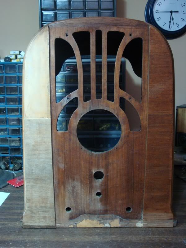

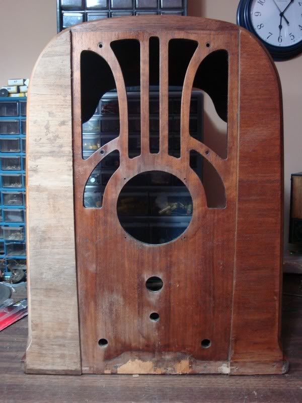

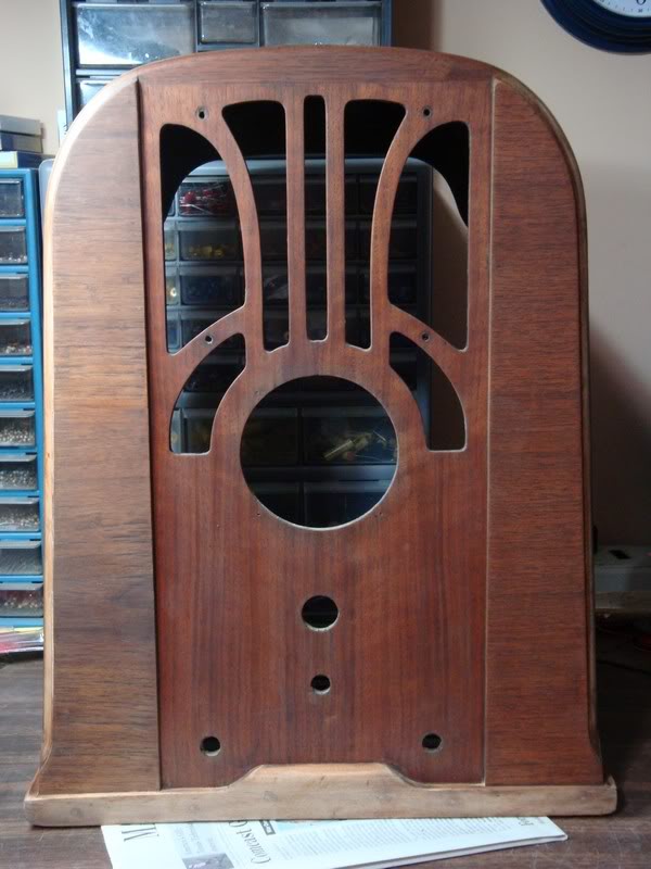

Anyway...the photo above is a set I used to own. It's a long story, but I ended up with the empty cabinet once again about a year ago. While it was gone, all of the veneer on the left side of the front panel came off. As it turned out, this set was in much worse shape than I thought it was when I owned it previously.
I had some old veneer, and fortunately, I had enough to replace the veneer on the left side. The next photo shows how I have removed the lower molding in front and have already replaced about half of the missing veneer:
[Image: http://www.philcoradio.com/images/phorum...e00001.jpg]

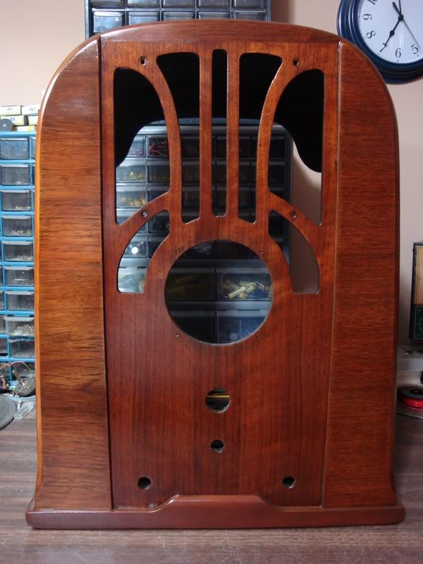

Once all of the veneer on the left had been replaced, it looked like this:
[Image: http://www.philcoradio.com/images/phorum...e00002.jpg]

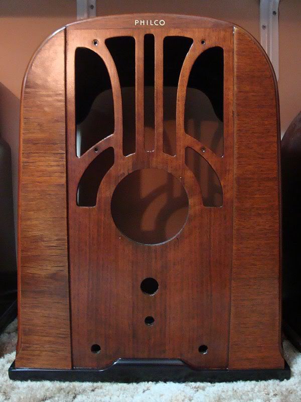

Then, the bottom front trim was reinstalled on the cabinet, the entire cabinet sanded down, after which grain filler was applied to the cabinet. This photo shows how it looked at this point:
[Image: http://www.philcoradio.com/images/phorum...e00003.jpg]
As you can see, the "new" (old) veneer doesn't quite match the color of the veneer on the right of the front panel. But...veneer that isn't quite the same color is better than no veneer, right?

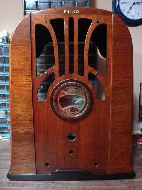

I assumed that once toner was applied, everything would even out. Well...that wasn't quite so:
[Image: http://www.philcoradio.com/images/phorum...e00004.jpg]
This is how it looked after application of toner. I used Medium Walnut overall, with Medium Dark Walnut on the bottom trim. This time, I only applied two light coats of Medium Dark Walnut on the bottom trim, and you can still see the grain on the trim. I didn't want the trim to look as if it had been painted. A slightly darker shade of toner would have been better here, but this isn't too bad.

That evened out very nicely Ron, the cabinet looks good. The only part I don't care for is the bottom trim, but that will be an easy fix if you decide to change it, and it might look a lot better in person than the picture.
Point well taken, I'm not satisfied with how the bottom trim looks, either. This afternoon I'll put some Extra Dark Walnut on the trim, and I will try to spray light coats so it doesn't look like paint.
