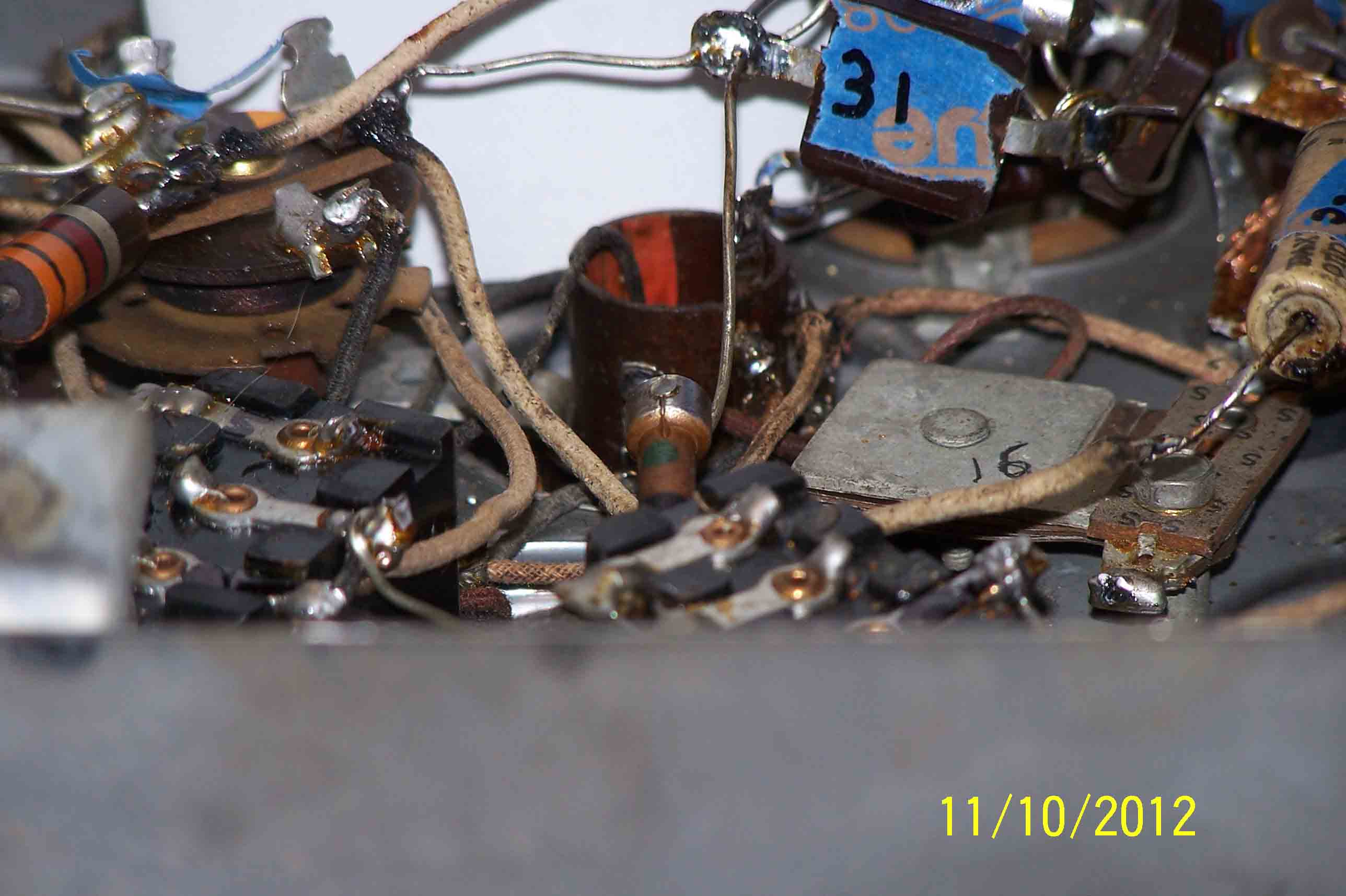

Hi fellows,new to this forum,thank you.Having trouble with 91 model,126 code.Recaped the whole thing(filter caps and the funky bakelite thingie also.All the resistor in specs.)Reception has lots of loud inteference,buzzing!.Right now ckecking the oscillator/detector 36 tube circuit.Riders wirring specs indicate resistance specs of oscillator coil,which are hard to read.Plus the denotes of riders for coil #19,part 05985 says deferent.Anyone has correct specs and experience rewiring the coil? Thank you kindly for your help.Francis

To check the osc coil measure the resistance from the cathode pin of the 36 tube to the connection on the osc coil that has the resistor and mica cap connected to it. With the set unplugged you should read a very low resistance between these two points if the winding is good like 10 ohms or less. Anything higher it's time to rewind.
The oscitator coil 05985(3)has 3 set of windings.Inner tube/coil and outer tube/coil plus the one in trouble over the outer coil.The one in trouble you suggested for kathode circuit I trased and repaired/rewinded succesfully-was reading too high @100 ohms. 25 turns,38awg wire on stip of poly.scotch tape.Before did this surgery I noted this sceme on paper.Cleaned the base coil and lackered with polycoat spray.After rewinding it is reading 5.5 ohms.Riders wiring states 3.5 ohms.Is that ok?Btw: From Kathode of 36 tube to lug #1 via new coil,out on lug#2(clockwise counting) via 10k resistor bypas with 700 mmf-mica cap to ground.

All sounds good! The resistance of the new winding doesn't matter so much it's the inductance that's important. The other important thing is the direction of the winding, must be wound the same as original!

So far so good,but before I start tuning the philco w/the transistor set, btw,very tricky!And yes you're correct IM freeqency udjust at 260 Kc for Philco 91. Looking at the Riders wiring sceme,the prim/inner tube winding states 5 ohms-my reading is 16 ohms,lug#4 and lead wire from end of the winding to plate of 36 tube(B+).The outer tube windings lug#3 between trimmers 18 +23 and lug#5 to tuning cap4 reads 5 ohms.Maybe misprint at Riders wirring-should be reversed?? Prim/inner tube=15 ohms,Sec./outer tube 5 ohms ????Well,this set is pouring some tunes out now.Also rewinded the coil #12.Same task.25 turns,38awg wire,clockwise winding start at lug 3 to lug 1.Rest of the coils at this Philco 91 circuit test as they should by Riders wiring sceme.

Ohps....had to take a brake from that rascole. For some reason the darned thing comes and goes out of reception,when going all way out to high scale on dial.Come back when dial returned to lowest dial. Very weird!? Did some reading on forum and desided to downscale the cathode resistor on 36 tube from 10k to 7.5k Ohms.Touched up a bit the near by trimmer and urika! Thanks a bunch to all of you fellows for your knowladge and supportive help. Btw: this Philco 91 has quite a decent fidelity= worth to doodle around!So,it didn't hurt to trick up the IT primary. Next Philco on my bench,please-I'm hooked!
