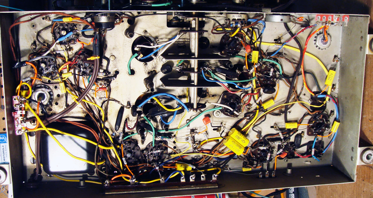

I'll second Arran's suggestion. Why waste money on things not visible unless you take the monstrous chassis out and turn it upside down.
Here's a picture of its older model 811K with all wires replaced.
