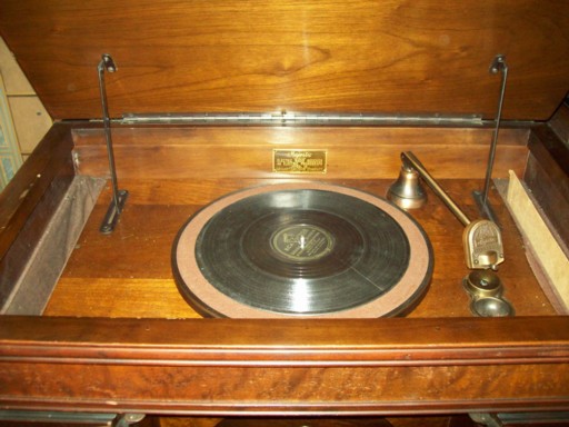

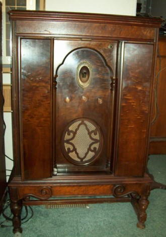

I've hinted at this a few times, now I have some pictures and am posting about this radio I got in a round of big trading and dealing a couple weeks ago. This set was found at a building salvage place up north and appears to have come from a house or mansion that had been abandoned and is now a vacant lot. There is still a question who got the better end of the deal, but to score a working Majestic with all good tubes, including two very good globe 50's can't be too bad of a deal. I had another later Majestic with two 45's several years back, but just didn't like it and passed it on. This one I have really grown to like. The only head scratcher is the tuning plates. The rest of the radio seems to be really good quality from the time, but for some reason they used pot metal for the tuning plates! They have survived decently except one tiny spot where they rub, and I am not messin' with those! Anyways, pictures!

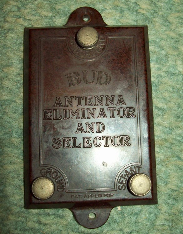

Also found this interesting item still attached inside the cabinet. Wonder how this worked?

Warping pot metal in the tuning capacitors seems to have been a problem with many American Grigsby Grunow Majestics from that era, I haven't run into that problem in any Canadian Rogers made Majestics from those years though, even though the chassis and circuits are very similar. There are ways of repairing the problem apparently, although as with anything like that it isn't a job for those who are not mechanically inclined or have experience with such things.

I can't figure out why Majestic used pot metal for the tuning plates in this set. It's not a low-cost set and I have lower quality and lower cost sets from that same year that use copper plates. Even Philco used better plates. Seems someone was trying to squeeze out a little more profit at Majestic.

The pot metal isn't in the tuning plates themselves it's in the hub that mounts the plates to the tuning condenser shaft. To my knowledge no manufacturer attempted to make condenser plates out of pot metal even back in the 20s.
Jayce
Congratulations on your acquisition! I saw one of those at a local auction many, many years ago, when I was still living in Kentucky. Haven't seen one since. Your set has a dial like a Majestic 71. Very neat radio.
Too bad about the pot metal, but Majestic used the stuff in most if not all of their early sets.

I actually had a late 20's Crosley battery console set that had pot metal tuning vanes. Yes, they do exist and are a pain.

This Majestic is a Majestic71, that uses 27's in place of the 26's throughout the receiver chassis, then a pair of 50's in place of the 71A's as used in the 70 chassis.
The speakeris the same one as on the 71 sets, and I even think that the interstage transformers, and te output transformer are the same as on the 71.
Anyway, the power supply has a pair of 81's for the rectifiers. The 50's make that speaker earn its keep. They do to that speaker whet the 71A's can't!! I have one of these sets, amnd it really made me in love with G&G Majestics, after a lifetime of poking fun at them.
Now, on the tuning condenser. I've always been able to get a screwdriver in betwen the plates, and pry them into alignment, right at the pot metal attachment. The use of pot metal was a bonanza for manufacturers at the time, but impurities in the zinc they used caused all of that intergranular corrosion. There were some examples of good die castings, but the cheaper stuff (just look at Crosley's stuff), and there are bad examples. If you get this Majestic shaped up, you'll have a very nice set there.
