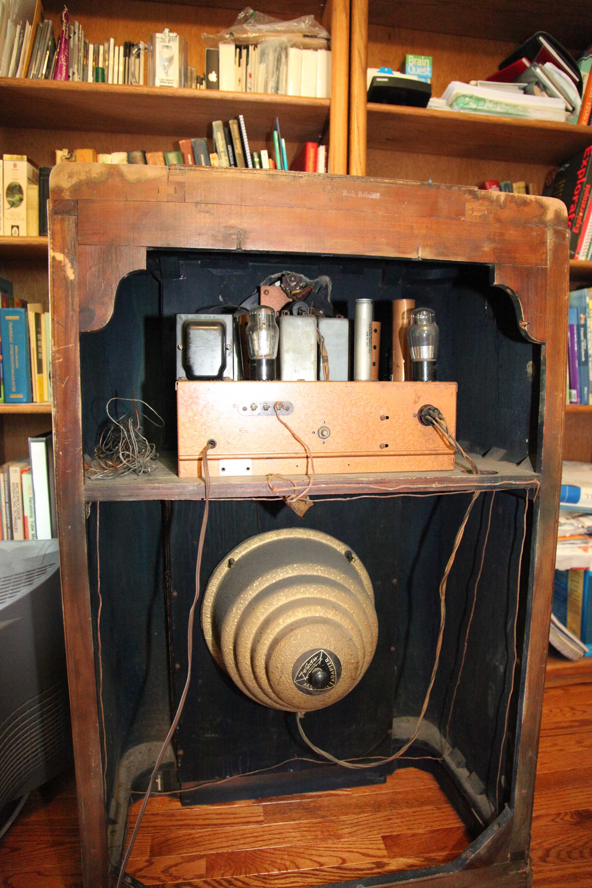

Well, here's my 9S262.

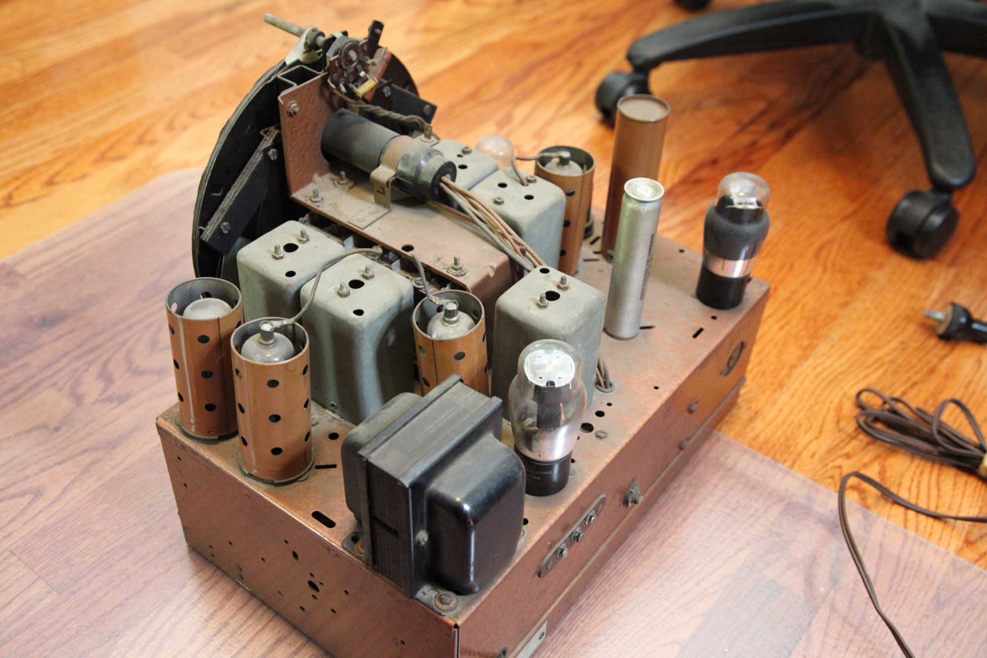

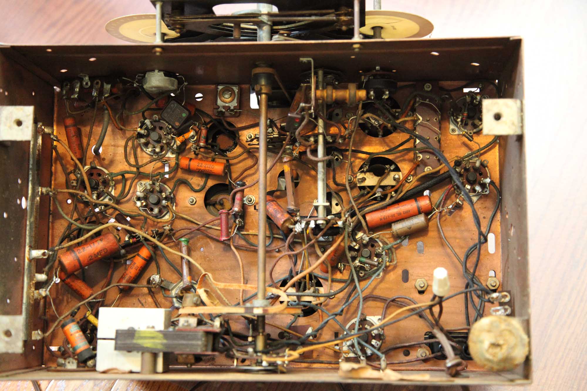

Took it apart.
Here it is.

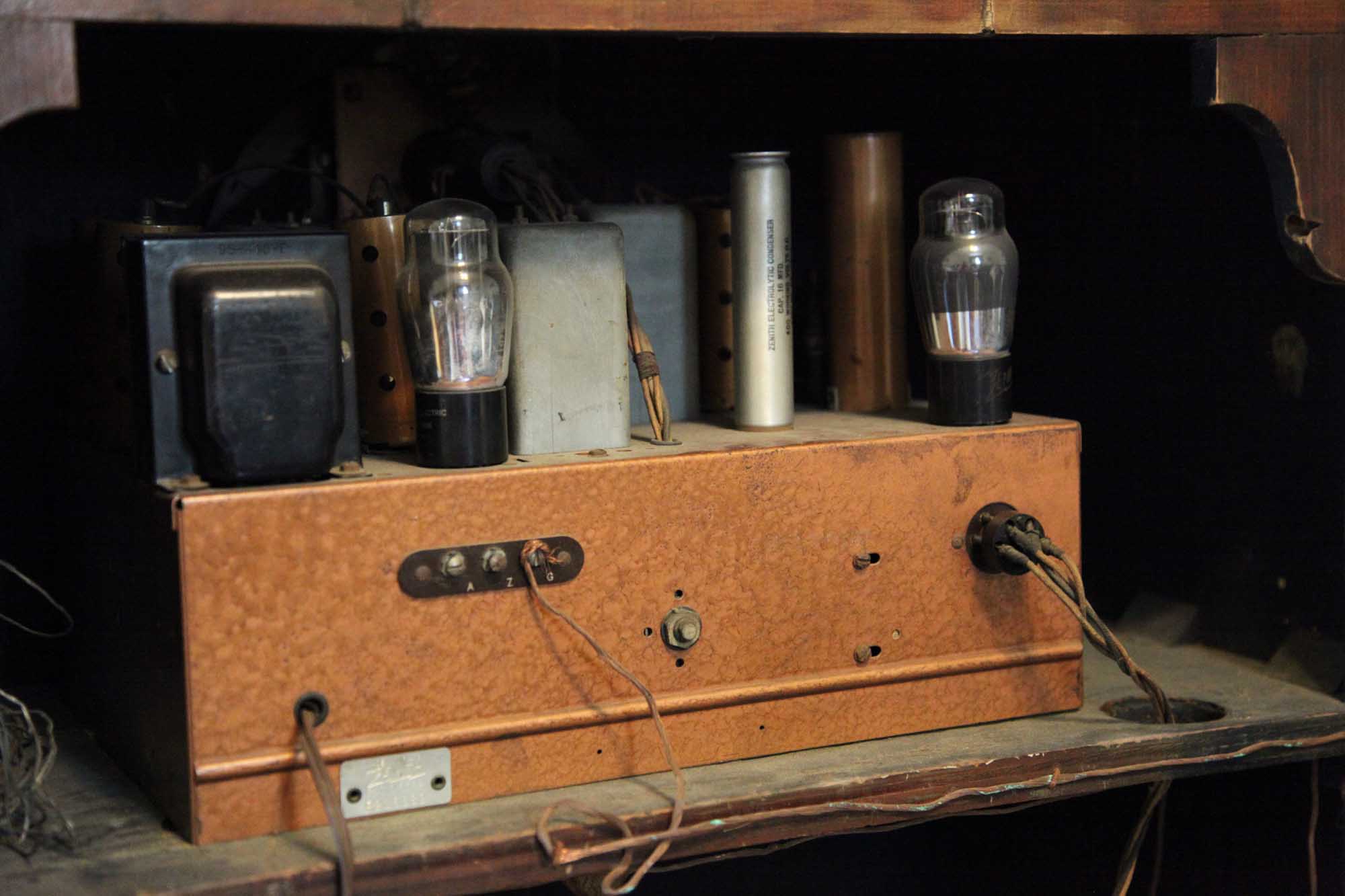

Back view.
Top view
Bottom view.
The seller told me he heard the motor run but the tuning did not work.
This is, I think, the reason.

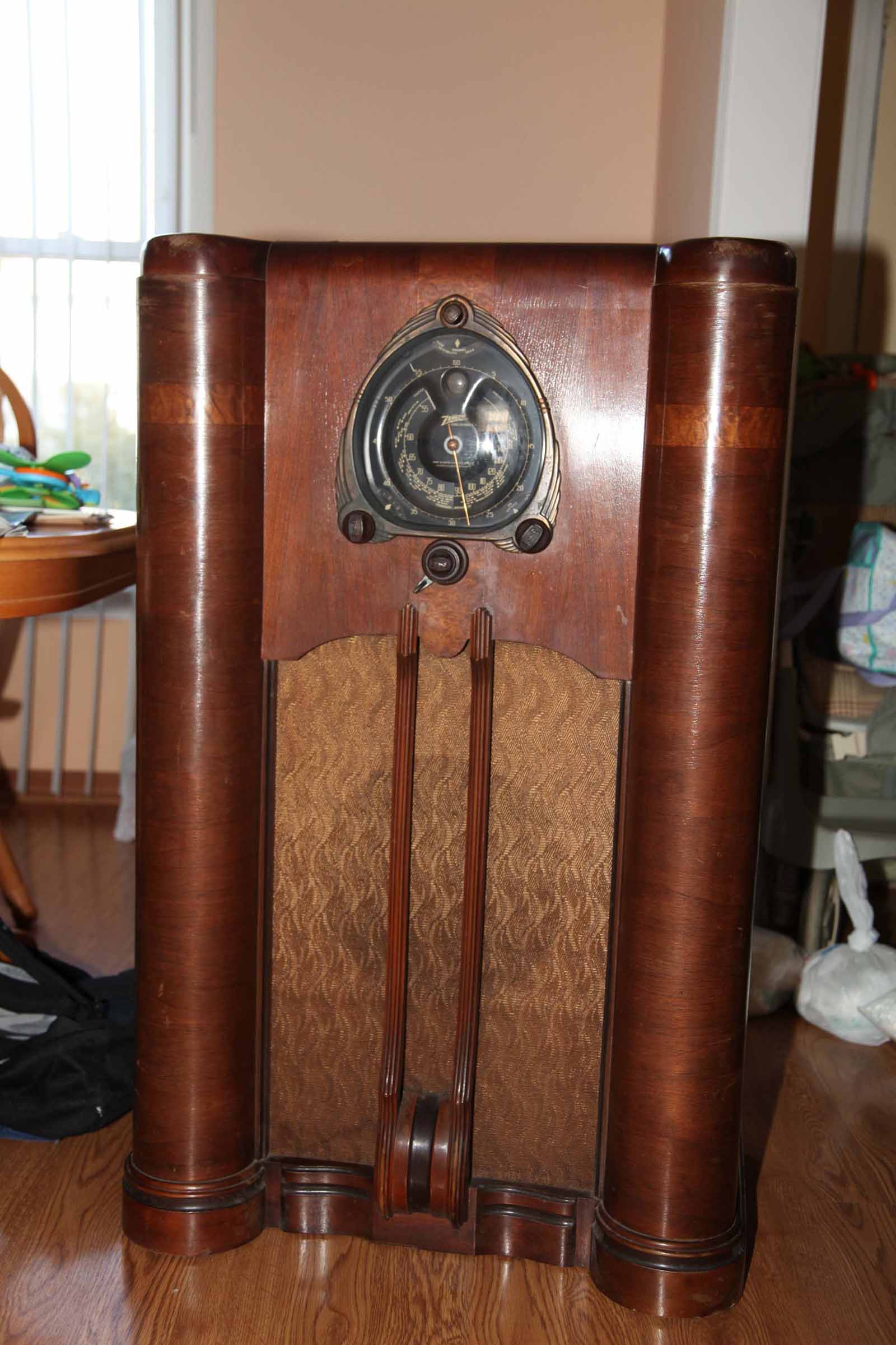

Your cabinet looks better than mine so that's a big plus! Keep us posted on your progress!

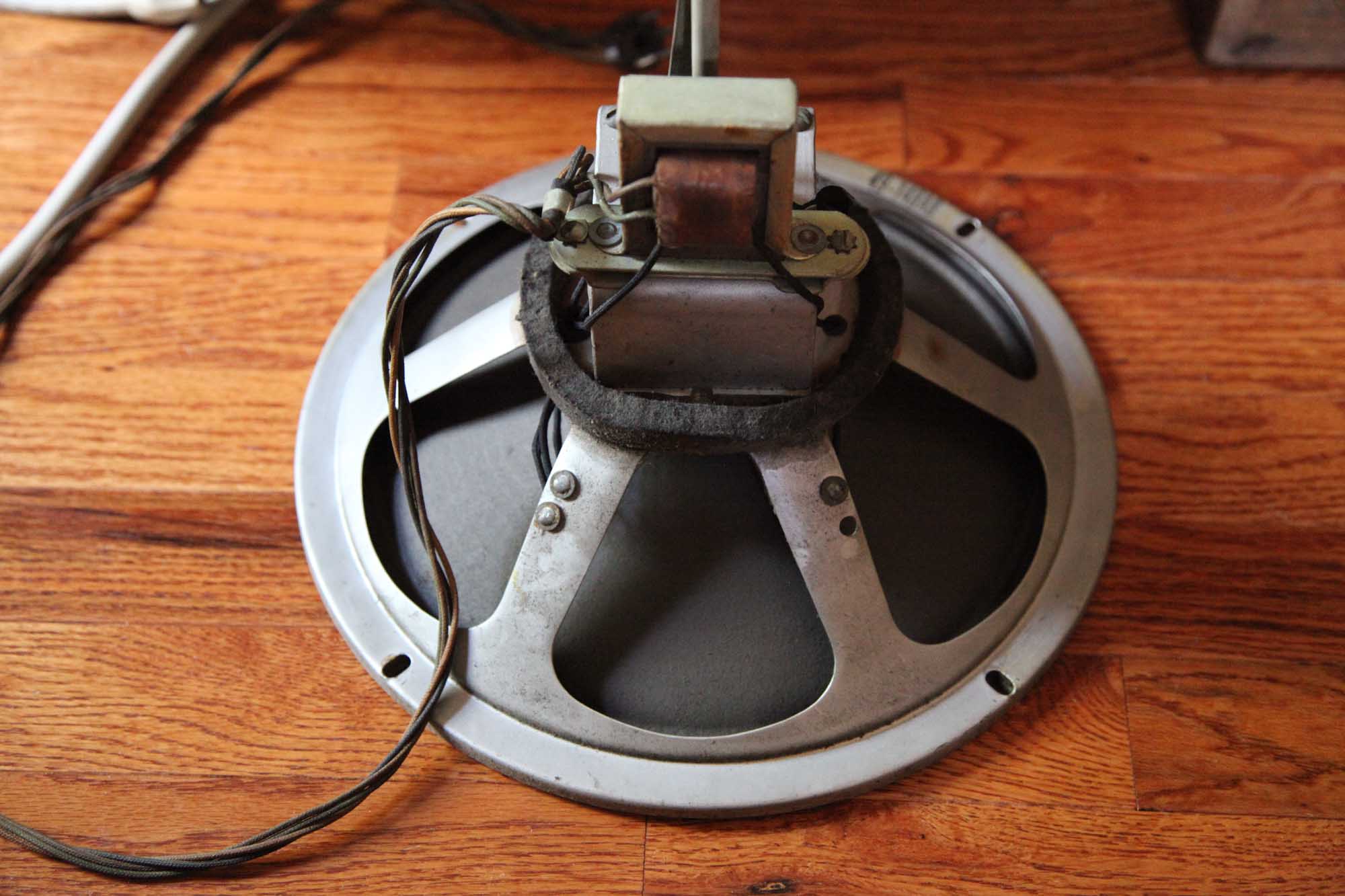

1. The speaker itself is looking good.
But when checking the speaker plug with the meter, I have the resistance between internal two pins at 900 Ohms (should be 1K I think), and this is the field coil.
However the outer two pins (I think it is the primary of the audio Xfmr) is open. I think it is busted.
What do you have there?

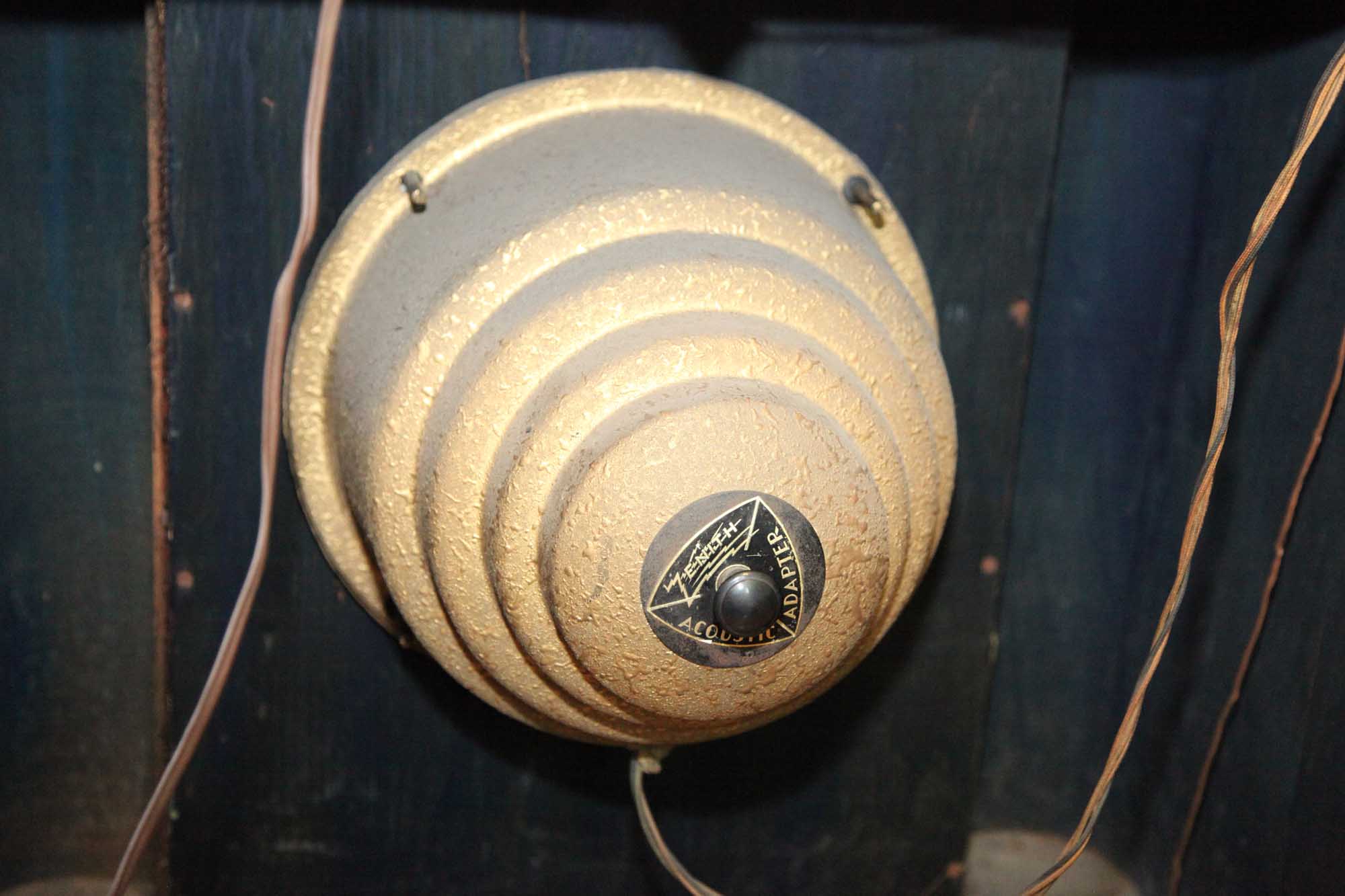

2. When I removed the acoustic adapter, there is that rod that hoes through the speaker, and there is some grooved bracket hanging off of it, and there is some loose tape and insulator wrapped around it. I think it is the support for that nut that is the stop for the adapter, but not sure. It is loose, so I wonder what, if anything, should be done about it.
3. Since the Output transformer is likely kaputt, I think there maybe a problem wit the 6F6G tube, but that's minor.

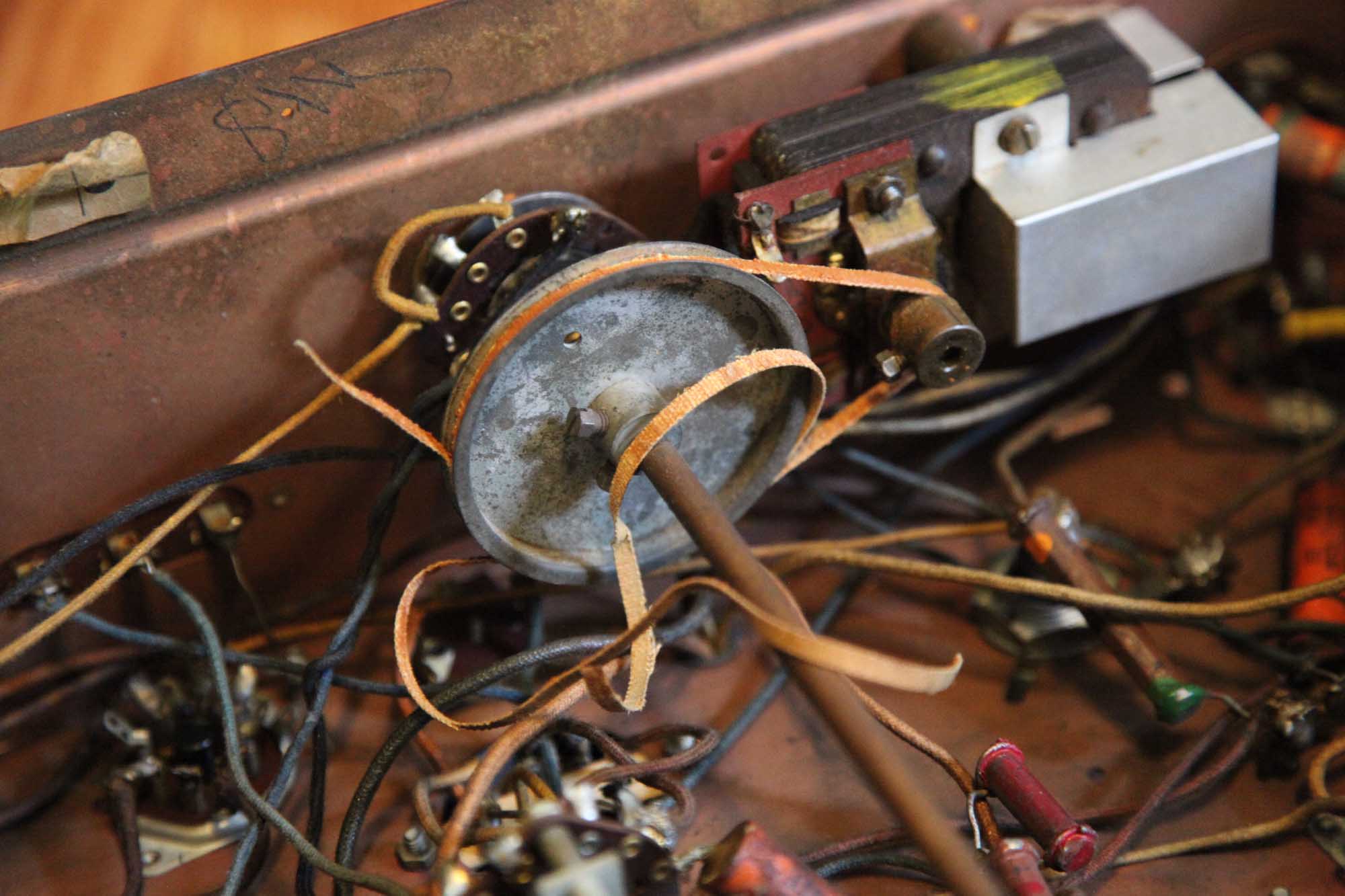

5. The mech. assembly (cogwheels) rotating the runing cap is frozen. Guess that contributed to the belt going kaputt.
The other belt (manual shaft) is OK, but nothing moves. Perhaps some WD40 or White grease will unfreeze it.
PS. The cabinet indeed looks OK. No one tried to restore it, and though it has its share of scuffs, I think it may be fixed by a skilled person (probably someone other than myself Icon_smile )

RE the speaker and output transformer:
1. One leg of the speaker secondary is connected to a small out of phase winding to oppose hum induced by the field coil before going to the voice coil. Sometimes the connections to the transformer or field coil go bad at the connecting wires, so carefully disassemble and confirm that you have an open. Now disconnect one leg of the voice coil and measure it and the transformer secondary. If the voice coil and field coil are both good, and the speaker is otherwise in good shape you only need the output transformer, which should not be hard to find. You don't have to have an exact duplicate, plus or minus 15% will not be audible. If you are going to change out the speaker, then you will have more considerations. Lots of options.

I did unsolder the transformer yesterday, as the wires in the plug go directly to the primary, and there was no serialized anything there. So I was fairly sure of the Transformer being bad.
As I suspected, the primary is opened.
So I do need a new one, and I think "Oldradioparts" have some cheap options for me. One matching exactly, provided my voice coil impedance is what I think it is.

Here's what I would do:
1. Go ahead and get an inexpensive replacement output transformer, 5 to 7000 ohm primary; 4 or 8 ohms secondary, won't make a penny's worth of difference. 5 watts is plenty. You're going to need one no matter what else.
2. If you have recapped the set and are ready to test, hook up the "new" transformer and bring the set up slowly.
3. When the output stage starts drawing current through the field, it should magnetize. Now measure the voltage before and after field, see if it's within range. Monitor voltage after field coil as you bring it up. If there are shorted turns, the field will become hot soon, not a danger to anything but the field itself, unless there is a short to the frame. Voltage after the field would be low because of lost power. Run long enough the field short would eventually turn into an open. That being said, actual vs published values on such things are not always accurate, an subject to change, so we try it, No?
4. Then assess the situation. An original working replacement may take some time to find, and probably won't come cheap. Reversable work arounds include using a P.M. Speaker, a choke, or larger filter capacitors and power resistor in lieu of choke. Been done so many times, don't want to repeat here.

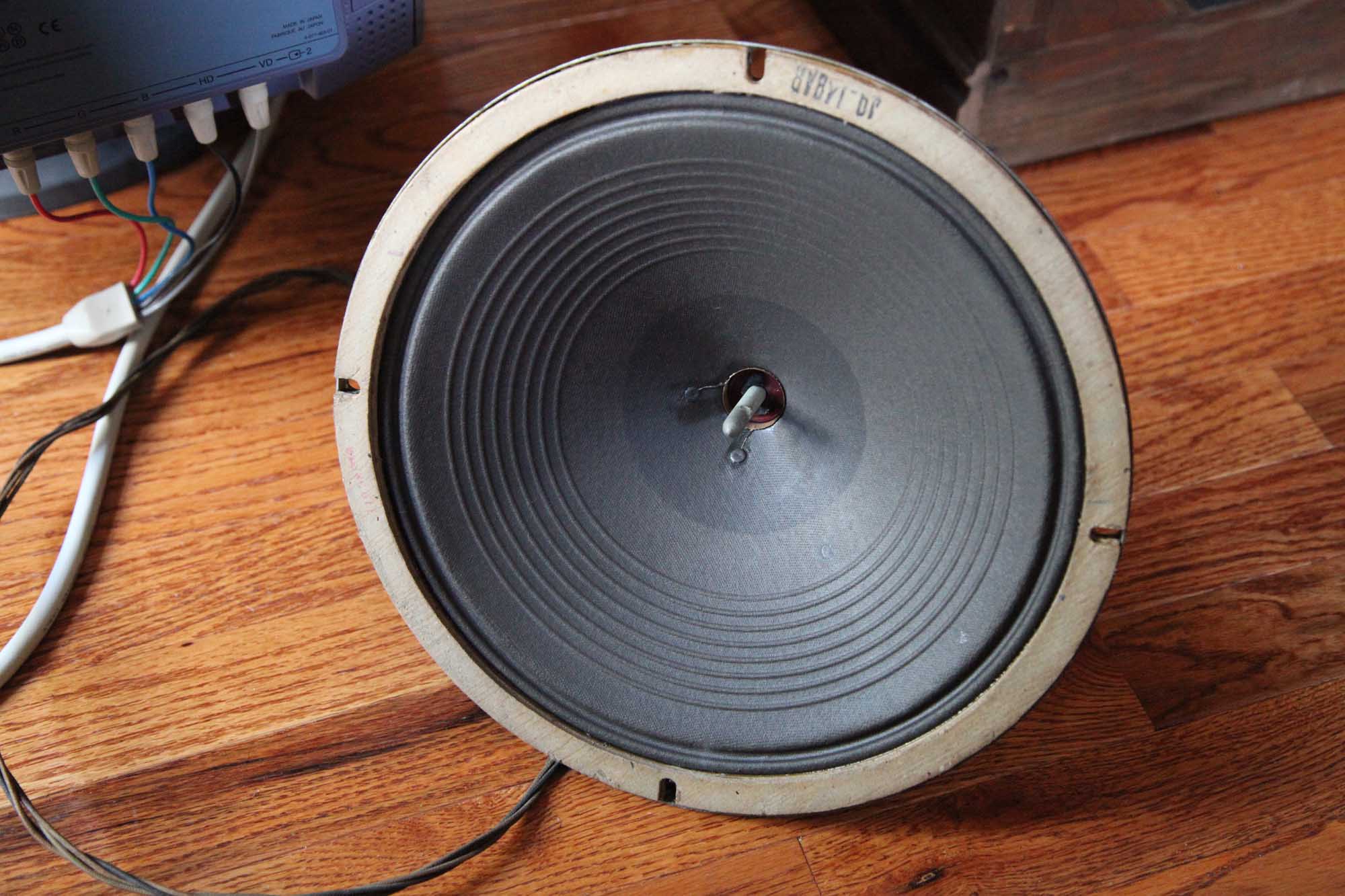

As for converting to PM speaker...I will put the photo of my speaker here - it is nothing short of MINT! - would be a sacrilege to throw this out due to a stupid transformer; I restored a Philco 20 speaker with fully missing cone and fully blown transformer, just to see the right speaker there. And this one is just....like new. No rust, no discoloration on the cone, no rips or even hints of rips. No, I can't Icon_smile

This is my speaker.
No way I am gonna swap it for a perm magnetic one.
I doubt whether there is anything wrong with the speaker, the 1000 ohms sited on the schematic may mean inductance rather then DC resistance, even if it is DC resistance 810 ohms is well withing the margin of error of those days of + or - 20%, if the field doesn't get smoking hot I would leave it alone. If if lets say the field winding was shorted I would take the route of rewinding the field coil before dumping the speaker, especially if you can unbolt the mounting bracket.

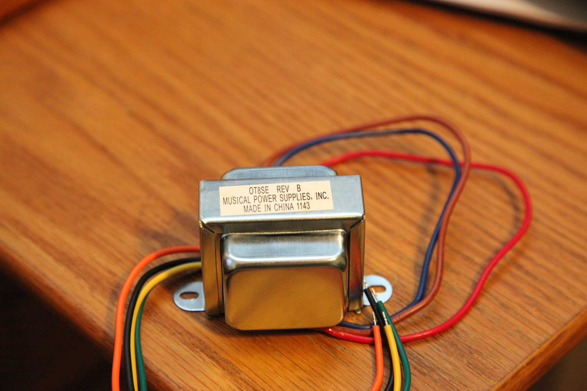

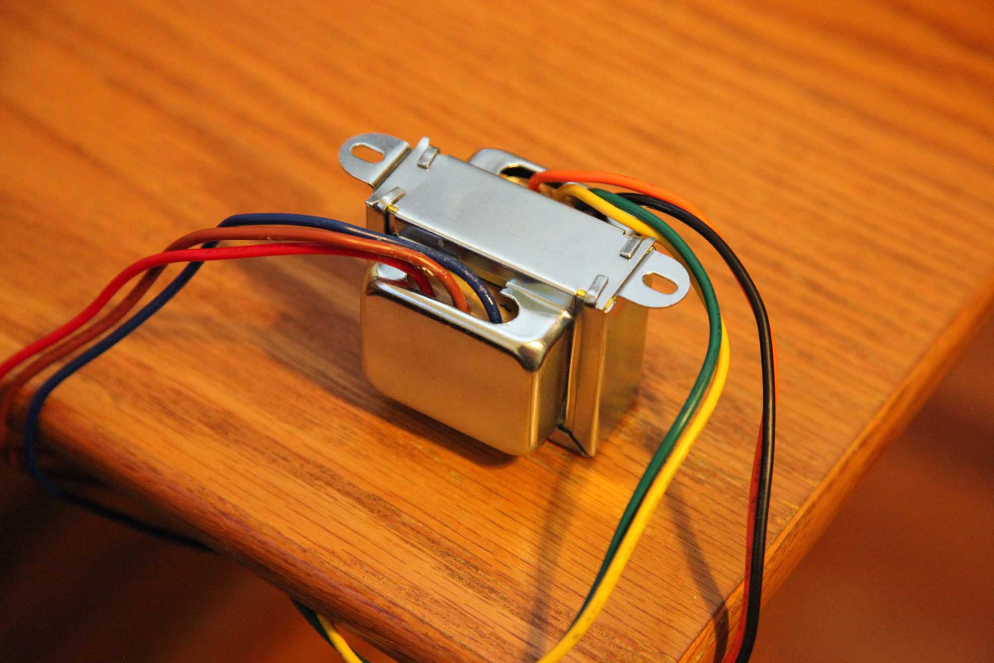

I bought this:
http://www.ebay.com/itm/OT8SE-Tube-Outpu...9422890997
This is an SE transformer, 7K primary at a possible 3.2 Ohms voice coil. Should suffice, I think, and the 10W rating is more than enough.
PS. Just received it.
