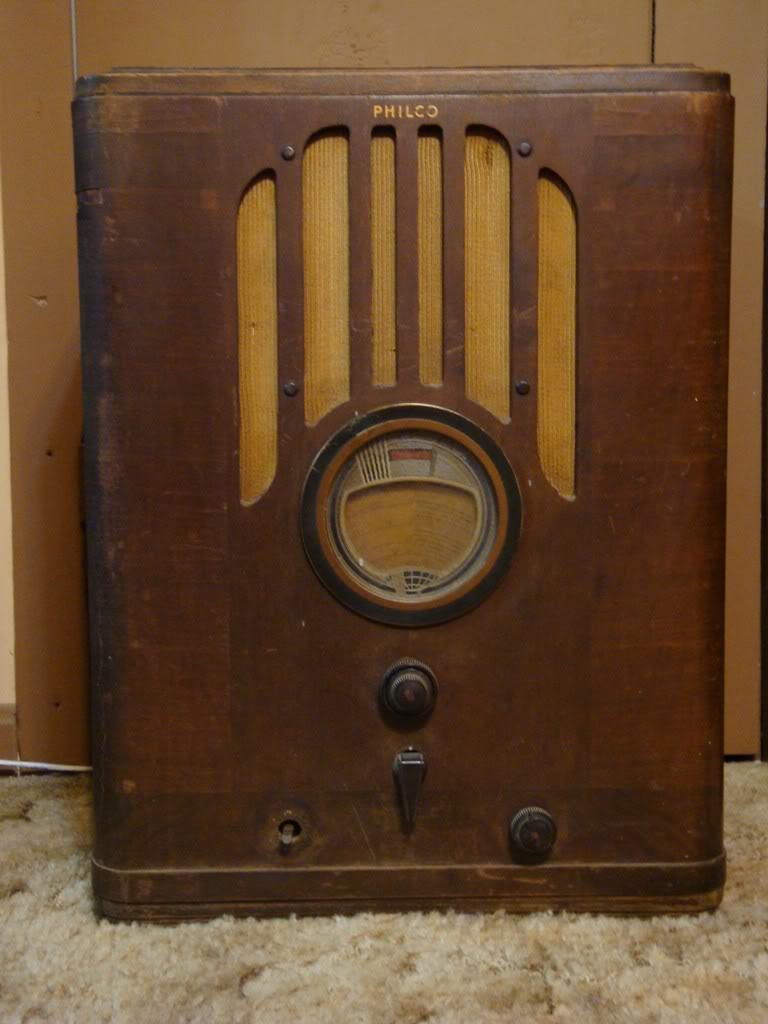

I have a little over a C note (including shipping) in this set:
[Image: http://www.philcoradio.com/images/phorum..._00001.jpg]
Not too bad, eh? Look closer:

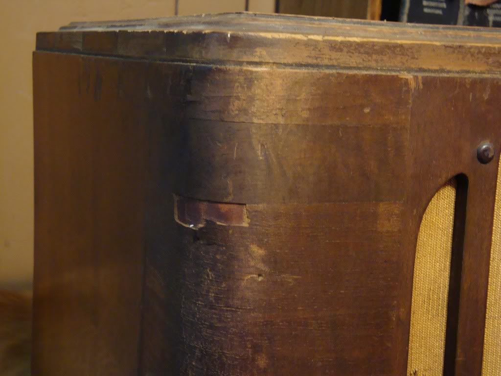

Small piece of veneer missing from left front corner.
[Image: http://www.philcoradio.com/images/phorum..._00002.jpg]

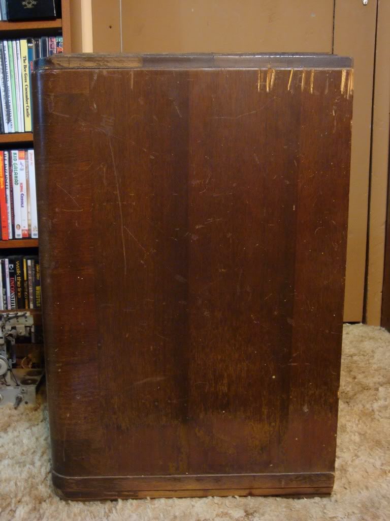

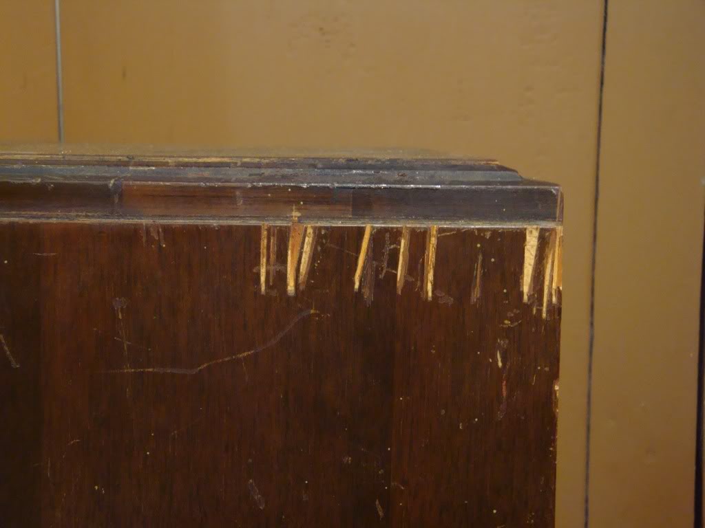

Someone must have tried their hand at wood carving on the right side. A closer look:
[Image: http://www.philcoradio.com/images/phorum..._00003.jpg]
There is a reason eBay sellers use dark, blurry photos to sell something.

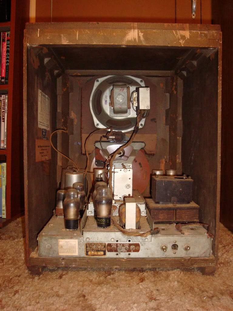

Bob: Here are some photos of the back of the set:
Dirty, but more or less complete. The 6F6G output tubes and the rectifier are missing. Some tube shields are also missing.

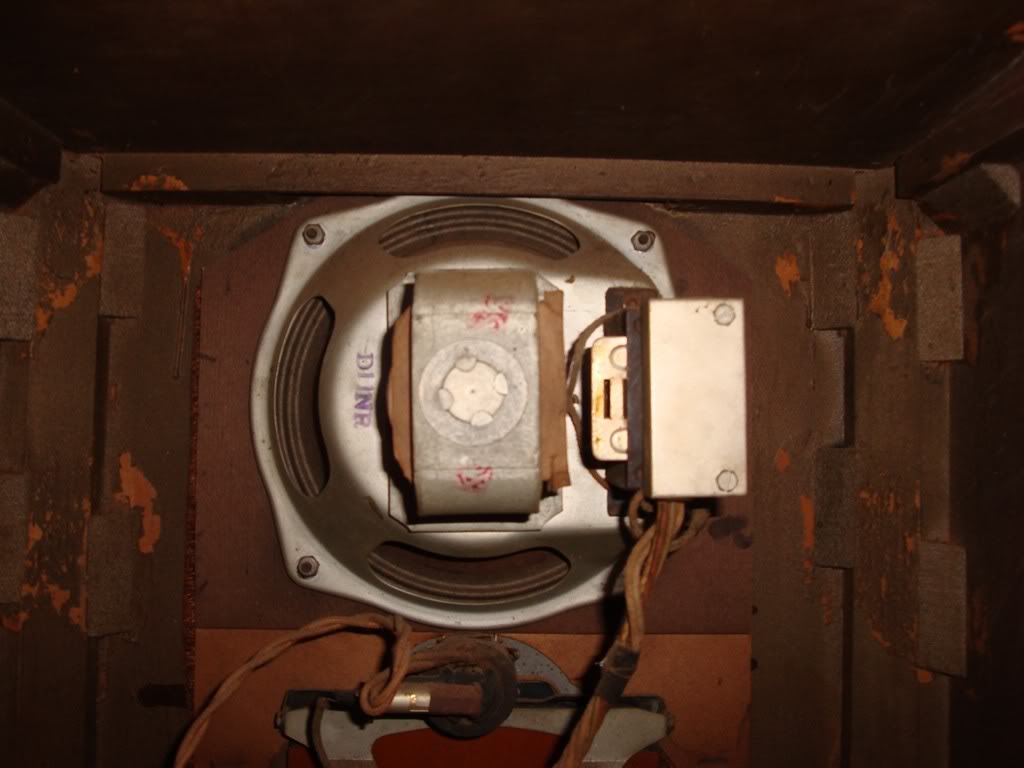

[Image: http://www.philcoradio.com/images/phorum..._00005.jpg]
It has its original speaker!

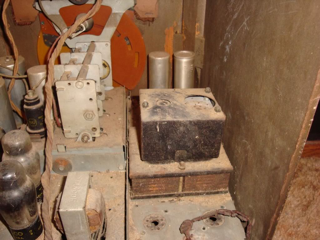

It has an export 110/220 power transformer. I have noticed many 37-670/2670/38-2670 sets use this transformer, but I don't know if all of them do.

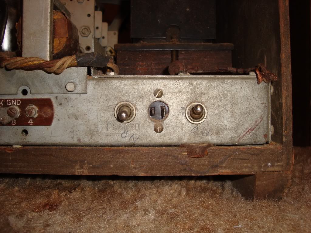

[Image: http://www.philcoradio.com/images/phorum..._00004.jpg]
Some creative modifications. I do not yet know what the two toggle switches and the two prongs are for.

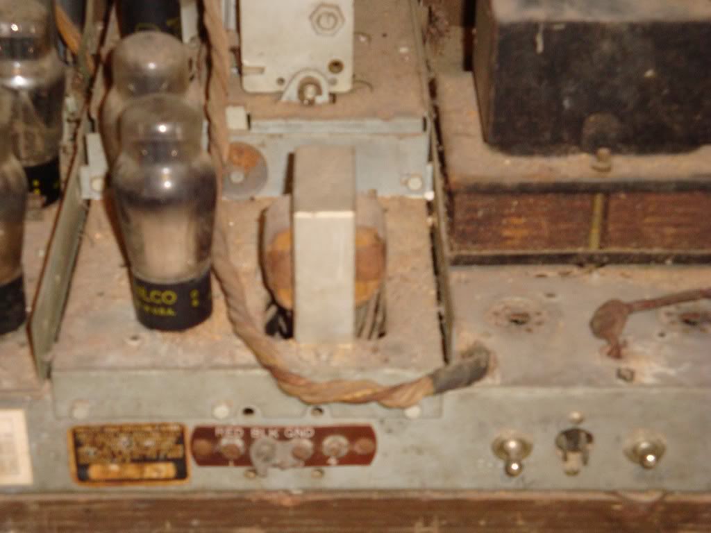

[Image: http://www.philcoradio.com/images/phorum..._00006.jpg]
Not a good photo, but it shows the original audio interstage transformer has been replaced at some point.

That looks like a nice little girl cat, like many cats do she seems to be investigating what's going on. I'm just taking a guess here but I'm sure that the plug and two switches are some sort of phonograph input, or at least an input to the audio amp, either that or someone was stealing power from the power supply to operate some sort of accessory like an external BFO unit.

My 37-670 does not have the export power transformer. My 38-650 does have it.

I saw this radio on E Bay. I'm glad you got it. My 37-670 console does not have the export transformer either. You should consider yourself lucky your kitty allows you to work on any radios in her house :-).

Sometimes, but not always, you can remove the bottom molding an harvest bits of veneer to use for patches. Same as tucked in tolux on old amps and tube testers. I knoq I'm a scrounge, but whatever works.

Thank you, Tom (TA) and Tom (Hamilton) for letting me know your 37-670 sets have the conventional (110 only) transformers. I used to own another 37-670B years ago, and I am 90% positive that it, too, used the conventional 110-only transformer.
