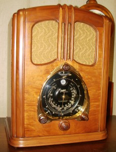

Just bought a Zenith Walton.
This radio has been nicely restored and plays well, but does have a few issues that I need to target. The tuning dial is a bit sloppy and the controls such as the volume are very stiff, though no crackle or audible issues at all, so tuner lube these or bad idea? Also, how do you get the lube into the volume control? Appears to be sealed.

Nice radio. Hope the issues with it aren't hard to correct.

If there is no hole in the pot, then if yo really think it needs a lube, you will have to open it.
As for me, I only open pots with real issues.
Typically I'd agree, but I'm afraid if breaking those wooden knobs on there! One of them is that stiff.

Bill Turner sells a gizmo to get lube/cleaner into sealed pots:
http://www.dialcover.com/components.html
Quote:CONTACT CLEANER ADAPTER - This is a custom-made device that can be screwed onto the front bushing of a sealed pot to inject contact cleaner - $8.00
Here's the only problem; Bill has no e-mail so you have to either call him or just trust him and send a check, cash, or money order. A friend runs his webpage for him. It is a pretty simple but neat gadget to force cleaner/lube into a sealed pot. I had an old electronics instructor who called it a "ga-zin-ta" but I could never find one until I ordered one from Bill.

If your tuning is sloppy because of a loose belt I recommend you buy replacements from Adams:

Nice find! Which model is it?
