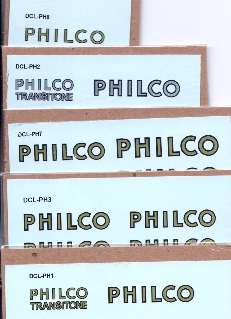

Folks, you know that I have been saying for years now that the PHILCO decals sold by Radio Daze were very inaccurate in appearance.
I am happy to report to you that most of the decals have been corrected!
[Image: http://www.philcoradio.com/images/phorum...Decals.jpg]
Don't worry, that new PH8 at the top of the photo above is not blurry on the sheets - that happened because of my stacking several decal sheets on the scanner to make the picture above.
I'm not currently aware of any Philco model needing a silver decal, but they have them (DCL-PH2), and the font is now correct.
I think the TRANSITONE font still needs some work, but I need to photograph some Philco Tropic decals and have some custom decals made. I think that when I do that photo shoot, I will also try to photograph an original Philco Transitone decal and submit it to Radio Daze.
I want to thank Mike Slusser and his staff for listening to us and making these decals "right." I hope that those of you who wrote to him with your concerns about the incorrect styles will now contact Mike and thank him for the new correct types!

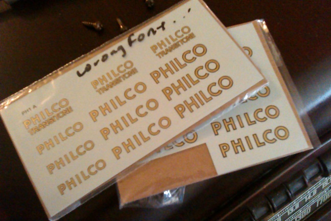

The new Philco decals from Radio Daze look great but beware when trying to install them. They are SO delicate you have to be EXTREMELY steady when applying them or they will tear or fold over. Also, you may wish to clear coat over them, as (I found out the hard way) the gold lettering will rub off with just the slightest touch! I had to remove the chassis from my 47-1230 one more time and trying to remove the knobs, as delicate as I was, I still managed to rub off the volume decal... grrr! These decals are a LOT thinner than the one's previously available on the white colored paper (these are on light blue paper). Not criticizing by no means (they are an improvement in accuracy), just wanting to forewarn fellow collectors / restorers :-)

I've tried the decals today. They are very easy to work with. Once dry, the lacquer doesn't seem to be any issue.
here's the "bad" and "correct" decals side to side.
the "correct" one sure looks better.
-Mars
