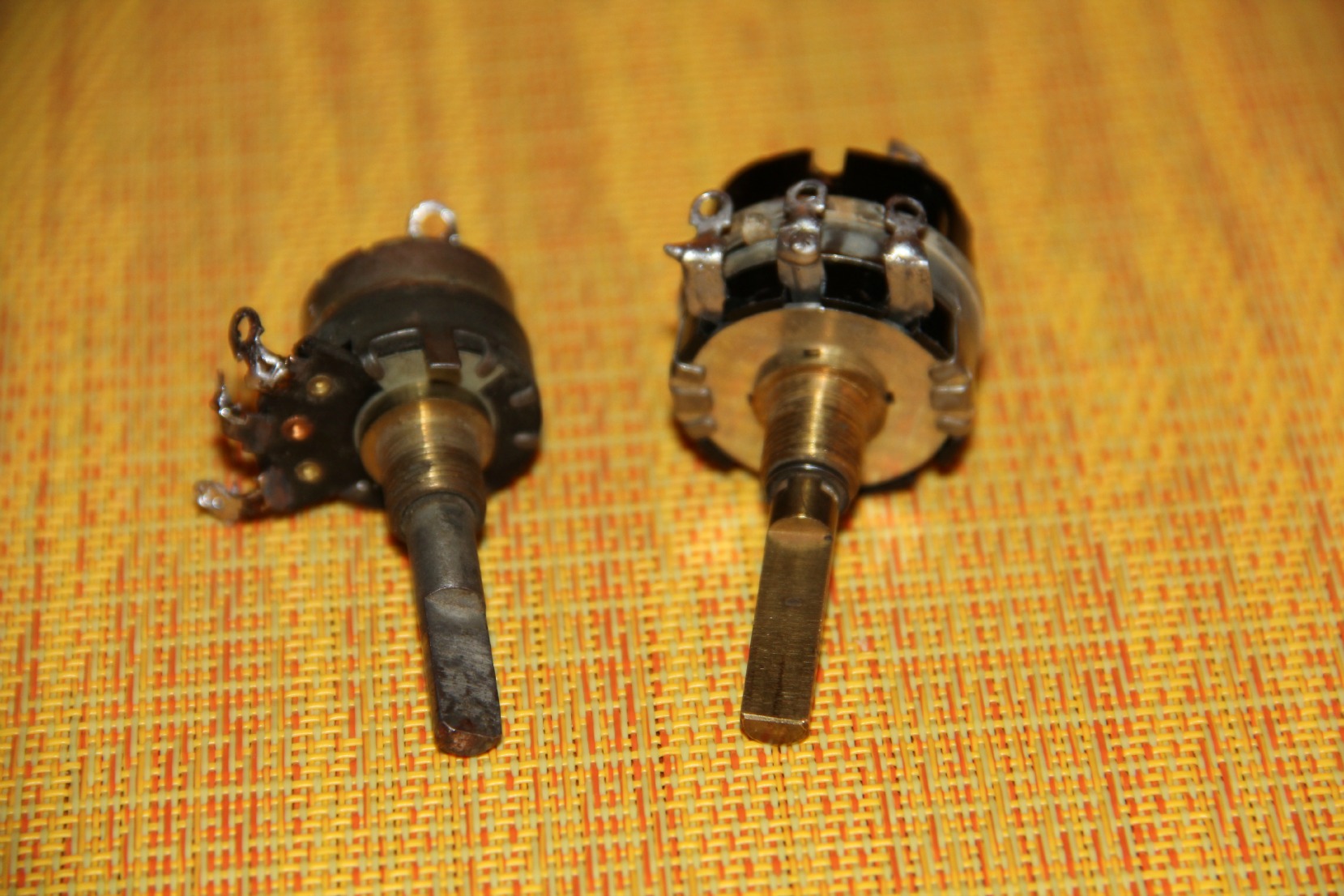

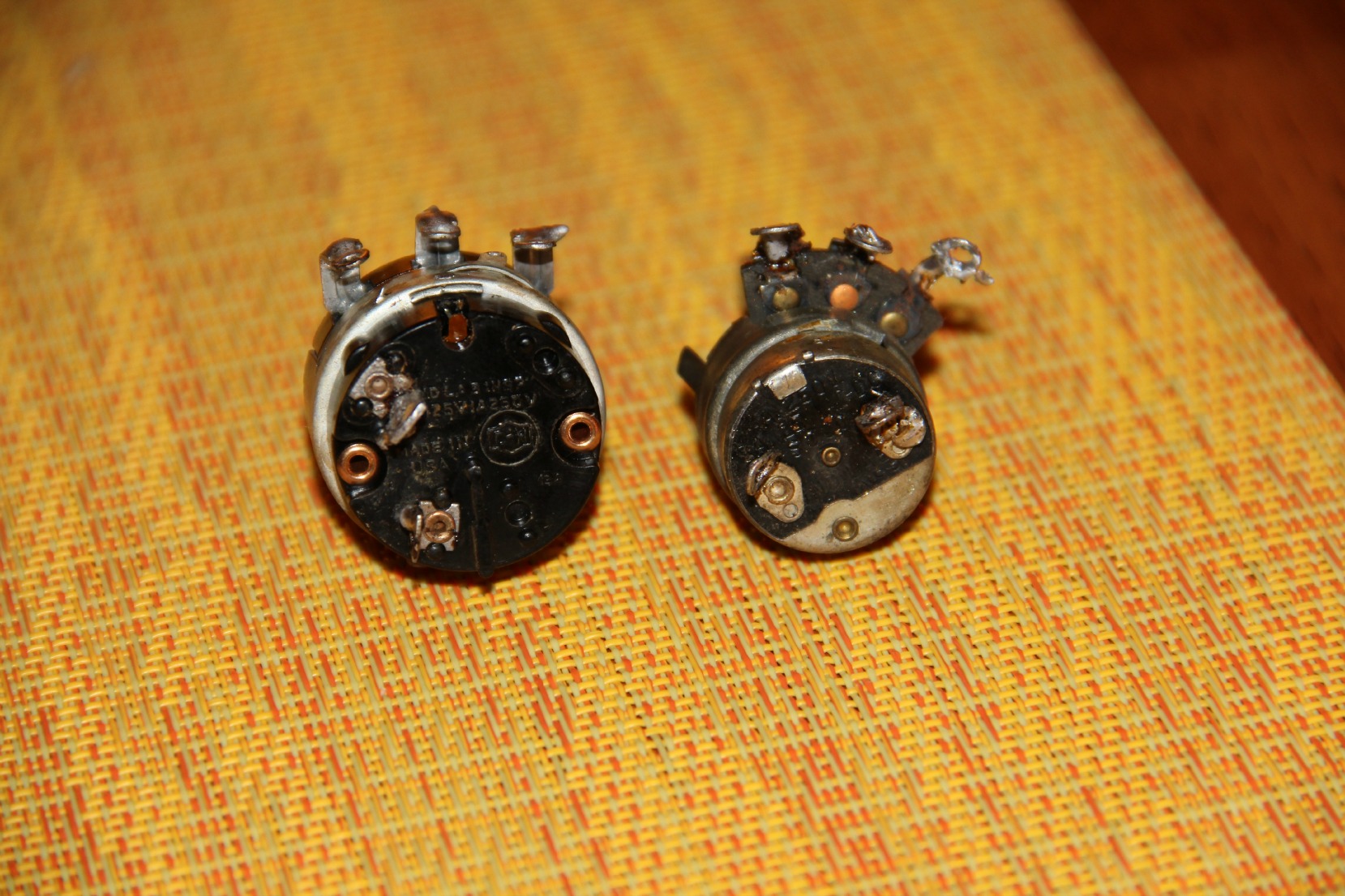

Here are the on/off volume controls from a 42-PT95 (smaller) and a 1947 Philco with the same chassis (larger).
The back 2 connectors. Are they interchangable ? Since the layout of the 2 controls are slightly different, I want to make sure before I re-wire the new volume control, and not short somthing out.
Thanks.
The physical size of the control does not make any difference. If the value of the control is close to the original you are go to go. You can check it with an ohm meter, where there are three terminals take, your reading between the two outside ones.
