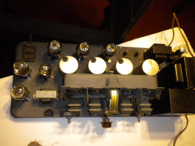

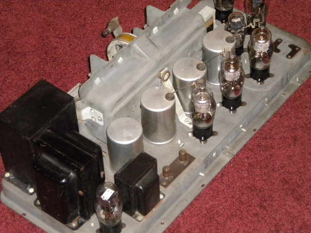

Hi guys, its been a while since I have been on the forum, work is getting the best of me Icon_sad. I took a road trip out to Indiana last week to pick up this beautiful Philco 95 Deluxe console. I have wanted one of these for my collection, and I have to say it is one of the nicest cabinets I have come in Philco's early years. The tube shield is missing but I was able to locate a parts chassis, online, I am waiting for that still. The story behind this one, it's been in the same family since 1929, and still retains every original part except for one filter cap on the bottom, and the tubes. I did a initial test run of the radio just a few minutes ago, the transformer is good, all the tubes lit up, and I was able to pull in over 7 stations including the one on my SSTRAN. This set will need a recap though. I still have two projects in front of this one, but have a few questions for you guys.
Where there several different variations of the 95? Mine is the 7 tube model, some original Philco information shows a 95 schematic, but with 9 tubes. I have looked underneath the chassis, and the layout is different than the parts chassis I bought.
I notice this set does not have the Bakelite blocks, instead tubular capacitors with tar at each end, are these easy to re stuff?
Also, since I am still a novice, I wanted to test the transformer by pulling the rectifier 80 out. Can I measure the Plate and Filament voltages; how do I do that exactly?
One other thing, one of the audio transformers, by the push pull 45's is different than the others, is this a replacement?

If your Philco has 7 tubes, it is a model 76, not a 95. If you can't find a 76 tube shield, one from a 77 will fit and is basically the same except for its decal on back that says "MODEL 77" instead of "MODEL 76."
I don't believe the chassis is a model 95 as it would have more tubes. It does look a lot like a model 87 but it uses triode rf amp tubes your screen grid tube set up. Would bet it is a model 65.
The 95 has some features that haven't been developed in early 1930 like the AVC system.
ps yes the audio driver transformer has been replaced.

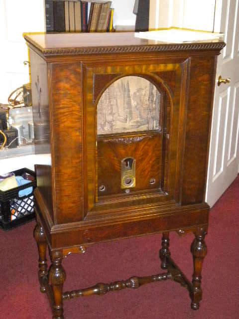

Wow, I thought it was a 95, did they put model 76 chassis inside this type of cabinet? I would of never known, I have $70 worth of parts of a 95 coming to me from eBay right now. Will the audio transformers and power transformer still work for this set? I must say I am kind of bummed, I was hoping for a 95. Well, my main concern is if the chassis is original to the radio cabinet and speaker? Please let me know, thank you Ron and Terry.
Jon
Yes, the 76 was used in this cabinet, as was the 40 (110 volts DC) and 87 (8 tubes):
http://www.philcoradio.com/gallery/1929c.htm#g
In these early years of Philco radios, they often used different chassis in the same cabinets.
You can use a 95 power transformer in a 76 - the voltages are the same - but the interstage audio transformer from a 95 will not physically fit a 76 chassis without some modifications even though they are similar electrically. And the 95 tube shield will not fit a 76.
Unfortunately, this drives home the fact that you should always do your research before spending money on a set. And if the set is a Philco, that research should include the information available at Philcoradio.com . This is why the site exists - to help folks out.
