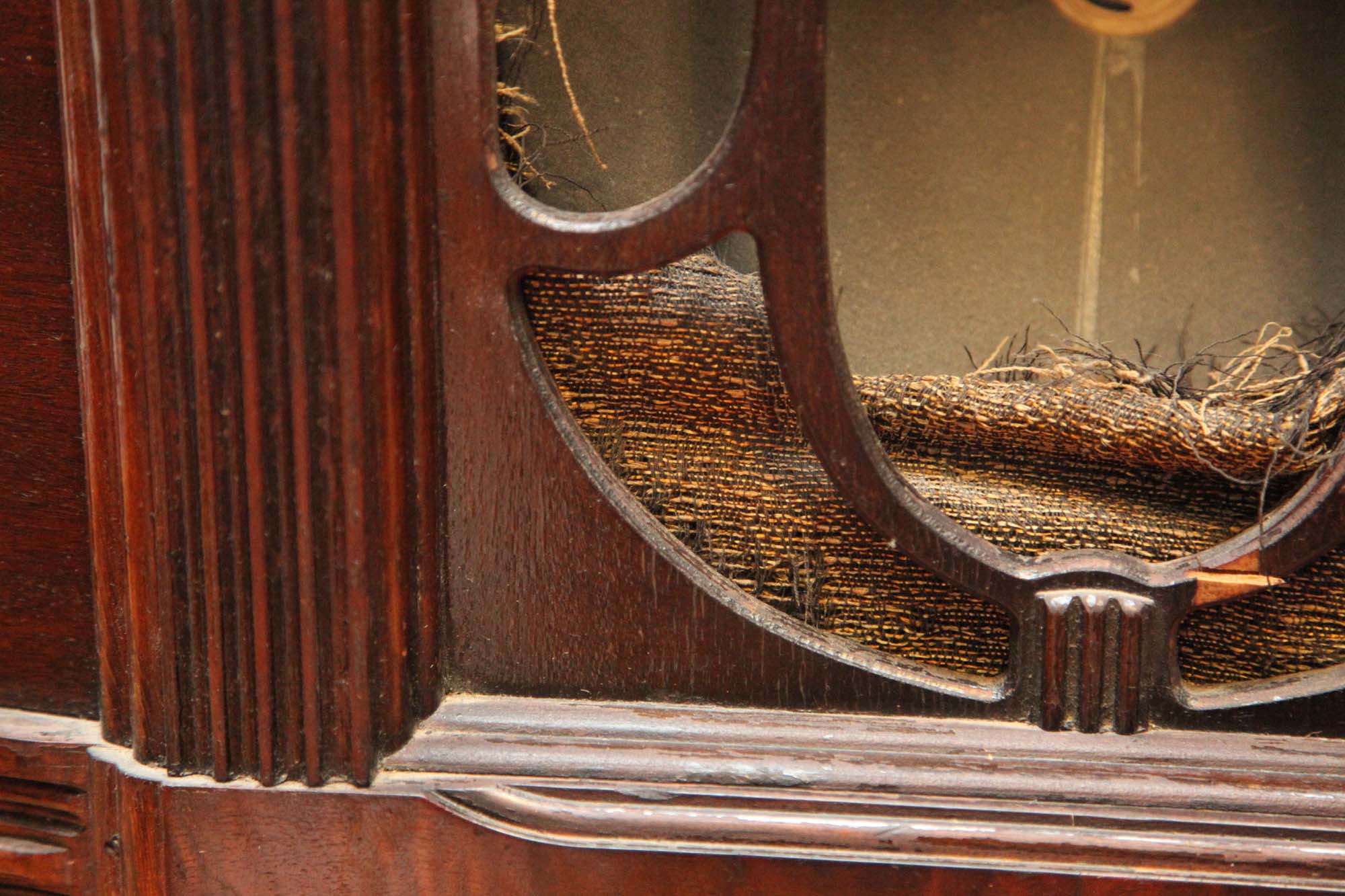

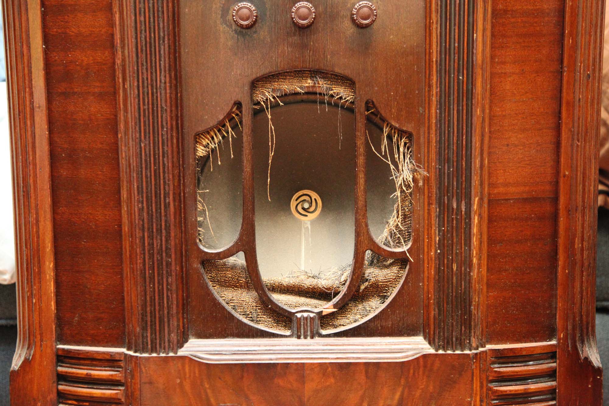

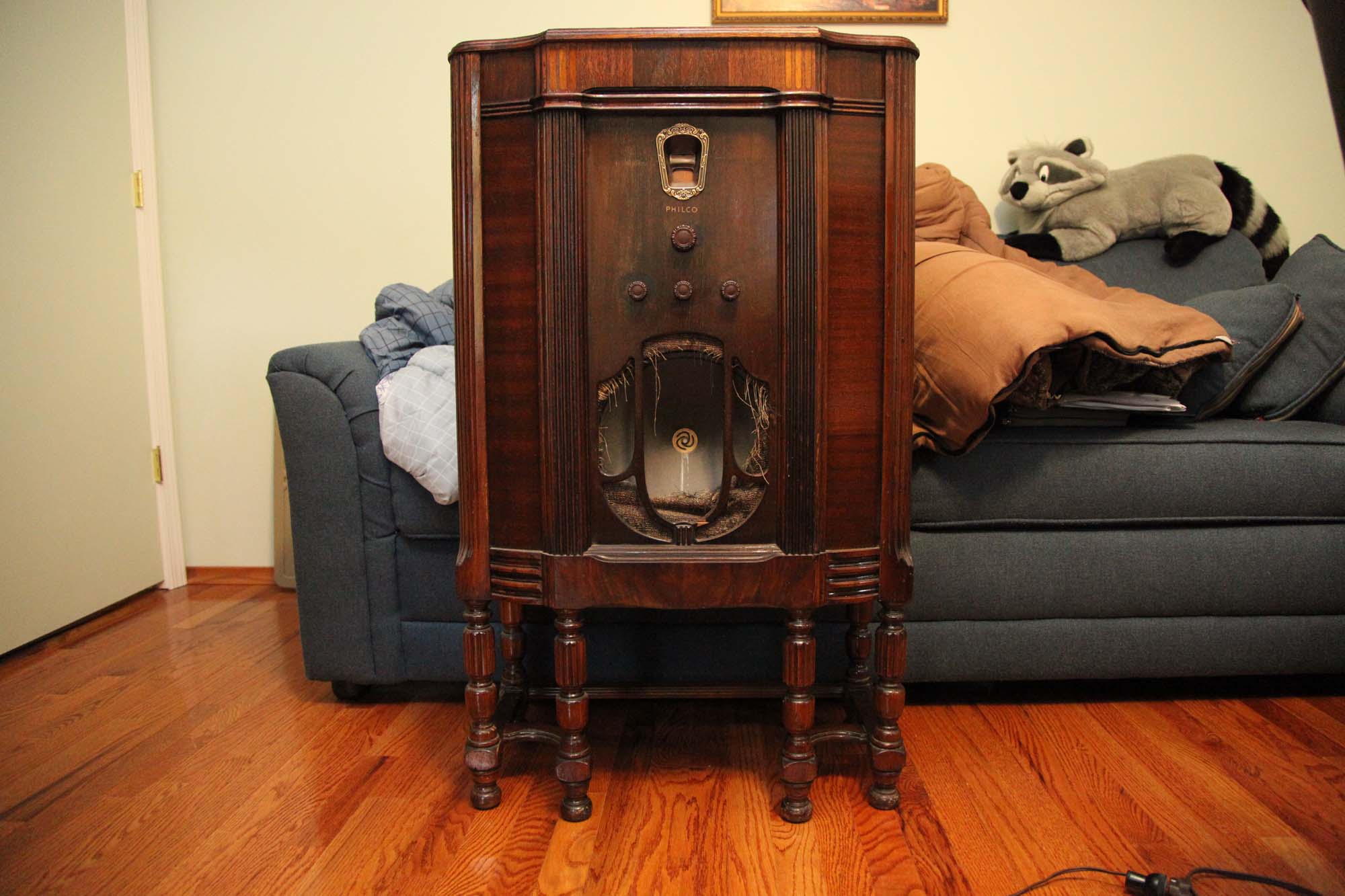

So first thing I want to ask about my new Philco 18 is the cloth.
I know Radiodaze has some selection but if someone know exactly which one it is I could use some advice.
Here are some closeups of what is left in there.
here's the whole thing.
Pattern #40 is close to what was used originally. Not exact, but close enough for gubmint work.
The exact pattern used in your set was never faithfully reproduced. #40 was John Okolowicz' attempt to reproduce the original, but it did not turn out looking exactly like the original.
Now...good luck finding any.
