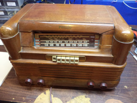

Just got my newest project. The cabinet was in great shape before the post office got to it. The buyer gave me a refund and told me to keep it! This will be my first major woodworking task but I've got all winter to get it ready for lacquer in the spring. In the meantime I'll be digging into the insides.
Wish me luck!

I've said for years that the Postal Service is the worst way to ship a radio, period, end of story.
Clueless eBay sellers who do not know, or care, how to pack a radio does not help the problem.
Good luck with that damage. It looks like the dial scale survived all of that damage, though?

Thanks Ron, the dial scale looks to be the best part so far. The paint appears to be intact.

Good!
I like the look of these dial scales, the sort of 3D effect Philco achieved by painting different parts of the dial scale on both sides of the glass. I own one of these, and my 41-616 also has a dial glass painted on both sides.
