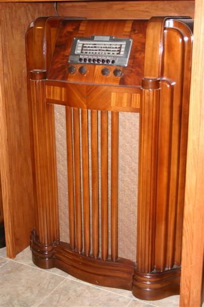

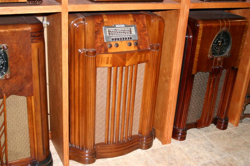

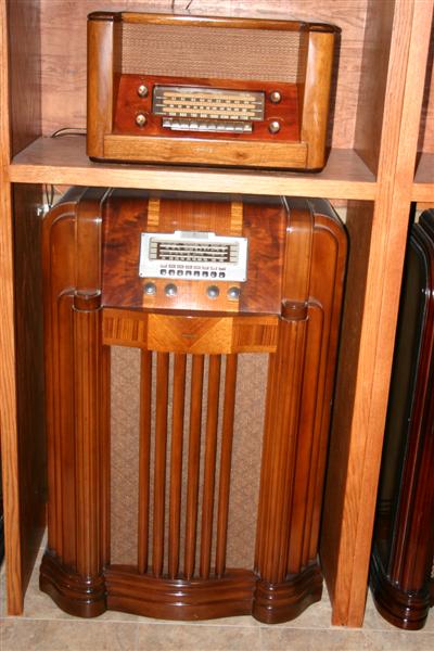

After a lengthy visit to JoAnn Fabrics, I found one fabric that was similar to the diamond pattern. I didn't thoroughly search the drapery patterns because they were clearly special ordered. Since it was a beige color, we tried some RIT brown stain, but the effect was subtle. I ended up using the back side of the un-dyed piece. There were now vertical lines to contend with, but overall I am satisfied. A non-radio person wouldn't look twice at it. Check it out:
with flash:
[Image: http://i191.photobucket.com/albums/z309/...file-5.jpg]
w/o flash:
[Image: http://i191.photobucket.com/albums/z309/...file-6.jpg]
close-up:
[Image: http://i191.photobucket.com/albums/z309/...ile-10.jpg]
Posts: 141
Threads: 13
Joined: Sep 2011
City: moline, il
Hi Dennis-i like the way the GC accents complement the vertical wood bars.
Mikey likes it.
