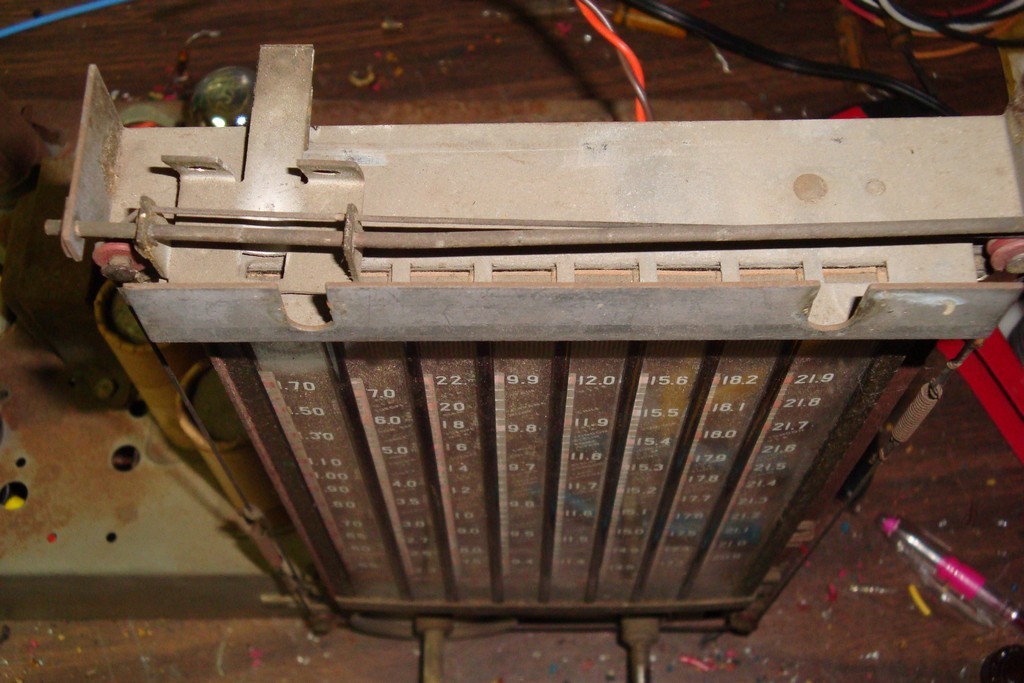

The lamp is used to light the top edge of the dial scale, and is movable so only one of the several scales is lit depending on which band is selected.

OK, allow me to clarify things a bit.
The dial lamp is attached to a movable bracket which slides left or right on top of the dial scale. It is brought into position above one of the eight scales, depending upon the position of the band switch.
These photos may help to illustrate:
[Image: http://www.philcoradio.com/images/phorum..._00001.jpg]
Band switch in AM (Broadcast) position
[Image: http://www.philcoradio.com/images/phorum..._00002.jpg]
Band switch in band 5 position (25 meters)
The lamp must be a miniature size lamp due to the limitations of space. A C7 candelabra will not physically fit.
Now, about the Candohm. It is a two section resistor, 28 ohms (I erroneously stated 22 ohms earlier, I have since corrected that post) and 1020 ohms. The 28 ohm section serves as a dropping resistor for the filament string. The "hot" side of the AC line connects to the junction of the 28 and 1020 ohm sections. At the other end of the 1020 ohm section, originally, was the 14 volt dial lamp; the other side of which connected to the "neutral" side of the AC line. In other words, the 1020 ohm section was in series with the dial lamp.
