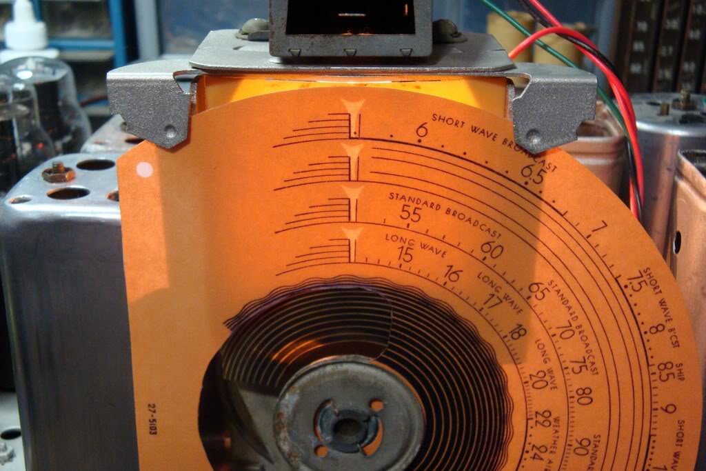

First, let's look at a 650 chassis with a conventional incandescent 55 lamp behind the dial:
[Image: http://www.philcoradio.com/images/phorum...fe856c.jpg]
Looks fine, like a 650 dial should look, right?

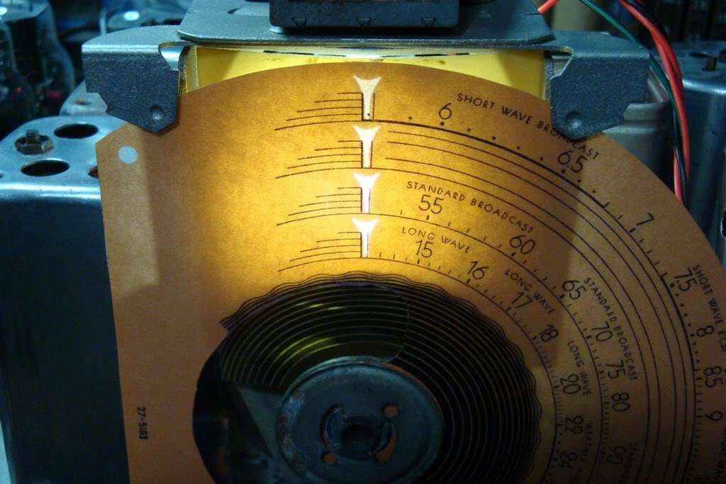

Now, look at it with a 4-LED lamp replacement:
[Image: http://www.philcoradio.com/images/phorum...49a92e.jpg]
Much brighter. With the LED lamp, you can tell this dial scale is a reproduction (made by me).

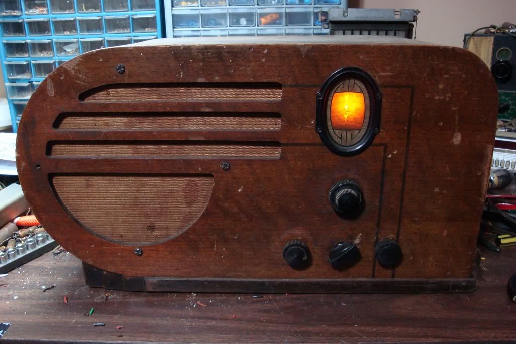

I had wondered aloud if an LED lamp would cause any noticeable RF interference. So, my next test was to put one of the LED lamps in my 610T that has a restored and working 630 chassis inside.
[Image: http://www.philcoradio.com/images/phorum...b4e499.jpg]
Nice and bright. Since this set has its original dial scale, you really can't tell that the lamp is an LED - you don't see the very bright, cool white light, just a brighter dial.
I connected antenna and ground, and tuned it around on all three bands. It was no noisier than usual - the LED did not add any RF interference to the 630's reception.
