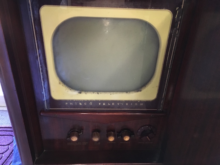

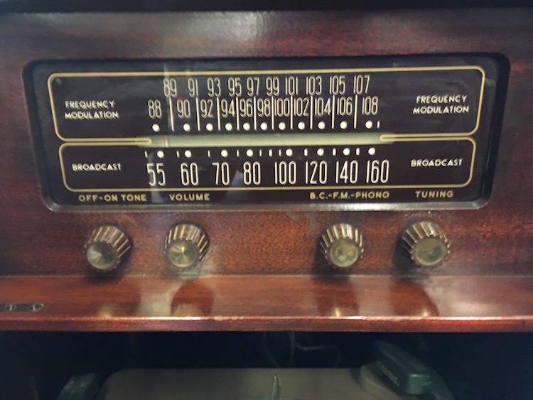

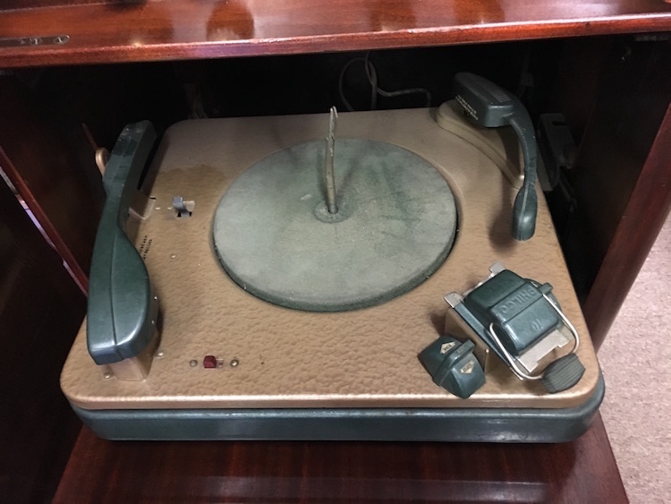

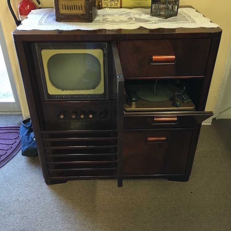

Who thinks I should buy this?
$195.00 but when I asked, he said $150.00 right away...
If the tube's good...possibly. Keep in mind: TV is a whole different ball game from Radios, even experienced folks find them challenging.
Just the high voltage alone....
Looks to be in good restorable condition IF the picture tube is good, and that is a big IF. I don't see any "burn" spots, or the look of a broken seal to the envelope, so it may be OK. It will be a challenge. You will have to do all the same routine as with a radio, total re-cap of the paper and electrolytics, and any out of tolerance resistors, before you even turn it on. Still, it looks like it would be a really great addition to a collection if you can get it working. If I had the room I would be interested myself. It reminds me of the kind of thing I cut my teeth on repairing when I was a kid.
Kirk;
  The first thing that I noticed is that the paint on the back of the safety glass appears to be lifting in several places, the shadow mask also looks a bit spotty, I would want to have a good look at the TV chassis because of this. If you knew for a fact that the picture tube was good I would say maybe $125 at most for it, of course you won't know if the flyback or the other stuff is still good. Early Philco TV sets have issues with the high voltage dropping after the set has been playing for a while, apparently it's an issue with the early Philco Phlybacks. Untested I would say up to $100, just like with radios the big combo units tend to be less collectable then the stand alone TV sets, with smaller table sets being the most popular. Bob Andersen would be the best one to ask about this.
