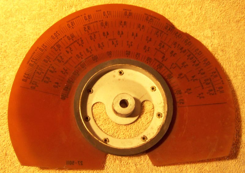

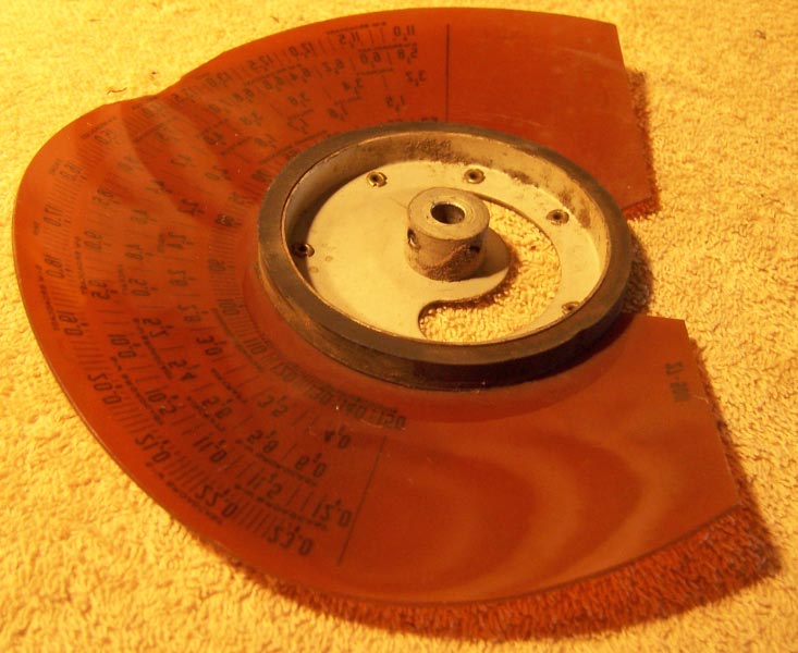

The dial on my Philco 16B cathedral is warped. Mark Oppat says likely due to shrinkage. Unfortunately, Mark is sold out of that dial and cannot obtain the raw materials needed to make more. So I must at least attempt to straighten the dial I have. Any clues as to how to proceed? I prefer NOT to destroy what I have. I assume that I first drill out the rivets holding the dial scale to the metal hub. Then apply heat (heat gun, slow oven???). Then clamp between two pieces of MDF or other flat material, perhaps with waxed paper between the dial and clamping material.
I do have a 16B tombstone with a good dial, for reference.
Has anyone tried this? Any suggestions? Thanks!

Thanks to all for the links. Several look promising. I assume that I must obviously remove the dial from the metal hub by drilling out the rivets. And I assume the dial is initially flat and gets its curved shape from the metal hub. Mark Oppat said that his reproduction dials are made from .020 ga paper phenolic (of course, the originals could have been something else). What I have read so far: BE VERY GENTLE!
