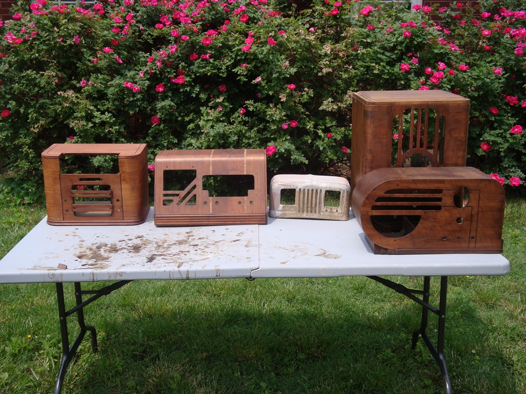

I began work about mid-morning on the 38-2670, the largest cabinet of the lot. Because of its size and its overall grunginess, it took quite a while to get it stripped and clean.
After lunch, I proceeded with the 610T, the 39-330AT, the 41-246, and started on the 41-KR. The white paint is very, very heavy on the 41-KR. Add to that the sun and high humidity...I quit about halfway through the 41-KR and will tackle it, and the other two, later this week when it isn't raining.
Here's what I have accomplished so far:
[Image: http://www.philcoradio.com/images/phorum...dcbcec.jpg]
Left to right: 41-246T, 39-330AT, 41-KR, 38-2670B with 610T in front of it. Four of those five are stripped and ready for the next step. The 41-KR will require a lot more stripping and cleaning.

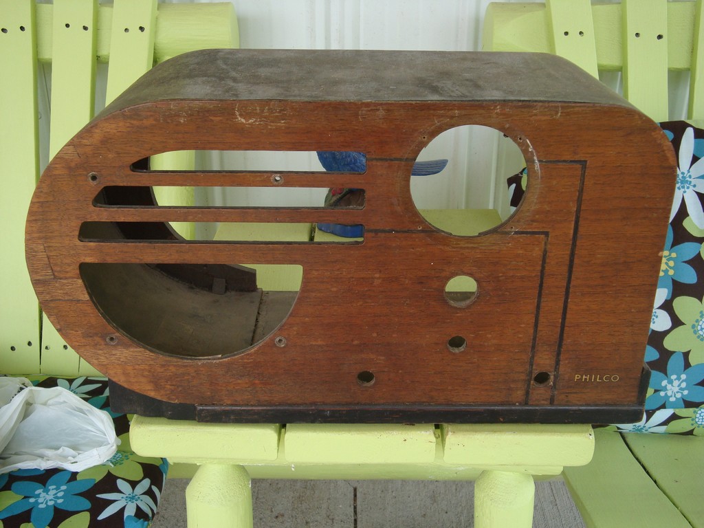

Here is a "before" shot of the 37-610T:
[Image: http://www.philcoradio.com/images/phorum...442717.jpg]

Finally, the 610T...I glued the cabinet in two places where the front panel had separated from the top/side, and glued down two loose pieces of veneer on the front panel using an old iron to speed things along. This is an old trick I learned from John "Hagstar" Hagman. After the glue had mostly dried, I filled those numerous small indentations on the front panel with wood filler. Finally this cabinet, too, received two coats of sanding sealer. The sanding sealer revealed some nice-looking wood on the 610T front panel, in spite of the filled indentations. This one should look pretty good once it is finished.
