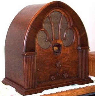

I feel for you brother. 8) Here's a picture of my 90 that met the same fate years ago. But there is hope...2nd picture.
