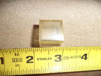

Just brought home a 48-482 and from what I can see in examples from on-line photos there are supposed to be some type of clear plastic cover over top of the brown buttons.  Mine seem to be missing.
A) would someone who has a 48-482 be kind enough to post a close up picture of the clear cover and buttons for me. Do they just slip on over the brown portion?
B) Any idea of a source for them?
[Image: https://www.dropbox.com/s/6pcqo3xzpwg8zz....jpg?raw=1]
[Image: https://www.dropbox.com/s/ha9scio4p8sn5f....jpg?raw=1]
(All these questions and I haven't even blown the dust off it yet Icon_smile )  Thanks for the help!!
I just finally finished my 48-482 and one of the first things I did was locate the covers.
If you email David at Antique Radio Collector: parts2many@aol.com and send him this photo, he should be able to fix you up.

Thank you Eric!! Icon_biggrin I will get in touch with David. I just pulled the chassis out to try and do a quick cleaning to be sure there was nothing still alive inside. Fortunately no mice but pretty grungy and everything rubber is dried and shriveled. Unfortunately it was in the home of a smoker and is going to take a lot of cleaning to get the smell off. I'm sure I'll have more questions when I actually start into it.
