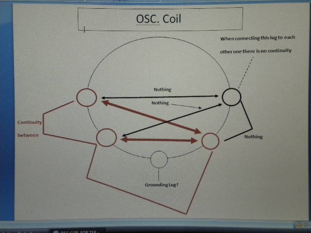

I did test the Osc. Coil for continuity and here is a diagram of my findings. Could I also test the other coils? I know theses early Philco's are notorious for having shorted winding in the coils. Also if I hook up a test signal off a signal generator and connect one side to chassis ground and the other onto the antenna lug could I check to see if I get a signal that way?
Thanks

Hi;
My best guess, is that You are missing or have an open on one of the Coils.. The only way to know for sure is to ohm from each pin on the coil to where it is connected to and find that on the schematic or follow the wires and find where all the connections go.. Make Your own mini schematic and compare that to what the Schematic shows.. That should then make it perfectly clear where you should have a coil connection.. It looks like the lower coil connection is broken.. As you should have three coils and you only have two..

Well I know that I am not missing a coil. At first, right after restoration, I was able to pick up several stations that would come in, then they would disappear and then come back in again. When I put my finger on the grid cap of the 36 tube (Det. Osc.) stations would come in loud and clear. Now if I put my finger on that very same place I don't get anything. The radio only produces a bunch of loud crackles and pops. If I put my finger over the R.F. grid cap or I.F. I don't get anything were'as right after restoration I was able to pick up stations when doing such a gesture.

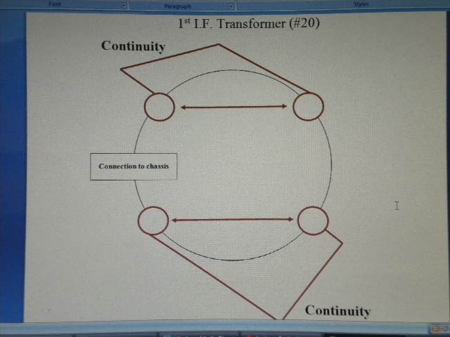

I also tested the 1st I.F. Transformer coil and here is what I got.

Hi ;
I am sorry that I mis-led you.. I was not implying that you were missing a coil, but that the coil had a possible break in it.. The Two upper coils with a common connection which as near as I can tell, connect to C-15 and C-16 .. Seems to be OK.. but the Lower coil, that is attached to the Cathode of the 36 Tube and it looks like R-18 and C -19 is not there, IE, not shown as a third coil.. According to the ohming of the coil form that you have done.. You have two unknown connections on the Coil form.. Check to see If they go to the Cathode on one side and the Capacitor Resistor on the other side, between those two point, You should get an ohm meter reading.. And IF you do not then there is most likely a break in the coil.. And that should be investigated..

I think I found a break in one of the winding on the OSC coil after tracing the 36 K to ones section of the coil. According to the schematic that lug section that the K goes to ends up coming out of the center bottom lug that goes to R18 and C19. The only problem is that I get no continuity between both and when I Ohm it out the reading is in the Meg Ohm where as the other winding in the coil that have continuity test in the 3 or 4 ohm range.
Here is a diagram below to show what I mean. Thanks

Most of the time the winding that is open it is the small winding on the outside of the osc coil. This is the feedback winding. If this is the case you can rewind it yourself. Two thing you will need to know. How many turns is it? Usually 20-25t. And the direction it is wound.
Remove the old winding. Wind new winding in the same direction as the old. The original wire was 38G this is not very critical. Any thing from 32 to 40G will work fine.

Terry, you nailed it, it is on the outside of the osc coil. There are actually two paper tubes. The lug I am getting no continuity on is the lug on the outer tube.
