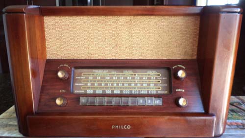

So now that I'm finally finished with the first one:
Now to start on the 2nd one. With all the issues I had with the first one, the next one should be a piece of cake!
Eric
The Villages, FL

Thanks, it was my most extensive project to date.
Eric

Very nice looking radio! Good thing you didn't ask me what "zero beat" meant. I thought that was what you had when you upset the drummer and he quit the band!!! Take care, Gary.
