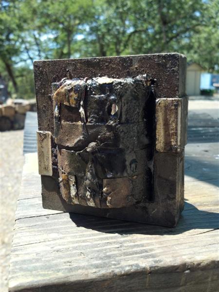

I'm hoping there may be some fine folks here who have restored an Atwater Kent Model 40 and could help a novice like me with a few questions. First and foremost is the power transformer. Judging by how brown and cracked the tar is inside the case on the left hand side (opposite the wire loom), something has burned up deep within. Does anyone have any pictures of what is down below the tar in the 3 sections of the transformer? Or could give me an idea of what is the best method to go about finding what's down there without damaging things further? It would be most helpful knowing what I'm looking for and the general area it's located in, so if anyone has taken pictures as they restored one of these transformers, that would be fantastic!

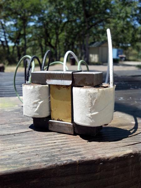

Transformer left side

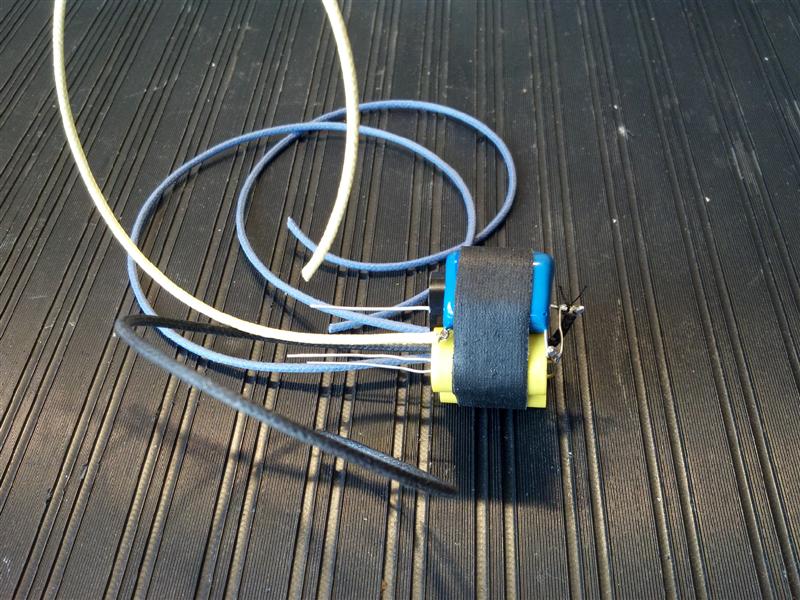

Choke crnter
Choke center

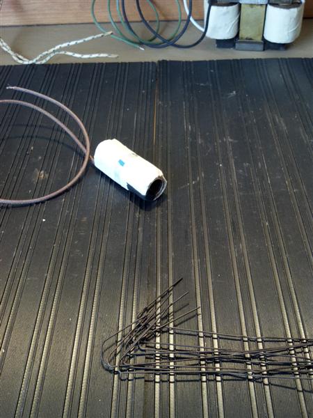

New Caps right
Thanks for the great pictures! Most helpful in at least knowing what I'm up against. I sent you a message at your radio repair website regarding this set.
