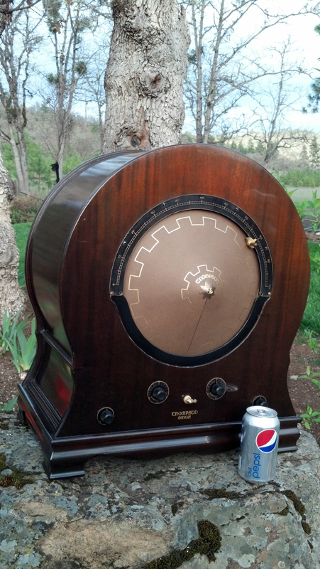

When there are irreplaceable decals or other features, a finish restoration is the only option, rather than refinishing.
Could not seem to find a Thompson water slide decal.
Pepsi can was for perspective. (tis' a big radio)
No Howards was used on this. I have used GoJo, to clean my hands. I have some tung oil, but I don't know why.

What an incredible looking radio, Phlogiston! Is she a good performer? Icon_thumbup (and what year was she "born"?).
It is a Thompson Minuet from 1925. It is about average for a 20's TRF.
Its notable points are single dial tuning, though you do have to fine tune the 2 other rf stages and all batteries stored internally. It was designed to be a simpler, easier to use radio with no external batteries to look at and no need to add a speaker. Great Idea. I guess they did not sell a lot of them.
very sharp looking radio can we see in back?
WOW alsome no cords all linkage movement ? great find
