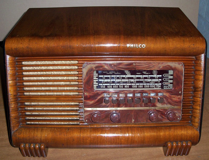

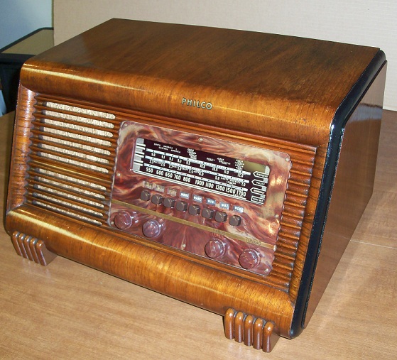

I was able to salvage the original finish on the cabinet, except for the outer edges, which were so badly gouged that it needed refinishing. Not being able to find an exact match, I went with a dark tone similar to what is used on the edges of my 39-30 slant front table model. Not factory authentic for '41, but the more I see how it looks, the more its grown on me.

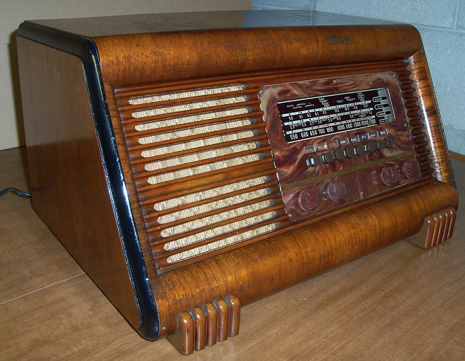

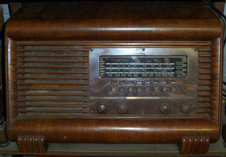

The dial face, knobs and pushbuttons are all exact repros (although I think the dial face has a bit too much marble effect). Here's a before pic (I already had installed the repro dial face when this photo was taken a few years back):
And a few after shots:
