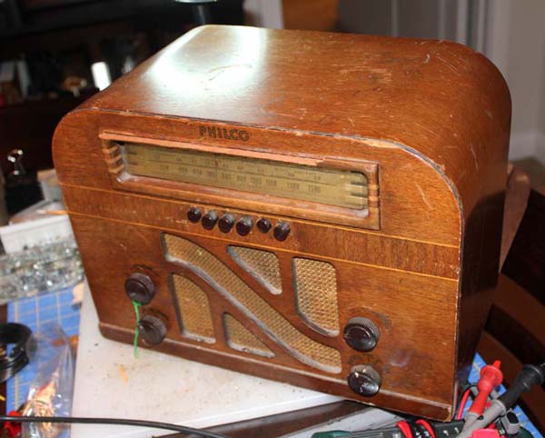

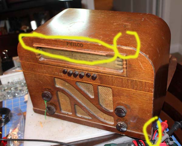

Here is the victim. A Philco 40-145 I picked up at a flea market. The major problem was the wooden surround on the dial. Most of the top was missing. There were also issues with the veneer. Pieces were missing from the top right above the dial, and on both sides. The bottom right was a pretty big chunk that was gone. Also, above each push button, the veneer was gone.

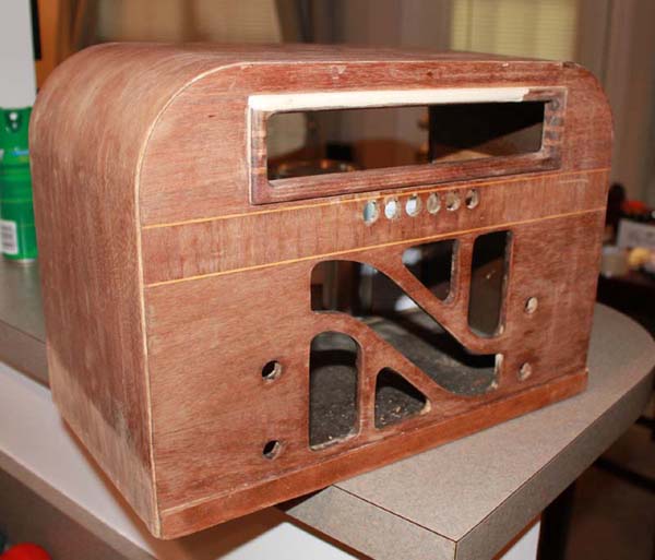

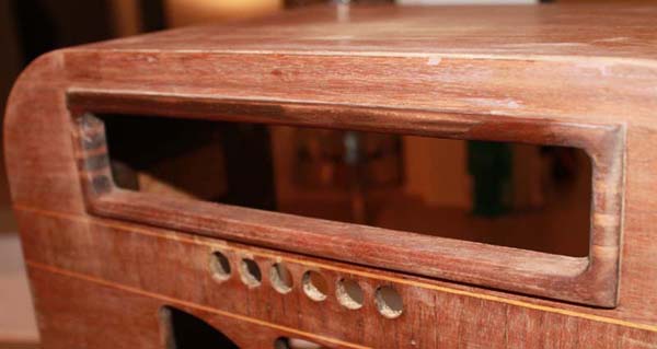

After stripping the cabinet, I started off by gluing a piece of 1/4" x 1/4" inch wood stock onto the dial face. It was fairly soft wood, and the photo shows I have already sanded it into the rough shape needed.

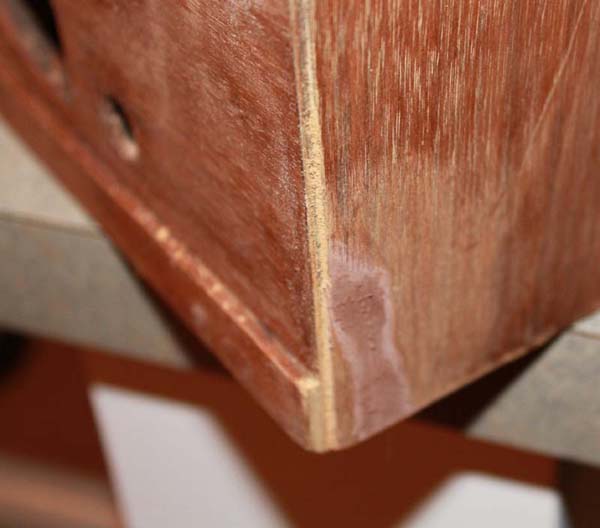

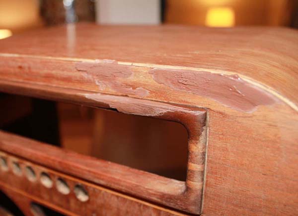

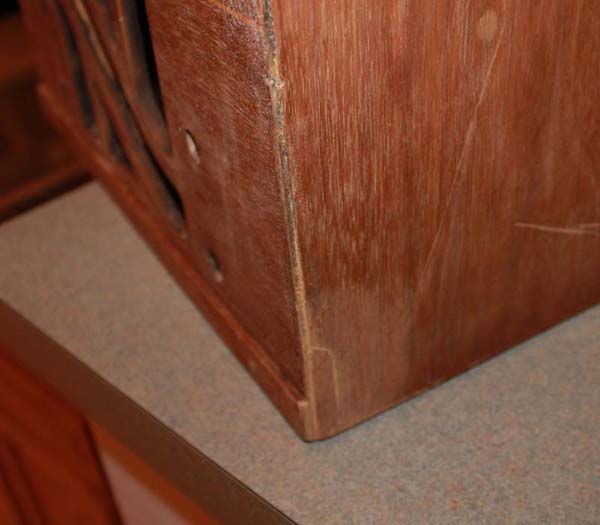

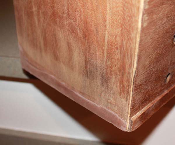

Veneer scraps were cut and glued into the missing areas. I also did the places above each push button and the face of the radio. After the glue dried, 400 grit sandpaper was used to even them up with the surface of the radio.

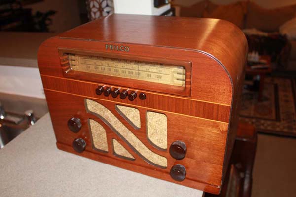

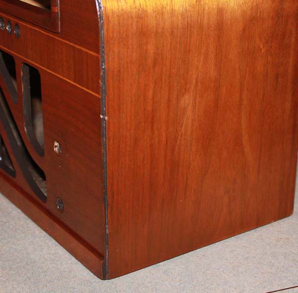

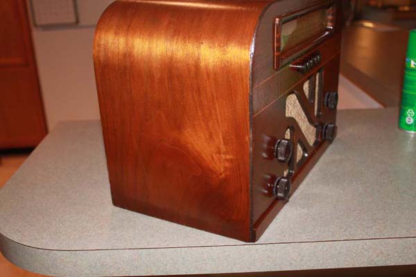

All finished and singing a 40's tune! Please ignore the light area on the bottom photo - my camera does that. I assure you, the finish looks fine in real life.
Is it perfect? Nope. But it's good enough for government work. I wish I had used a lighter colored stain on the new wood, but it is what it is. Next time, I'll know better.

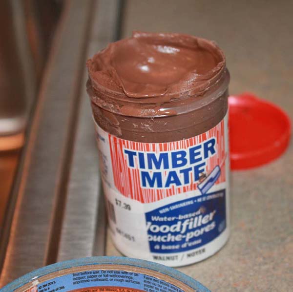

You can see how well Timber Mate works. The repairs on the veneer are virtually invisible. I am very pleased with the veneer repairs. As for the wood around the dial? It's the best I could do and I think it came out well. It shows that almost any radio can be fixed.
