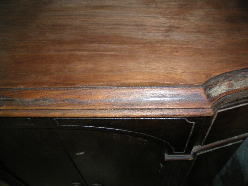

Started working on this cabinet in earnest this evening. Am posting pics of what I've managed so far.
First, the missing veneer from the top:

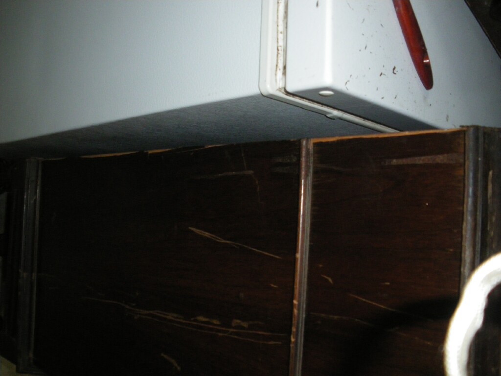

The left side, looked pretty ugly to start with. Note the deep scratches.

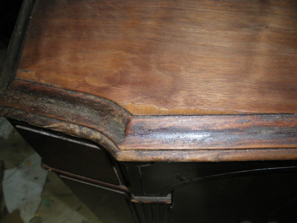

The cabinet partially stripped and sanded.

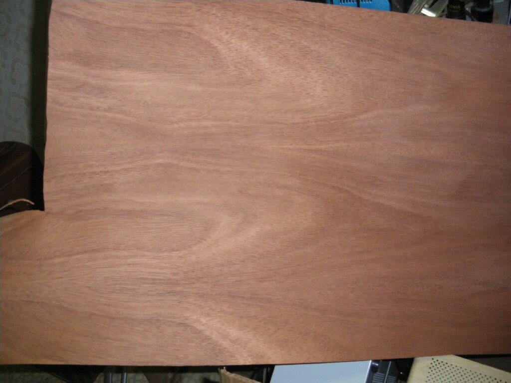

This is the veneer that I have here to work with.

I'm no expert either, but I'm better at refinishing than I am at chassis work. I'll tell you what I do, but other people might do things differently.
Do you have an old, beat up, scrap radio cabinet that you can salvage veneer from? I find that old pieces are easier to work with. If not, no big deal. Cut pieces of veneer to fit into the missing spots. I've used a pencil and paper to make a tracing of the missing area first, then use the pattern to cut the new piece. You want the grain to run in the same direction as on the radio. Try to get an exact fit, if possible. Once you are happy with the new piece, use wood glue and glue it in place. Use a clamp or heavy weight to hold it down if needed. Let it sit for 24 hours..
Once it's dry, trim any overhang, then take a sanding block and some 300 - 400 grit sandpaper and sand the new veneer (with the grain), until it's level with the veneer on the radio. Once you start getting into the old veneer be careful. Don't want to sand through it.
I personally try not to sand the old cabinet any more than necessary. The wood has developed a petina and sanding removes it and can make the final finish look uneven.

It's a tough call to make without seeing it in real life. Unless I'm going to totally re-veneer a very large area, I don't like the paper backed veneers. I've found that most radio work is just patching in small places where veneer has chipped off. For that, I like the new veneer to be a little thicker, or at least as thick as what is on the radio. If the new veneer is a little thicker, you don't have to sand the old veneer much to get a match in surface height, does that make sense? The paper backed veneer I've seen is very thin. That's why I like to strip veneer off of old, scrap cabinets.
I am assuming you are just planning to patch the veneer on that radio.. so
if I were overseas, and If I had to order some for the radio you are working on, I'd get this..
http://www.ebay.com/itm/Walnut-wood-vene...0970144399
It's a nice piece of walnut veneer and should provide a lot of wood to fix typical chipped cabinets. The color is dark enough to blend in with most old wood with years of patina. If I've got to have a mismatch in veneer color, I'd always prefer the new piece be a little darker than the original. I find it's easier to hide the mistake when it's dark. A lighter color really stands out like a sore thumb.
If you are going to re-veneer a large area, then I'd look at the paper backed, iron on veneer. If you are ever at a flea market and see an old table or cabinet with peeling veneer for sale cheap, buy it. It's great to be able to just go break off a small piece when you need it.

Judging by the photos what the cabinet originally had was a plain cut French walnut veneer. There are some guys on fleabay that sell it in assorted quantities, lengths and widths, but there are plenty of mail order houses that have it as well including Constantines. It would probably be best to make a straight line patch parallel to the grain where the veneer is chipped out, it's easier then trying to cut and fit a smaller patch to fit the chipped out area and a lot easier then trying to reveneer an entire panel.
