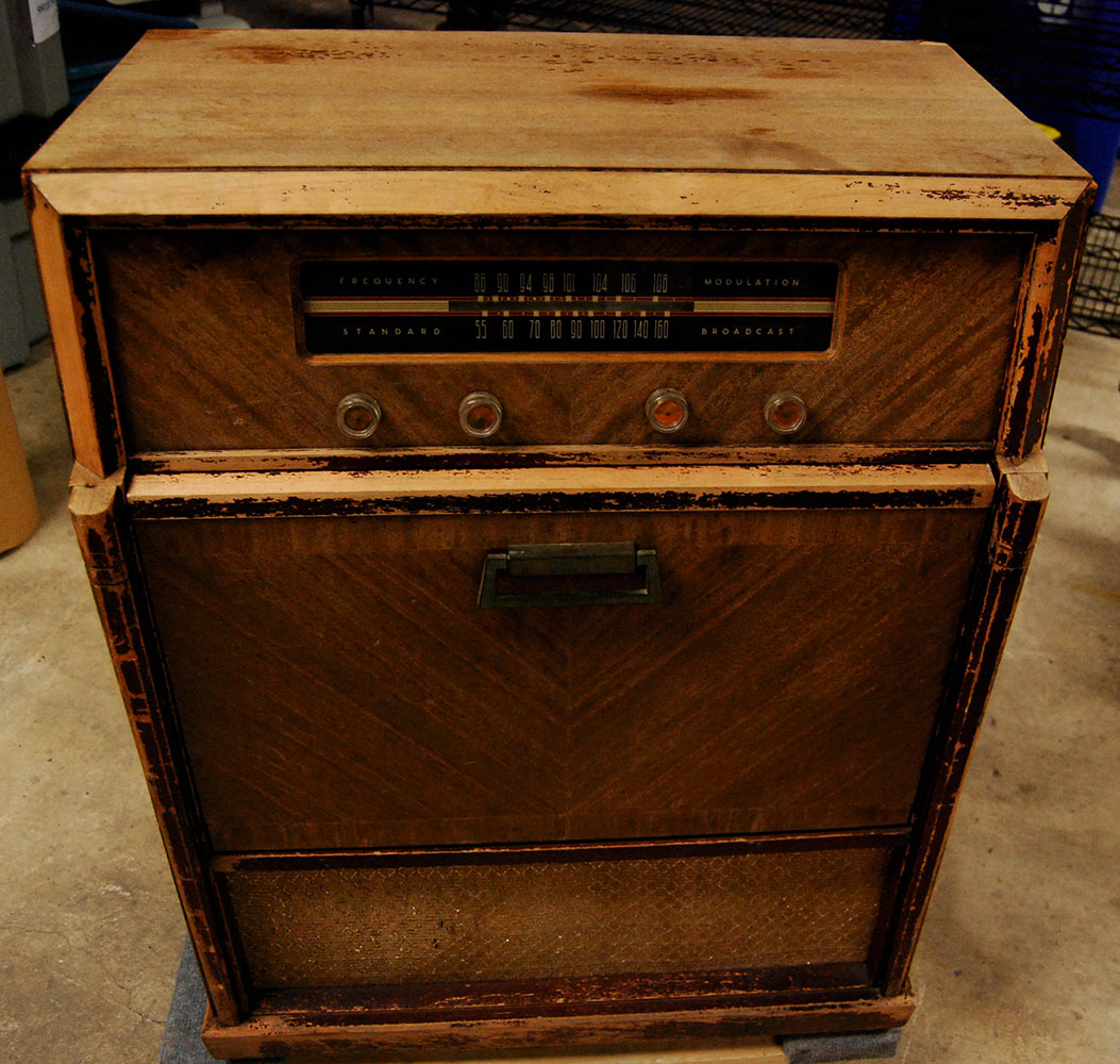

I've got a 51-1731 (AM/FM/Phono) that works. The veneer is pretty beat-up, the wooden edging is almost down to the bare wood and there aren't any labels over the control knobs.
[Image: http://www.scottssweaters.com/images/per...-front.JPG]
There's a brand new left over sheet of mahogany veneer laying around my shop, and I was thinking of simply applying this new veneer over the old and bringing it a nice new luster.
Questions:
1. In the world of radio restoration, would it be considered sacrilegious to replace the old veneer with new?
2. If anyone has a closeup showing the control knob labels, it'd be helpful to know what they said and how these labels were applied.
[Image: http://www.scottssweaters.com/images/per...3_dial.JPG]
3. As I began to break-it-down, it seems the interior shelves are supported by wooden brace board that were glued to the side panels. So I'm thinking I'd need to break these bonds to disassemble the side and top panels. Does this sound about right?
[Image: http://www.scottssweaters.com/images/per...k_open.JPG]
4. On the slide-out phonograph, opposite the playing arm, there's a pivoting arm atop a mount. My best guess is that this arm applied pressure to stacked records as they were waiting to drop, thereby keeping them from flopping around. Is this guess anything close to accurate?
[Image: http://www.scottssweaters.com/images/per...oto_CU.JPG]
5. Any idea how these wooden trim board around the front were finished originally. They seem to have a deep mahogany color paint that's since mostly fallen away. Yet I have no idea if this is how these trim boards were originally finished, or this is something applied later.
[Image: http://www.scottssweaters.com/images/per...front2.JPG]
5. The tag notes not only the model number, but "Code 121" as well. I'm curious what this code indicates.
[Image: http://www.scottssweaters.com/images/per...-lbael.JPG]
Thanks,
Scott

On the two vertical solid wood trim pieces along either side of the drop-down door... near the top of these trim pieces there are two narrow bands that appear a goldish color in a phone I found online.
Anyone know if these bands were painted gold or gilded or whatever?

I've already answered the break-down question. Indeed, they used a lot of glue to attach those veneer panels to the framework, along with a smattering of wood screws.
Had to separate those bonds using a putty knife and a hammer.

I've identified most of the control knob ID questions, except three:
1. The third knob in from the left seems to read: "__ - FM - PM" I can't read the first two characters. It looks a little like "3G," but I doubt it. In this position I'd be expecting to see "AM." While I can't read what it says, it certainly doesn't look like "AM."
2. With the same control knob, the last position appears to be "PM." I'm assuming that was for the phonograph, but why "PM" and not "PN" or something more representative of "phonograph, given that there's no "m" in "phonograph?"
3. The first knob is "Off - On - Tone." What function did the tone position perform?
Scott
Key West
1. What you are seeing is, most likely, BC - FM - PH. Where BC = Broadcast, short for "standard broadcast" - what we now call simply AM.
2. See above, plus I really doubt it says PM - may be difficult to read, but I really believe it says PH (for Phono or Phonograph).
3. Not to be a smart aleck, but it functioned as a tone control. In other words, it would make the brights appear to be brighter or the low tones seem to be lower, depending upon its setting. It didn't actually boost anything - it made the high notes seem higher by cutting the bass, and made the low notes seem lower by cutting treble.

OK, thanks.
Ahh... "BC" I can see that. Just hadn't ever heard that term before in reference to AM. (Learn something new every day.)
I'm guessing the tone would have been used to switch back and forth while listening to either music or speech, for whatever was the most suitable tone.
When I put the supposed "PM" under a magnifying glass... all I can see the vertical sides of that letter, so it probably is an "H" as opposed to an "M."
Thanks Ron.
Scott
Key West
