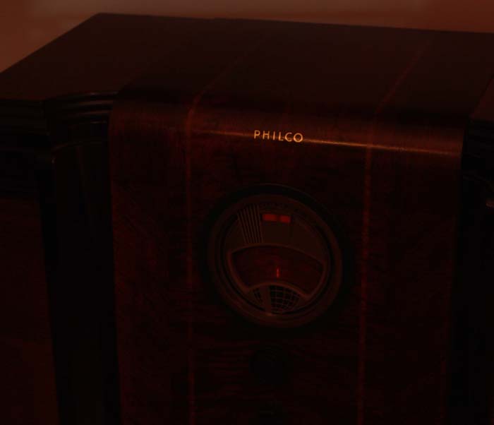

I installed the chassis, then adjusted the shadowmeter as best as I could. The metal disc that is loose is for sure the magnet. When it drops out of the housing, the meter stops working. When I push it back in, it springs to life again.
This photo is the meter dialed to my home transmitter. Signal strength is medium, some local stations are stronger. I have a six inch wire connected for an antenna.
Should the shadow be narrower?
Should I glue the magnet in place?
I don't know much about shadowmeters and I feel like I've done ok just to get this far.

One weird thing.. The radio has been playing for 4 hours now and it seems like the meter is somehow getting stronger. The shadow is narrower and it's responding a lot quicker now.

Remember, the shadow meter responds to RF and IF tube plate current fluctuations due to being tuned on-staion and off station signal strengths. The better the set is aligned, the greater the AVC voltage that influences the grid bias on those tubes and subsequently the plate current draw on the B+ line through the shadow meter (in the B+ line). Depending on the strength of the bias magnet in the about all you can ask of a 60-70 year old permanent ring (C-shaped) magnet in the shadow meter.
DO NOT EVER SPRAY WD-40 IN THERE. Maybe a teeny-tiny drop of watch oil - very light type at the pivot points.
Usually you don't have to lube at all, unless there was corrosion at the pivot points and subsequenly cleaned. If the pivot holes are good,
I woul not lube at all, if it's freely moving with a puff of air.

I think there is a misunderstanding here. The vane is not stuck. It moves freely. The coil is stuck. I can move it, but it's very difficult. It jumps from one extreme to the other, making fine adjustment very difficult. I was asking about using WD-40 to free up the coil. Would this be ok? If not, what is the proper procedure for a stuck coil?
Also, the magnet is loose. It falls out of the back of the coil very easily. Right now, it is just pressed in there, but it will fall out again if the radio is moved. Would it be ok to add a drop of glue to the magnet?
The meter is actually working well now. Yesterday, I listened to it for several hours...As night set in and signal strength increased, the shadow narrowed considerably. Thank you for having a great site. Without the info on your site, my meter would not be working at all.
