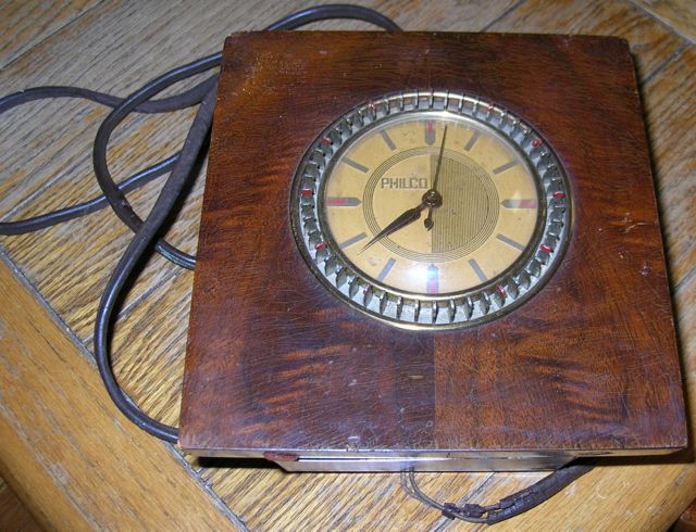

Just wondering if the original power cords can be restored or if anyone even does that? I realize the older cords are not anywhere near as safe as the newer versions but a properly "restored" one would look so much more appropriate with AC powered vintage electronics. I just bought this clock off eBay and the cord needs work or replacement. What do most people do in this instance? I'm relatively new to the Phorum and searched the threads but couldn't come up with anything. If there is info on this topic, a link would be greatly appreciated! Thanks much!

Since this is obviously not a "cloth-covered" cord, I don't what the responses you've gotten so far have to do with your post. If the rubber is not too stiff or cracked, why not just cut off the short section where the insulation is missing and reattach the cord to the clock? If the rubber is too far gone (doesn't appear to be from the photos) there are contemporary cord sets that would be a very close match. Perhaps the only difference would be a polarized plug molded to the cord.

Thanks to everyone for all of the great responses so far! This particular cord appears to be rubber over top of cloth covered wires. The worst part is at the back of the clock. As Radiodocs suggested, I may just cut out the bad and splice the "fresh" end onto the clock as the rest of the cord is in decent shape with minimal cracks and no separation. Thanks again for the assistance!
