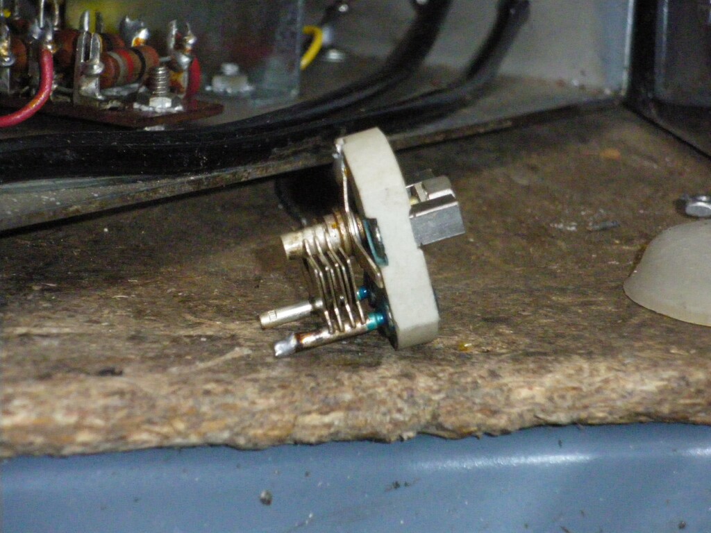

Found the SW problem with this tuner today, basically completing troubleshooting and all but completing repairs.
Turned out to be the trimmer cap for the SW band. It's one of those frame type caps, and the plates were all rubbing, so shorting out the LO.
Nearly drove me nuts trying to find the trouble on this one, these type caps don't generally have those sorts of problems, especially when they're pretty much covered up. But, shorted it was. When I opened it up all the way, the LO came to life.
I've got a temporary replacement in there just to make sure that I could properly align the band, which was pretty simple except that my temp trimmer is a much higher capacitance than the original and so very temperamental to adjust.
I've PM'ed Norman to see if he has one I can buy. But, I guess I can say now that I have a working set of 800B chassis, soon to have a pair of them. Icon_smile Guess now I have to start getting creative about a cabinet for at least one of them.
Sounds like you moving right along Brenda. My first 800B had two of those caps closed, killing the FM. It appears that the someone tried to adjust them using the nut and not the screw in the middle of the nut. The nut is a compression type and not threaded. Both air caps had to be removed to press the nut back on to hold the plates in proper alignment.
