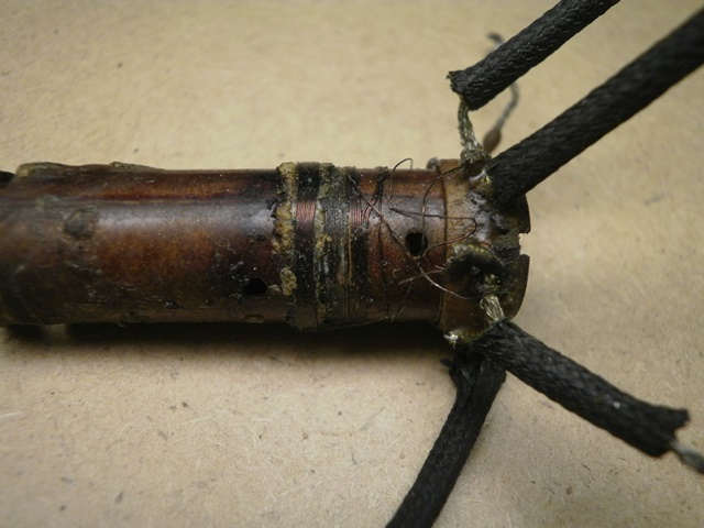

Well one of the oscillator coils was bad in a 37-690 I have, so, a few weeks back I was bored and decided to dissect and repair the RF sub-chassis. I know, I know, some of you think a hole in your head would be better. Well I must say it was not as bad as I thought, considering this is the first one I have ever taken totally down before. Maybe ignorance is bliss!
I decided while I had the RF chassis out to replace all resistors out of spec, and replace any other caps missed from a previous repairman’s attempt. The RF chassis was really dirty with a lot of grease and grim all over down in the bowels of the contact switches. Since I plan to use this daily, I decide a good cleaning was in order. So I took each section completely down, cleaned and reassembled it. I mean I had already removed the RF Chassis so why not.
Well I did each section. Testing the coils and contacts as I went, I found the offending oscillator coil and replaced it with a good one from a 37-116 parts chassis I have laying around. The oscillator coil suffered from the dreaded green wire disease, maybe someday I may try to fix or rewind it, when I get real bored.

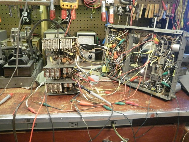

After I got the RF Chassis all back together, tested each stage with a signal generator and tracer, found a couple of miss wired coils on my part. I decided to see if I had ruined my radio forever. Well it works, and works well. I will put it back together; check out the rest of the chassis and power chassis. Repair the clarifiers and call this one good.
I figure a picture of how I tested the RF Chassis would show how crazy I am.
Enjoy

That is funny. I had never thought of hooking one up while disassembled. That would certainly have helped on the first one I worked on.
Was the 2nd band osc coil open? It has been on every one I have worked on.

Yeah the primary is open. I peeled back the beeswax and removed the green corrsion to try and find the break. I found one but it looks like there is more.

Just kidding, but you are far braver than I. The coil: Doesn't look that nasty from the picture, someone may have rewound one and might chime in.

Great work. This isn't an easy task, but it is easier than it looks and worth the effort. I tore the RF sub-chassis out of my 37-650 because I was bound and determined that every cap in the radio would be replaced. However, it never occurred to me to test it BEFORE putting it back in! It worked just fine. You did a great job, be proud! Joe

Wow! Great job. What a good idea to test the sub chassis before putting it back together.
I don't know if I have that many test leads

Nice job glad to see that it can work with the RF section out of the chassis and the interconnections aren't super critical in terms of lead length.
