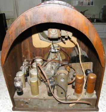

Any suggestions on how to clean up the chassis on this Philco 91 cathedral? Thanks, Charlie
Charlie, I'm no expert and others will surely offer their thoughts that are specific to the 91 but here are the steps I've taken.
- After I get the chassis out of the cabinet I start dusting off the larger pieces of crud that have accumulated with a small brush. Some folks use compressed air to blow things off.
- I pull all the tubes, (i'd check them at this point if I had a tester but I don't), clean them with a paper towel and isopropyl alcohol, clean the tube pins with fine sandpaper or a nail file, and then store them away until I'm done recapping. I clean the sockets with a little deoxit and a wire.
- Next I'll start taking the dirt and grime off the chassis with Q-tips & paper towels using isopropyl alcohol.
- After that I'll decide how much farther to go depending on the shape its in. A little rust gets naval jelly treatments until its gone; lots of rust and I've stripped the chassis components, taken all the rust off with naval jelly plus some mechanical abrasion; primed and painted the chassis (lots of discussion in other threads on whether to do that or not). Tuning cap, power transformer etc., tube shields get cleaned, lubed as needed. Simichrome or other metal polish can be used particularly on the aluminum cap cans if you like the polished look.
---> Icon_exclaim Check out Bob Andersen's Youtube on Chassis Cleaning @ http://www.youtube.com/watch?v=AYLk5oQKvNA
If I have no rust I use Windex. Works just fine. Isopropyl alcohol also works fine.
if the dirt is stubborn and cannot be removed by either one I found out the Naval Jelly takes care of it and at the same time brightens the chassis. Just try not to let it get to the wiring.
I might also suggest when cleaning chassis I always use masking tape on the tube sockets to keep any liquid out of them. The construction of those sockets lends itself well to liquid working its way between the wafers. A real no-no especially on the rectifier with HV AC. I have smoked a couple sockets. Naval jelly will guarantee smoke if it gets inside.
