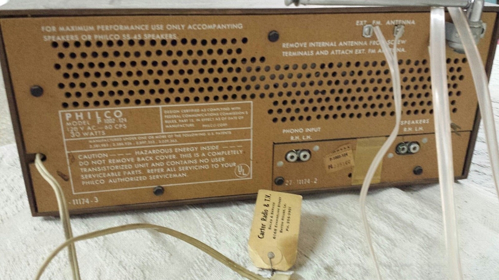

Two quick photos from the eBay ad:
[Image: http://www.philcoradio.com/images/phorum...1002-1.jpg]
[Image: http://www.philcoradio.com/images/phorum...1002-2.jpg]

Flea powered (the output transistors are just as tiny as the other transistors in the set), and the real kicker...designed for use with 32 ohm speakers.
So...my question to you is...what do you do when you have a pair of 8 ohm speakers and a receiver designed for 32 ohm speakers?
Never mind the low output power...had I known at the time that this receiver was intended for use with 32 ohm speakers, I probably would not have bought it.
Three more pairs of 8-Ohm speakers?
Not many good options for using normal speakers. Requiring 32 ohm speakers was how they could use tiny output transistors without exceeding their low current ratings.
You could connect a 24 ohm resistor in series with each speaker to protect the output stage from over current and dissipation, but unfortunately you will lose 75% of the audio power in the resistor. It certainly won't play very loud.
You also might try a step down transformer to match impedances, but finding something useable might be a problem.
Another possibility would be to use the Philco's outputs to drive an external audio amp capable of driving 8 ohm loads. In effect the receiver would become a tuner-preamp and the output would only be limited by the capability of the external amp. This would most likely give the best quality audio, overcoming the limitations of the flea power internal amplifier.
Ron, if your speakers are two way (woofer and tweeter), pop them open and see how they are wired. If you have a 16 ohm tweeter and a 16 ohm woofer wired in parallel to get 8 ohms, just rewire them in series to give you 32 ohm.
