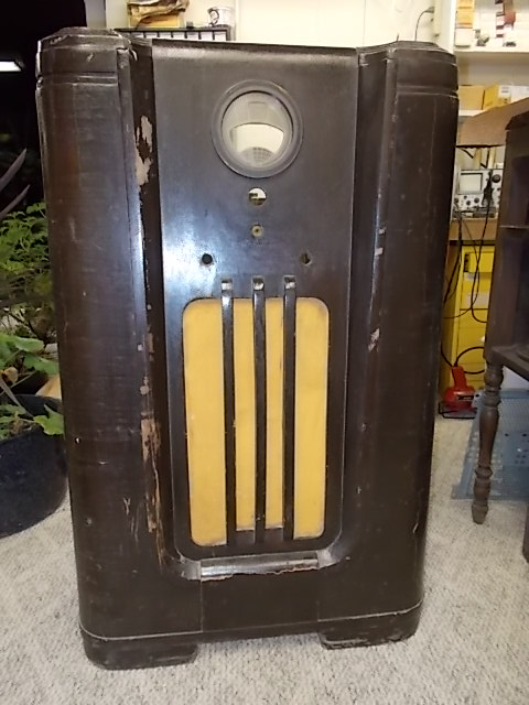

Finally some pictures of my 37-650
First the cabinet. Can anyone tell me
if this is the correct grille cloth? somthing
tells me it was changed sometime in the
past from the original.

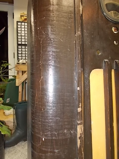

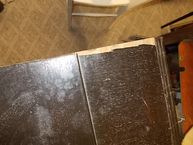

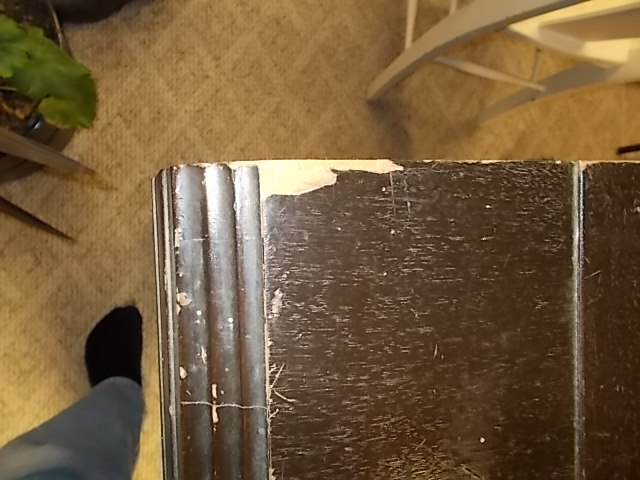

I will now comment on the pictures uploaded
in the previous post:
I see some cracks on the curved pieces of veneer
(both sides). I am going to have to research how
to repair these.
Also there are two smallish pieces of veneer
missing on the top.

Final post for tonight:
I just did some searching and it looks like my
cabinet has been stained or painted or something
all one dark brown color!
I had no idea what they are supposed to look like
but after seeing some pictures on this Phorum
and also other places online I see that mine
has been worked over before.
I will have to see if I want to try to restore
this cabinet or not.
Maybe I'll just get the chassis working and
put it in the cabinet and call it "done".
Herb S.
I was about to say that: the way it peels it looks like it was painted or something of the sort, the color is just hideous.
Well, you are not thinking of salvaging the color, do you? I think it all has to go, and then all has to be refinished from scratch.
