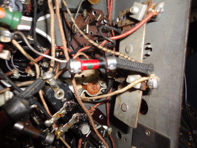

I checked tube socket voltages and Im only seeing 100v on the 36 oscillator plate. Other voltages seem reasonable. Im not the greatest at checking coils, but im finding "sets" of pins on the Antenna, detector, and oscillator coils that add up to close to what the schematic says. 2nd IF looks good as well. Antenna post to chassis ground = 27 ohms.
However, I cannot find the secondary winding on the 1st IF transformer. There are two compensating capacitor trimmers on the back wall of the chassis.
Measuring between the top and the bottom terminals of the IF primary yields 55 ohms- good. Measuring between top and bottom terminal of the IF secondary shows open/high resistance.

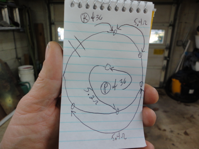

Heres what Im seeing on the oscillator coil. Reading clockwise from the top:
pins 1 & 2 = 5.4ohms and cont
pins 3 & 5 = 5.4ohms and cont
K of 36 tube connects at pin 1
P of 36 tube connects inside coil and shows up at pin 4 of coil with 5.2ohms and cont to 36 socket plate pin
This says to me that the osc coil is probably not the problem. The 1st IF trans probably is.
Yes, I would agree that the osc coil looks ok as the resistance readings are exactly what they should be.

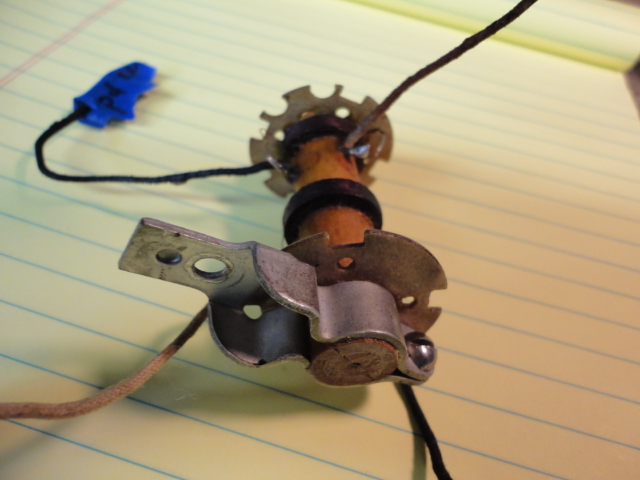

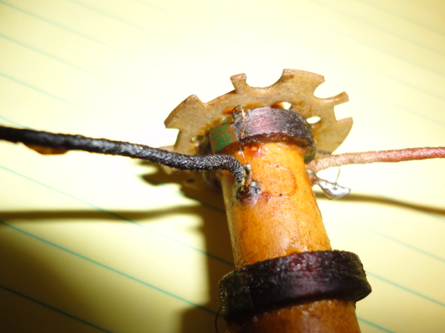

Confirmed- open winding on the 1st IF transformer. I think its the primary, but the wiring attaches to the secondary trimmer?? Anyway, its the winding that connects to B+ . Cant see any breaks when looking over the coil so it must be deeper. Very simple looking coil. Guess Im looking for a replacement or somewhere to have it rewound.
How critical is the accuracy of the winding?
Im thinking that any 1st IF trans from a Model 19 or 89 would work. 260KC with 56 ohms on the primary and 56 ohms on the secondary.
