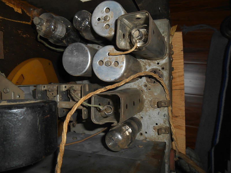

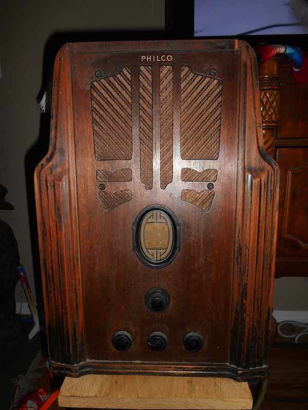

Is this a 624B?
I had put this ePay auction in my watch list, so that I could upload the sale price to RMorg afterwards.
http://www.ebay.com/itm/VINTAGE-PHILCO-R...1208512421
Now I'm sitting here ready to compose the price report, and I can't positively identify the radio! It sure looks like what would be named a 624B, based on the chassis layouts in Ron's book. It's in a tombstone cabinet and it matches the 1936 6-tube layout of the 624. But nothing like that is shown on RMorg, in the gallery here, or in Ron's book.
I can't find any info about a model 624B that matches this radio, except this: http://forums.qrz.com/archive/index.php/t-324424.html. The photo links in that thread still work, so I think I've got the ID right.
Can anyone verify the model for me?
Thanks!
Rodney
Looks like a 623B to me.
I agree! That's what I had assumed originally, too, when I watched the auction. But today, a closer look at the chassis makes me think otherwise.
EDIT - BTW, resistance IS futile, they said so on ST:TNG. Therefore, the only conclusion I could ever reach was that Futile = V/I.
Perhaps its a mixed chassis and cabinet?
Possibly, but it seems pretty factory. Would it have been possible to "custom order" a 624 as a tombstone? Did Philco do things like that?
Or maybe this was an "early" version of the 624B before the rounded-top tombstone released in January 1936. Could it just be so uncommon that it hasn't shown up before? The early-'36 620B, 623B, and 642B all look identical, as do the half-year 623B, 624B, 625B, and 642B... Wouldn't an early-'36 624B have looked just like its three kin?
That's a Ron question... I'm well past my expertise level. Icon_biggrin
Philco did not do custom building/ordering, as far as I know.
Model 624 was introduced mid-season 1936 (December 1935/January 1936). Now, it could very well be that Philco had a few shouldered 620/623 cabinets left over and issued the first few 624Bs in the old cabinet before switching to the new, non-shouldered style. Philco pulled stunts like that many times during the 1930s (not documented yet obvious factory issued Franken-Philcos). I have one such example, a 200X cabinet containing a 201 chassis - and with factory labels inside the cabinet indicating that it is a 201X.
