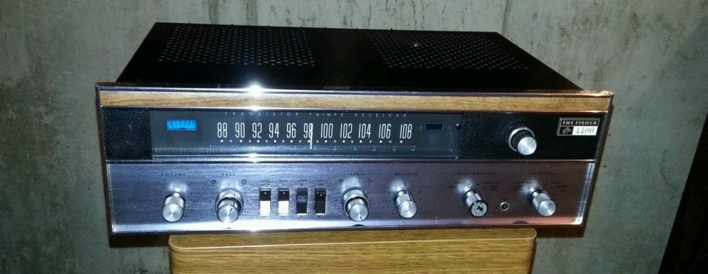

A few weeks ago I picked up this Fisher 4400 receiver:
[Image: http://www.philcoradio.com/images/phorum...r_4400.jpg]
It is a very unusual model - there is basically no info on it available online, not even at AudioKarma.

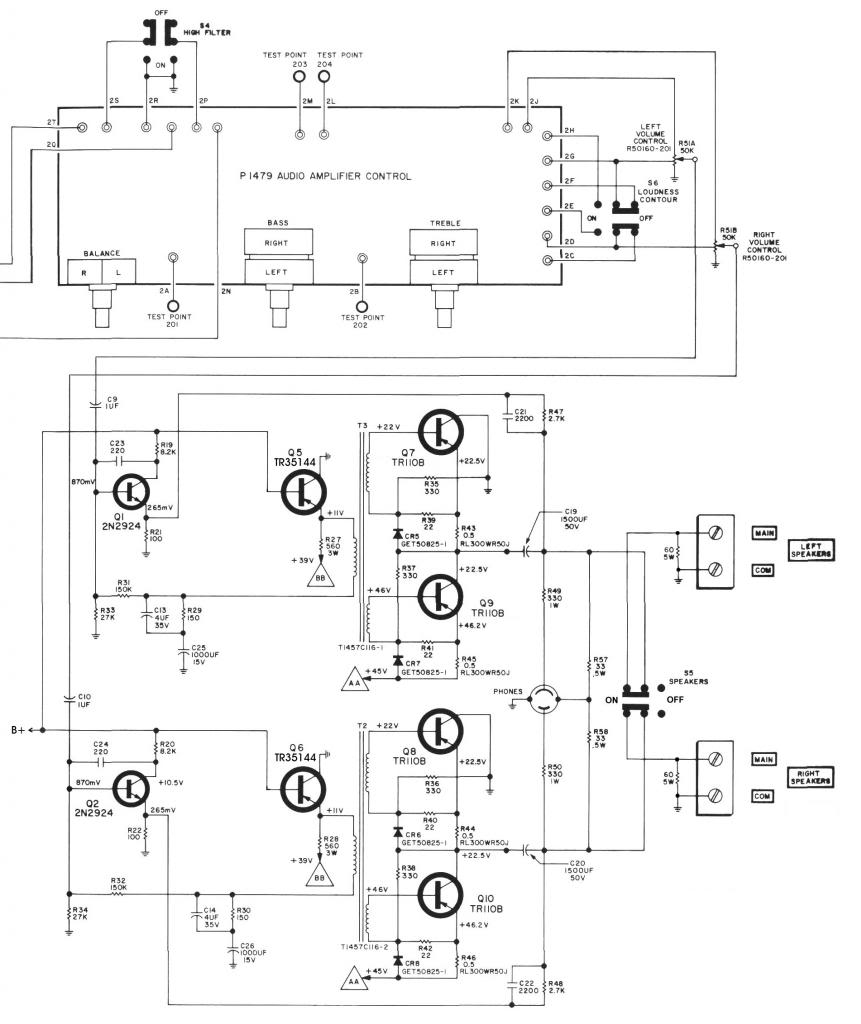

Here is a partial schematic showing the 4400's audio circuitry.
[Image: http://www.philcoradio.com/images/phorum...io_Amp.jpg]
I bought a transistor tester, and it confirmed that the original driver transistor was bad. According to the tester, the replacement GE-76 output transistors are good, as is the replacement GE-3 driver. So now I am looking at something else that is pulling down the 24 volts (shown as 22.5 volts on the partial schematic above). I arrived at the 24 volt figure by taking several voltage measurements in both channels and comparing the results of the working left channel to the non-working right - the left channel has 24 volts where 22.5 is shown at the outputs; the right channel has 19 volts. I have 45 volts where the schematic shows 46/46.2 volts.
I am suspecting capacitor C20 on the schematic (1500 uF, 50V) between the right channel output transistors and the right speaker output as leakage in this capacitor would pull the +24 volts down.
Any thoughts, comments, second guesses, etc.?

Also, those 330 Ohm resistors, the R36/R38.....those gotta be large - they constantly dissipate at ;east 1.5W so they are probably high wattage, like 4-5W types. See if one of them has drifted. There is no DC feedback in this amp (not that I see) and there is nothing else to ensure the 45V voltage divides equally (BTW not sure where they came up with those 46V and 46.2V numbers if the power is 45V with no active conversion) into 22.5V except those resistors (there is the inter-stage transformer concept for you) so you dissipate some extra.
So, it is either the resistors or the cap leaking. The leaking cap is readily eliminated by unplugging the load (BTW make sure your load is 0 Ohm when there is no speakers - like your phone jack is shorted or has something in it...conducting....a dead roach....). And it has to be some leakage too to overpower 75mA of current.
If it is still the case, measure the resistors then.
PS> just an idea - for seeing if a regular good cap makes a difference you could use one of them tube radio caps - just use 20 to 100 uF cap. You will also get sound with the base attenuated.

The diode, if one of them is open, could affect the centerpoint by about 1V. If shorted - by about 0.4V.
The bias point on these old OTL transistor amps is not well controlled, as there is no DC feedback from the output as Morzh previously mentioned. Centering the output stage voltage really depends on the match between the top and bottom sections of the circuit. Sometimes I have seen a variable resistor in place of one of the 330 ohm resistors so the bias point can be accurately set to half the supply.
If the series output 1500 uF cap is dried out, this could also cause low output in the bad channel, although the signal would most likely be distorted when you tried to turn the volume all the way up.
In any case, the low audio problem may not be associated with the output stage voltage. Have you checked that the signal level is identical into each channel's power amp input? The low audio problem may be located further upstream. You can try switching the wires from the volume control slider into each input and see if the low audio is then on the same or opposite channel.

Please refer to the revised image below.
[Image: https://philcoradio.com/images/phorum/Fi...ltages.jpg]
The above revised partial schematic contains actual voltage readings I took tonight in red.
I did not measure any appreciable voltage across the right speaker terminals, with speaker connected or disconnected.
I tried removing C20 from the circuit and using a 100 uF cap in its place. Volume was as low as before.
I carefully unsoldered two joints so that I could properly measure resistors R36 and R38 - they are nearly perfect. I also unsoldered one leg of diodes CR6 and CR8; they test good.
So I am now puzzled as to why the voltages, which are 25.1V at the base of Q7 and 25.3V at the emitter of Q7 and the collector of Q9 are 19.3V at the base of Q8, 19.6V at the emitter of Q8, and 19.7V at the collector of Q10.
Oh, and I also removed the right channel wire which leads to the volume control and bridged it to the left channel - the volume is still much lower in the right channel.
I think this one has me stumped for now. Icon_crazy Icon_wtf Icon_redface Icon_sad
Ron, I don't think the differences in voltages are significant with regard to the low audio issue. One channel is a few volts high, the other a few low, but not really out of the ordinary. This balance issue really does not affect the AC gain of the amp. Otherwise the voltages look reasonable with regard to biasing of the individual transistors.
On thing that will affect the AC gain is the driver feedback bypass cap C26. This cap reduces the AC feedback from the driver stage collector, preventing loss of AC gain while maintaining the DC feedback. If this cap is open, It will reduce the AC gain, which may cause the low volume. You can try bypassing it with the 100 uF cap you have and see if it makes a difference.
Electrolytics are always suspect, so this is where I would look first.
Ron this a shot in the dark but maybe the reason for the voltage differences between the good channel and the weak one might be attributed to the differences between the original transistors and the universal replacement ones as far as their operating characteristics are concerned. Out of curiosity I would check caps C14 and C26. If they were open I would think that would reduce the signal across the primary of T2 thus reducing the drive to the output transistors creating less output to the speaker.

I should mention that this schematic was taken from a Fisher TX-100 amplifier and revised by me to match the audio output circuitry of the 4400, since I do not have a 4400 schematic nor do I know where I might find one. (Credit goes to Larry Derouin of AudioKarma for pointing out the similarity between the TX-100 audio output section and the 4400.) So, the printed voltages are for the TX-100 and I do not know what the factory voltages were for the 4400.

If everything tests OK I think it might be the impalance of rthe Vf between the diodes that are there (I think) to remove the crossover distortion (to open the transistors slightly). Because transistors might conduct differently, the voltage might distribute unevenly.
I do not think this is a problem.
I vote for C14 and C26 as they control AC gain of the driver.
