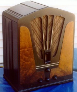

What color toner should I use on this cabinet?
I know dark walnut is too dark and medium brown seems too light (these are Behlen spray can colors that I have on hand).
As you can see, there is flaking in this photo and even more now that I cleaned it with some gojo and steel wool. What is the best way to have a smooth finish when I spray? I am planning on sanding the edges where it flaked smooth and then spraying the toner.
Thanks,
Someone can correct me if im wrong or expand on it, but to get a smooth finish you need a smooth underlay. Make the wood as smooth as you can before you spray and when you spray the finish I think light coats are best as long as you make it "wet" when spraying but dont spray to heavy. Use several light coats to cover. But remember everytime you put another coat on the color will get darker so it's good to start with a light color and as you put coats on, it will get darker to the point you want it. Hope this helps.
I was referring to the dark toned area. That's the problem, where there is flaking, the edges are going to show and the finish will look wavy there unless I do something to prevent it. I am thinking if I spray those areas first to build them up then hand sand to level the surface and spray a final coat that may look best.
I just need the right color.
Spray it with clear laquer then sand to a smooth finish. then spray the color and a couple more coats of clear over that.

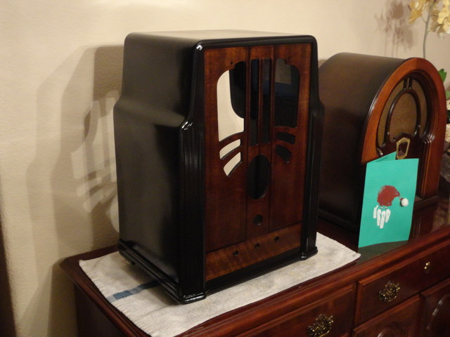

this is multiple coats of Ex DK walnut
I don't think you want the grain on the dark part to show imho; not very pretty grain...just the front walnut panels. I used an ivory "craft" paint for the pin striping.
Art, that is beautiful. Well done!
