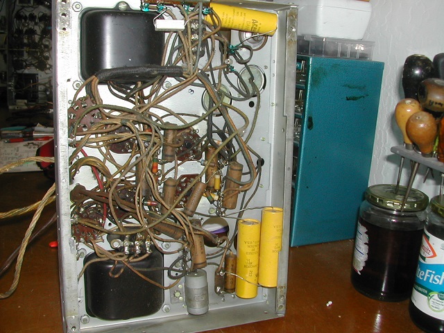

I recently obtained a 38-690. Something must have happened during shipment (it was well packed) because the set is now "non playing" with only a low hum coming from the main speaker. Set was playing before it was shipped I was told.
I'm starting with the power supply and will rebuild that and check it with audio input.
A number of electrolytic caps have been replaced at some point with large 600V units (not checked yet). I have the original Philco parts numbers for the caps that should be there but I can't find a cross reference to the working voltage of the original caps. Would they have been higher than 450V?? Parts numbers are as follows:

The problem is that most of the electrolytics are replacements. The large yellow electrolytics in the photo are 16uF, 600v caps. I don't believe 600V caps are needed but the schematic and parts list do NOT show the voltage of the original caps, only the value. I'm hoping to find out if standard 450V electrolytics would suffice or do any of them need to be higher voltage. This is a high tube count set with two separate power transformers and two 5X4G rectifier tubes (one on each power transformer).

The voltage on the filter caps can exceed 450 V when the set is first turned on and the output tubes have not yet warmed up. The 5X4 rectifiers filaments heat almost immediately so there is full peak voltage on the filters for 30 seconds or so until the remaining tubes begin drawing current.
You can connect your voltmeter to the input filter after the rectifier and see how high the voltage rises at first turn on. I would not use caps rated at less than this maximum peak voltage. Typically, Philco used 475 V or 525 V rated caps for the first filter.

I agree with Mondial on that first cap, go with the best you can get in a 500 V or maybe even a 600. Have you thought about doing a restore and restuff all of the caps? That is a set worthy of the extra effort.

Three of the electrolytic cans are missing. One of the two chokes in the power supply has been replaced with an 8 H choke which does not look like the original. Also, and sadly, seven of the tube shields and bases have been removed from the chassis and metal tubes were used which, presumably, did not require the tube shields. If I can get the set working then I will go about trying to replace the removed tube shield bases.
There are two input caps on this power supply; one for each 5X4tube The rectifier for the amplifier and output tubes seems to have two 8uf input caps in parallel so maybe use a 16uF at 500V?
The second 5X4 rectifier has a single 8uF input cap. There are a lot of electrolytics in this set.
