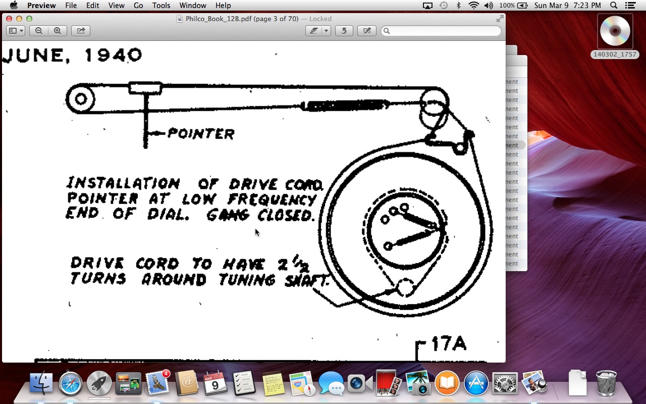

First one is on the dial string. It looks like it should be fairly straight forward, but I want to confirm. On the tuning capacitor is a single pulley with a hook in the groove of the pulley. Do you just put one end of the string around the spring, put the prong on the hook, wind it around the knob shaft once or twice, then connect to the other end of the spring? That is the only way I can see it working, but there was no straining info in the copies of the service notes I got from Chuck.

I tried a couple things with the dial string, and cant seem to get it right. I'm assuming I'm working with the original spring and cord. But I may not be. Hopefully Ron can help out. I know he has a 41-226, which is essentially the same chassis (with the exception of push button tuning). Maybe he can look at his and tell me how it should be strung.

Nick, see if this diagram helps.

Nick, I just acquired a 41-221 and need to string the dial cord. The above diagram Ron posted is nothing like mine. Have you gotten yours stringed and if so could you give me instructions on how. I have a book on stringing diagrams, however this one is not listed. Also is there anything I need to know on restoring this one? How can you tell if the Candohm is bad? Thanks...
