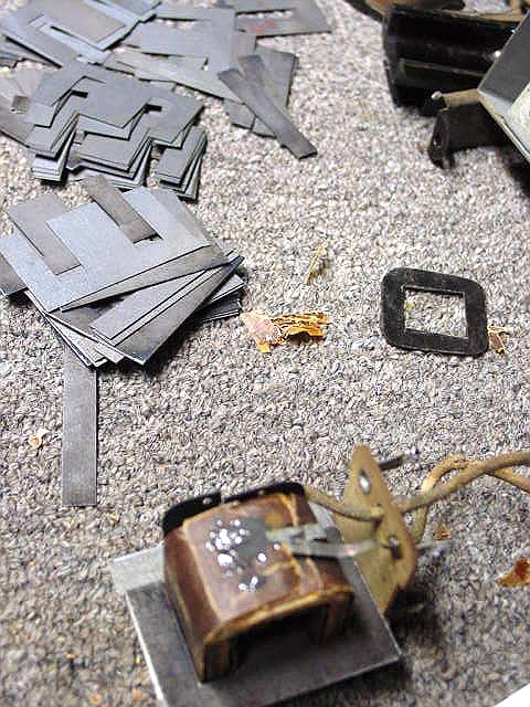

I recently found a very nice Philco 20 De Luxe with the bird's eye maple arch, and just starting the process of doing the chassis.

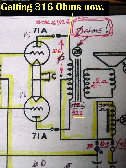

On a preliminary inspection, and familiarization of the circuit, I found the output trans to have one side of the center tap open, The other side had 322 Ohms.
http://www.nostalgiaair.org/PagesByModel...029582.pdf
I decided to disassemble the trans hoping it was a broken wire at the inside terminal. No luck.

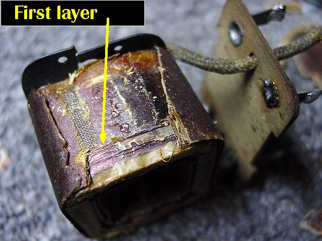

I then prodded around the top layer of windings and still did not find any continuity. I then cut a little of the top layer off, went to the second layer, carefullt scraped about 2 turns of wire, I got a reading of 316 Ohms.
Soldered a thin wire to the winding, then added back the heavier lead to the terminal, added the insulation, and a little JB welld for stability, and reassembled the trans.
My question is, will the difference on 6 ohms make any difference in the operation fo the push pull output? I say no, but want to make sure. I suspect there is enough vairence in other parts to make this 6 ohms not matter at all, except maybe on a scope under test conditions Icon_smile.

That slight impedance "mis-match" will not affect anything.
I notice you said that the top half of the winding was "open", but your note on the schematic says "0" ohms!! Not the same thing obviously!! Zero ohms is a SHORT, not an OPEN which is infinite ohms... Icon_smile
Just be aware that there may be more corrosion spots waiting to fail in there .... Icon_confused

"notice you said that the top half of the winding was "open", but your note on the schematic says "0" ohms!! Not the same thing obviously!! Zero ohms is a SHORT, not an OPEN which is infinite ohms... "
OMG thanks for pointing that "Brain Fade" moment out to me Chuck Icon_smile
The trans itself looked pretty good, and the insulation was not flaking or I didn't see any corrosion spots inside. The 'mess' you see was where I had 'picked' the layers carefully with an Exacto knife.
