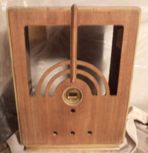

I'm getting ready to apply toner on my 66B. I've seen 4 or 5 different color schemes in different photos. I've seen the front and sides a lighter color and the top a darker brown. I've also seen the front light and sides and top a darker brown.
Any ideas? Here's the before toner photo:
Eric

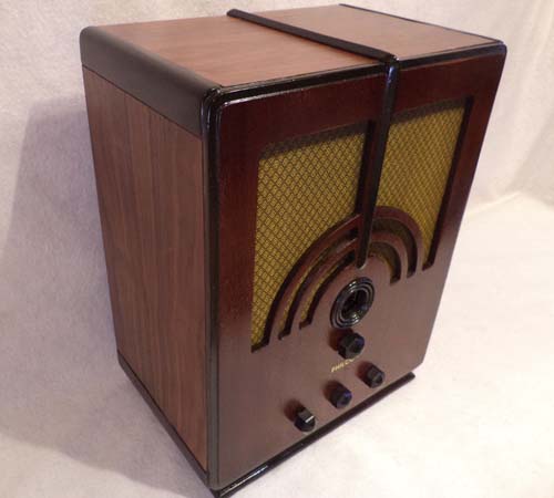

Here is a quick snapshot of my 66B in origional finish. I've got the dark on the sides and top type with the black "spine" and trim. Hopefully someday I'll get around to doing some touch up work on the trim and other various bits that might need it like that weird tiny little stain on the grille cloth.  [Image: https://lh6.googleusercontent.com/-cjBei...143318.jpg]

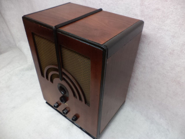

Sorry, I forgot about this thread. Since I wrote this I've done 2 66Bs. I had to replace the side and top veneer on both of them. I used Mohawk Medium Brown Walnut for all surfaces and Vandyke Brown for the trim:

Looks real purdy Eric!
What dd you use for the repaint on the escutcheon?
Posts: 825
Threads: 113
Joined: Aug 2012
City: The Villages
State, Province, Country: Florida
Thanks. For the metal part I used gloss black enamel and Van dyke Brown for the wood that surrounds it.
