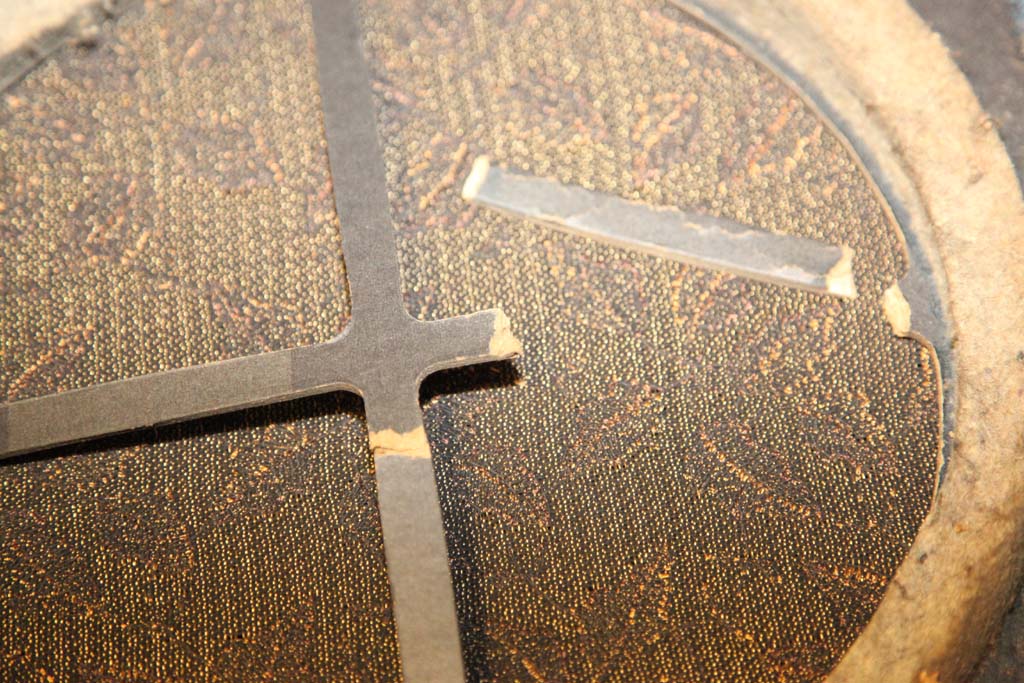

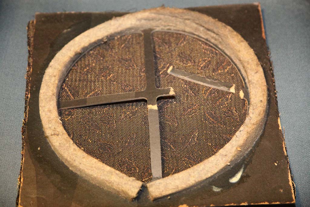

Howdy guys,
I have this.
As you can see, a beam is separated, one is cracked and is about to separate, and the rest has the creases though is not breaking off just yet.
So,
1. Do I even care of those, do they do anything at all?
2. If I do, what do I do to secure the existing ones and to re-attach the fallen-off piece?

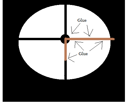

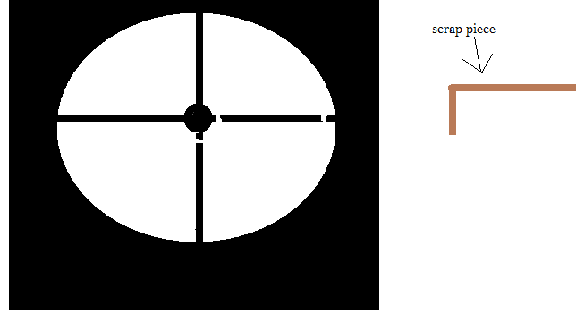

Those cross beams are what give the grill cloth its taught look. They are necessary. Crazy glue is not going to work on fibered thin board that has resistance on it in my opinion. If you were to use a thicker glue like elmers or even wood glue with a cross brace of a piece of scrap backer board that would make it stronger than just glue.
Then glue it all and put it between something flat and weigh it down for a day. Make sure you glue the scrap piece on the inside so it does not mess with the grill cloth. the speaker will cover it so no one will notice.
Thats how I have done it. If you don't have scrap board you could use whatever is around as long as it is thin and strong.

Yes, I think just gluing the joints won't even hold the pressure, I need to overlay pieces over. In fact because I see creases in every joint maybe it is not a bad idea to overlay every single one of them.
I will need a safety sheet of paper between the cloth and the beams so the glue does not seep through.

Wax paper is a good material to keep glue off the grille cloth. Material for backing board replacements or repairs can often be found at a craft store like Michaels in the form of matting material for large prints.
If the existing backing board is stiff and in good shape those cross pieces are probably not needed. There is certainly no harm in repairing them, but there are a lot of consoles with larger speakers that did not use cross braces. Depending on how tight the speaker presses up to the backing board it will also be adding some rigidity. If the cloth looks taut now with the braces creased and broken, you could probably get by w/o them. Just depends on what you want to do, I'd probably repair them just to keep things original.

Yes in fact when I looked at the backing board I was not sure how these beams can add much rigidity to the whole board as it is a square with a circle cut inside and the remainder of material is pretty wide as you can see from the photos.
I thought maybe the beams are there just to support the cloth in the middle a little.
I will try to repair it. I have baking parchment paper, will use it for keeping glue out.

Yes, but then I need to take off the grillcloth off of the existing frame, which might damage it as it is glued.
Considering the cloth is rare, original and in great shape, and the existing frame still is OK even if I do not reinforce it, the risk outweighs the benefit.

Mike, the "elmers" with a thin backing for stiffing is the best way to go. That frame helps the grill cloth from flexing with the air pressure from the speaker.

I have used wooden tongue depressors (popsicle sticks) to reinforce grill backing. I used regular old wood glue. You should be able to buy a bag of the wooden sticks for a couple of bucks. They are easy to trim. Smear some glue on the stick and press it on the cardboard. Just be sure the new wood doesn't interfere with speaker installation.
